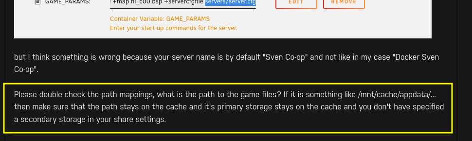

I've been stuck with this for several months now... 😶‍🌫️
I thought it was related to missing Intel dependencies but no.
Currently I'm lost and I don't know how to solve this problem. This blocks me for a lot of things, especially in terms of configuration and much more.
My unraid Processor :   AMD Ryzen 7 5800X
   image.thumb.png.b1152861fd69f6b4adc5c42c3a587853.png  image.png.e7fce66ac1e74a0e6c18227e1ea0ce8c.png
   image2.png.4a6661ddb81e3b904cd1145547485ddf.png    image3.png.e6c1353f3b745d07761b846bf78fe21b.png
7 hours ago, vollekanne said:
Any plans to add
Please read that post:
Something seems to be very wrong on your setup, it should say by default:
No it's not from what I can see from your screenshot here:

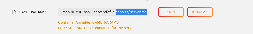

the correct location is as you can see in your docker template:

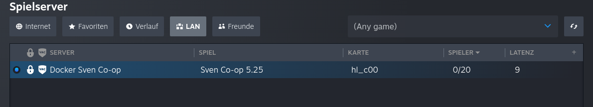

but I think something is wrong because your server name is by default "Sven Co-op" and not like in my case "Docker Sven Co-op".
Please double check the path mappings, what is the path to the game files? If it is something like /mnt/cache/appdata/... then make sure that the path stays on the cache and it's primary storage stays on the cache and you don't have specified a secondary storage in your share settings.

However, I edited the correct server.cfg and I did not modify anything else :/
if I just removed the password and it was done but even leaving everything basic I don't have the server with the default name that you defined ---->
I think you missed what I wrote here:
It is most certainly the case that you have files spread across your Array and Cache, you edit the file from the path /mnt/user/... and the Docker container is looking at the file in /mnt/cache/...
