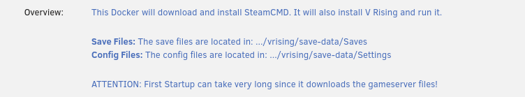

On 7/10/2022 at 1:10 PM, Jupiler said:
Hello, running into some issues when running the V Rising version of the container, I left all the parameters as default, didn't change any configuration, and on first boot, here is the log it produces, it keeps looping after a certain point

Any help/insight appreciated! I have a Valheim version of the same container running flawlessly for months.
I keep having this issue, I'm up to date on everything including Unraid, can't figure it out.

What file or better speaking in which location did you modify ServerHostSettings.json?
Did you read also the description from the container:
(Make also sure to first stop the container, edit the files and afterwards start the container <- editing the config files while the container is running will discard the changes)
