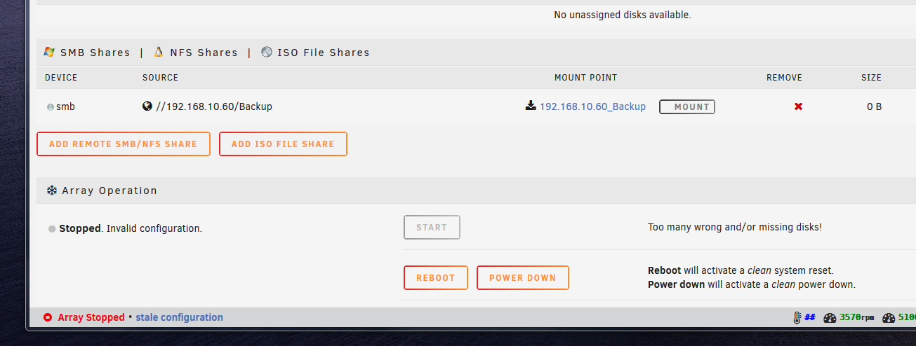

Well crap... went from 6.7.0 to 6.7.2 and got a ARRAY-Stale configuration...
rebooted twice no dice, just turned it off. at work do not have time at the moment.
Seems like its no seeing the lsi card and expander card to see the disks..
Sad day for me
Booted it tonight and it booted just fine, so i don't know
Edited by ijuarez
solved

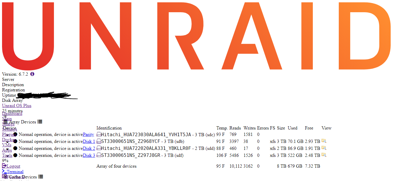

I upgraded to 6.7.1 and the web page is not displaying correctly.  It was just find before the upgrade.  Is there a fix for this?Capture.thumb.PNG.da9db063ed21d39ef2e8b2b6d57ab4d1.PNG
Edited by JeffTerrell
2 minutes ago, Squid said:
But, every single user of CA has had to acknowledge this:
Yep. And I'm betting it's read just as often as any EULA. You can't fix some people.
Screen shot?
What version did you upgrade from?  If there is a dynamix.plg file within /config/plugins on the flash drive, then delete it and reboot.  Also try clearing out your browser's cached files in its history
The only change from 6.7.1 to 6.7.2 that could affect this is kernel patch release from 4.19.55 to 4.19.56, and it doesn't appear like anything in that change log would account for suddenly nvidia driver not working.  A possibility is usb boot flash corruption.
Nothing can be diagnosed unless you post diagnostics (Tools/Diagnostics) captured at the time the issue presents itself.
The Nvidia drivers weren't working as I haven't built it yet.....
Sent from my Mi A1 using Tapatalk
I upgraded from 6.7 to 6.7.1 to 6.7.2.  When I upgraded to 6.7.1 is where the problem began.  I thought 6.7.2 was a fix but it wasn't.
I do not see a dynamix.plg file within /config/plugins.
Try clearing your browser cache.
Cleared the cache and same results
Restart in safe mode
OK this is very strange.  I can't  view it in Chrome, Firefox or IE.  However it displays correctly in Opera and Microsoft Edge.  Oh I am running Windows 10 Pro.
Although the main page looks correct in Opera and Edge, I am missing my plugins and docker apps.
That's expected if running in 'safe mode'.  This is a browser cache issue.  Not sure why clearing your browser cache didn't fix it.
