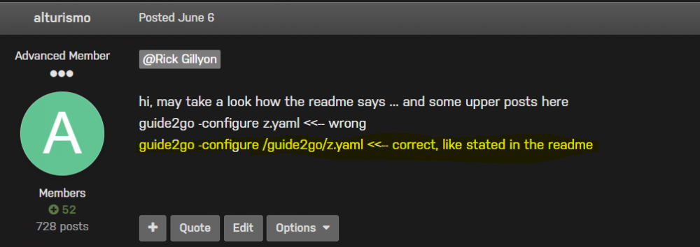

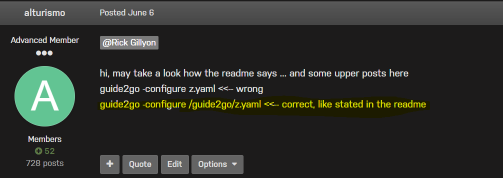

@Rick Gillyon
hi, may take a look how the readme says ... and some upper posts here
guide2go -configure z.yaml <<-- wrong
guide2go -configure /guide2go/z.yaml <<-- correct, like stated in the readme
