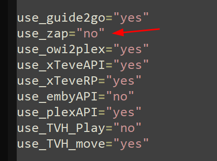

set use_zap to "yes", rest what you dont want, need ... to "no"
your zap credentials ...
now either run it manually, wait for the cronjob to run (default 0.00) or adjust the cron time (check cron.txt in config)

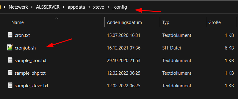

well, there is a small explenation on any setting in the cronjob.sh, may rather ask the question what you dont understand.

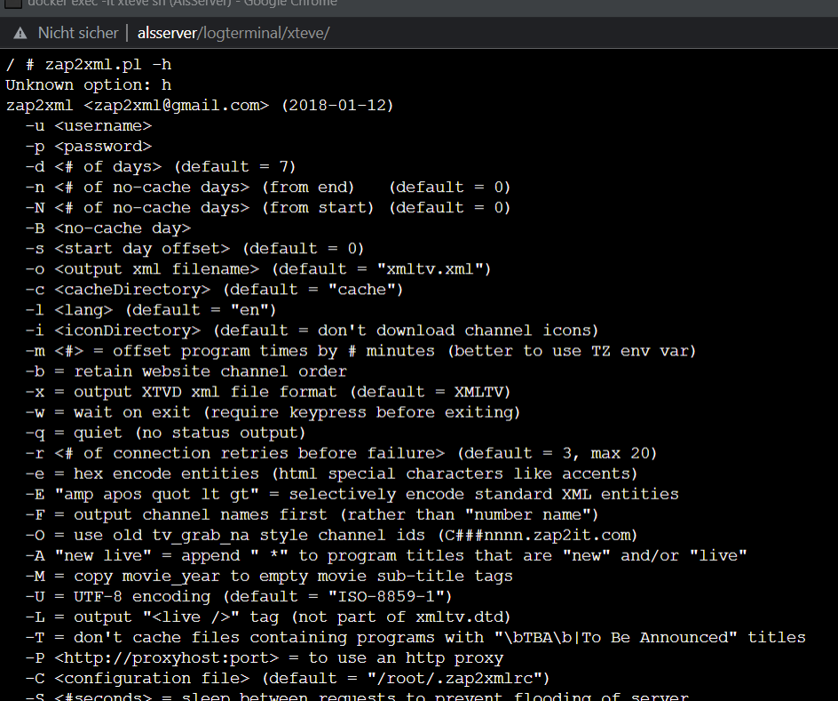

now, to make it easy about zap options in terms you want to know and learn what you doing there
from the docker shell inside
and i keep my workflow completely open, as you see in the buttom from the crojob.sh file you see everything what is happening.
