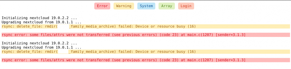

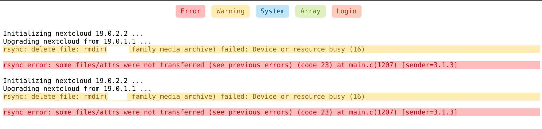

August 28, 20206 yr Hi, I tried to update two nextcloud containers today using the "apply update" button in unraid docker manager. The docker containers deleted hundreds of gigs of data from bind mount hard drives and will no longer start. The persistent container data has been reset to new sample data from the image. This is not the first time this has done this and i have had to restore from backups but each time i loose a small hand full of files. Anyone please tell me why in the h*** this is happening? I have no backups for my instances. so there goes all that work again. Edited August 28, 20206 yr by Be-Art inserting a screen shot of error log
August 28, 20206 yr I resolved the issue in the short term by removing bind mounts to the container and letting it update then adding the bind mounts again. Still does not solve my issue with this in the future and my data loss in the bind mounted drives.
