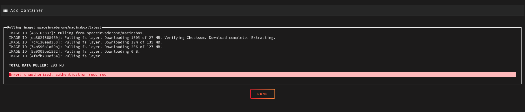

Installed Macinabox docker, chose Big Sur, executed the two user scripts... and now I am stuck at the Recovery.
It boots off the recovery virtual disk, and even if I choose to reinstall Big Sur, the system cannot find the volume for the installation.
Tried to change the third disk from VirtIO to SATA {like in the video shown in the first page of this thread}, but to no avail.
It shows only the Base OS disk, no install disk, no target disk. Even the recovery is not visible, though after a while it defaults to it...
Of course I edited the user script as per instructions.
Before writing this post I have tried to search for an answer on this forum. I guess I used the wrong keywords, cause it is the first time I could not find a solution.
Any clue?
I am quite green, I started with Unraid short time ago, and I still have to learn a few basic details, especially regarding Dockers and VMs management.
