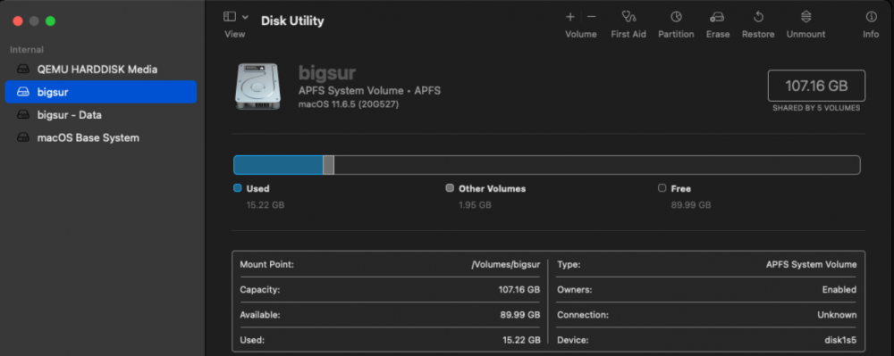

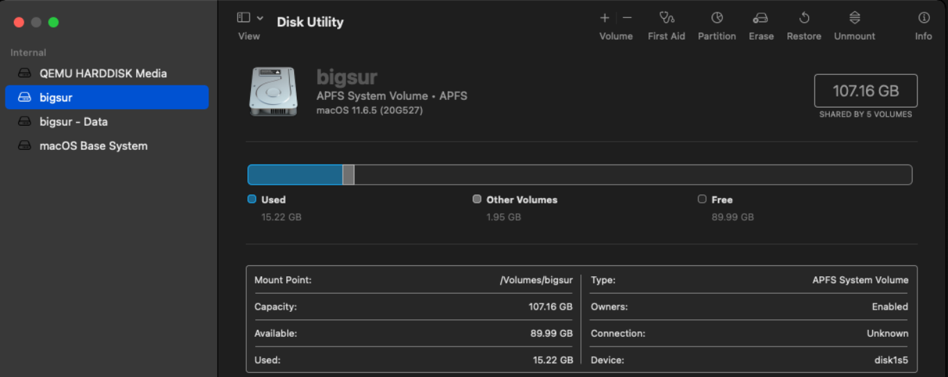

5 hours ago, Hasney said:
After everything is installed and when I login for the first time this warning appears
If you are experiencing crashes or if you are forcing reset this can happen; disk1s5 should be the monterey system disk and probably something is corrupted.
As far as the other things we cannot say anything, try to attach diagnostics, maybe lack of system resources?
I would try to clean macinabox and start from the beginning, without having any docker or other things running to test resources.

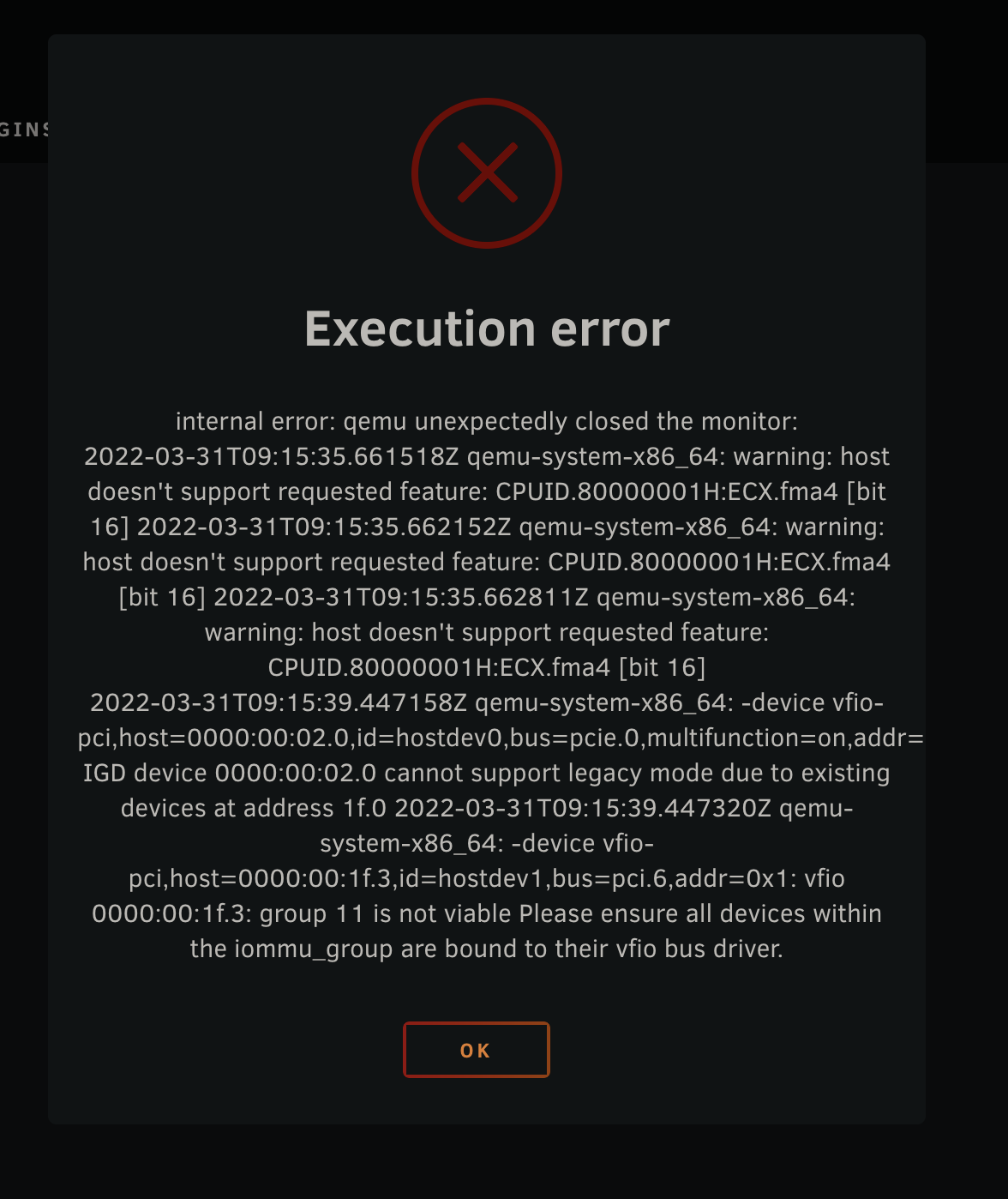

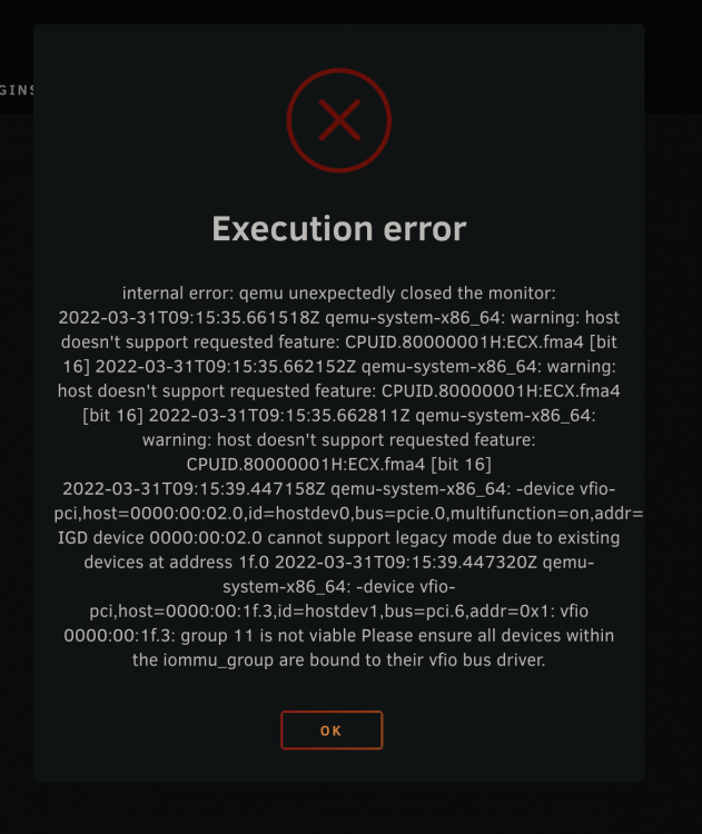

On 3/8/2022 at 4:33 AM, Greenbean said:
hey yall so im trying to pass through my intel uhd 630 graphics to Macinabox Monterey I have followed the latest space invader youtube video. Ive reached a dead end and am getting this error when I try and select my i gpu in the vm edit screen.
VM creation error
XML error: Attempted double use of PCI Address 0000:00:02.0
Hi Greenbean,
Did you manage to get your Macinabox Monterey VM to work with the intel iGPU?
I'm facing issues as well.
I'm seeing the following error message when I try to start the VM while the graphics card is set to Intel UHD Graphics 630 (00:02.0) and the sound card is set to Intel Comet Lake PCH cAVS (00:1f.3).

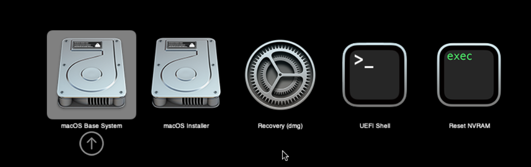

you’ll need to click on macOS installer 2 or 3 times while it loops through the install then you will see Big Sur.
Sorry, i don't exacly understand
Select "macOS installer" like this :

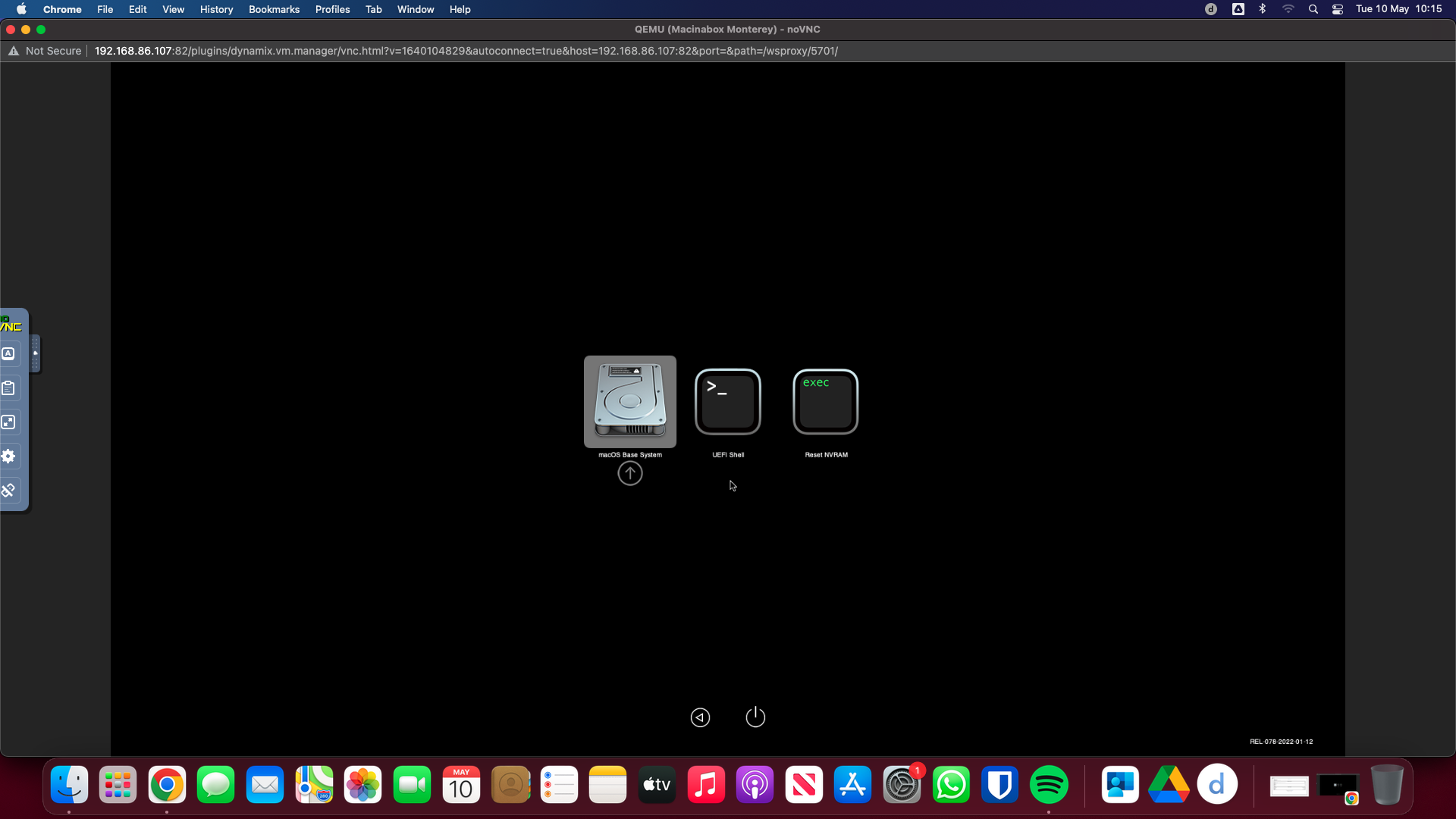

I had been dangling with a lot of issues with my GPU's - almost everything got sorted out. Still Hackintosh fails.
I am able to install Monterey and access it with VNC as primary GPU.
When I am passing through my HD7950 (flashed with UEFI supported rom) - I don't get any output. Troubleshooting with VirtManager VNC viewer shows this.
1345332762_CleanShot2022-04-15at13_52_16.thumb.png.4f55a30f7dd854a301c75498ac11a95d.png

Enabling Logging gives me this before throwing error
1038273765_CleanShot2022-04-15at14_34_37.thumb.png.a1302da95df3c51162b9d583978d66a5.png
I have no clue on how to read that log.
Edit : Learned how to enable debugging in OC
OCC: Missing compatible GOP - Not Found
OCC: Missing GOP on ConOut - Unsupported
OCUI: Failed to initialise output
So it seems like my GPU is not read by the OS for some reason. I had already flashed the GPU (HD7950)  with a compatible UEFI rom and passed the rom via QEMU properly - so unsure why its failing. I would like to know if i can fix it by spoofing or defining the GPU ID via SSDT or the kind ? I have limited knowledge about these but i read something of the kind in whatevergreen github page.
Can someone help me resolve this?

Why doesn't it "autoboot"/why do I have to select the startup disk every time.
And my second question, whats up with my opencore?
Okay, sorry. I had no clue you were running High Sierra.
To answer you (assuming you don't go into rants of swearing )
1) You need to use the Open core configurator corresponding to your EFI version. You downloaded latest open core configurator - you need to go back and figure out which version matches your EFI.
2) Once you figure out your EFI situation, you need to remove your EFI Partition & Installer from your XML config so that it boots from your HDD (in your case 'Hackintosh') and then set time out to something like 1 or 2 seconds via OpenCore Configurator or ProperTree
Misc -> Boot -> Timeout.

Hello.  I have followed the steps a few times, but am getting the following errors in the logs. When I try to open with novnc, I get no connection.  I googled the error and it seems to deal with the processor, but not sure how to fix this.  Any help would be greatly appreciated.

2022-04-22 01:31:51.373+0000: Domain id=18 is tainted: high-privileges
2022-04-22 01:31:51.373+0000: Domain id=18 is tainted: custom-argv
2022-04-22 01:31:51.373+0000: Domain id=18 is tainted: host-cpu
char device redirected to /dev/pts/4 (label charserial0)
2022-04-22T01:31:51.439983Z qemu-system-x86_64: warning: host doesn't support requested feature: CPUID.01H:ECX.pcid [bit 17]
2022-04-22T01:31:51.440015Z qemu-system-x86_64: warning: host doesn't support requested feature: CPUID.80000001H:ECX.fma4 [bit 16]
2022-04-22T01:31:51.441263Z qemu-system-x86_64: warning: host doesn't support requested feature: CPUID.01H:ECX.pcid [bit 17]
2022-04-22T01:31:51.441269Z qemu-system-x86_64: warning: host doesn't support requested feature: CPUID.80000001H:ECX.fma4 [bit 16]
These are not errors, they are warnings that the CPUs you are passing to the VM don't support the functions represented by bit 16 (FMA4) and 17 (PCID). You see each warning twice because you are passing 2 CPUs. They are not the cause of your issues.
Thank you.  I am trying to figure out then what the issue is as I have no connection through novnc

Hey all, I could use some help.
I got to this point in the Macinabox Install Guide (see video), but now my VNC is just showing a black screen. And every now and then it flashes a screen that says Titan on it.  Not sure where I want wrong.
LOG

Hi Team,
I have been able to get BigSur up and running (with GPU passthrough) - was suprisingly easy with the instructions!
When I try and get Monetery installed (using VNC) can't get very far. I get stuck in boot loop and can't even get in to installer. After I select below, get loading with apple logo (for 1-2 seconds) and then it returns to below. Have tried different Machine types (ranging from 4.2 through to Q35 6.0) with no success. Given BigSur worked with no issues, assume it isn't hardware compatibiity issue.  Have tested changing the install Vdisk back to BigSur install img and it gets to install prompts with no issue but as soon as revert to Monterey install img, no luck. Have also tried remove macinabox, all app data and iso/domain folders with no success either.
Has anyone identified any naunces with installing Monterey? Any and all help would be greatly appreciated as driving me crazy not knowing why can't get this version to work :(
Thanks in advance
Edited by Rutj87
Extra info
