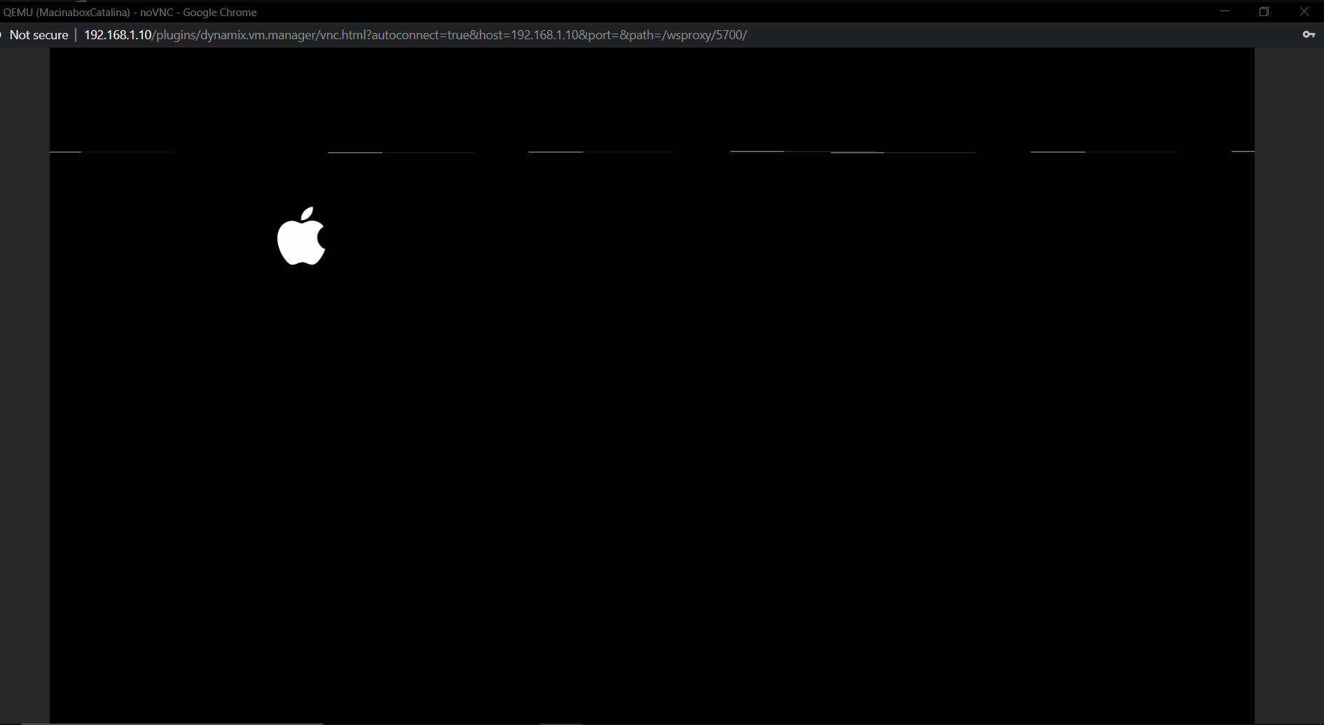

Thanks for the response, here's my XML which works fine with VNC graphics. I make sure to copy/paste both the loader/nvram section and also the qemu section back in after changing to form view to add both the GPU and GPU sound. What exactly should I be changing as the vm template and features section you've mentioned above both seem unrelated to the GPU not working?
<domain type='kvm' xmlns:qemu='http://libvirt.org/schemas/domain/qemu/1.0'>
  <name>MacinaboxCatalina</name>
  <uuid>81504021-5e24-4ab2-99f0-ccfcc3b5abef</uuid>
  <description>MacOS Catalina</description>
  <metadata>
    <vmtemplate xmlns="unraid" name="Windows 10" icon="default.png" os="Catalina"/>
  </metadata>
  <memory unit='KiB'>8388608</memory>
  <currentMemory unit='KiB'>8388608</currentMemory>
  <memoryBacking>
    <nosharepages/>
  </memoryBacking>
  <vcpu placement='static'>4</vcpu>
  <cputune>
    <vcpupin vcpu='0' cpuset='2'/>
    <vcpupin vcpu='1' cpuset='6'/>
    <vcpupin vcpu='2' cpuset='3'/>
    <vcpupin vcpu='3' cpuset='7'/>
    <emulatorpin cpuset='0,4'/>
  </cputune>
  <os>
    <type arch='x86_64' machine='pc-q35-4.1'>hvm</type>
    <loader readonly='yes' type='pflash'>/mnt/user/domains/MacinaboxCatalina/ovmf/OVMF_CODE.fd</loader>
    <nvram>/mnt/user/domains/MacinaboxCatalina/ovmf/OVMF_VARS.fd</nvram>
  </os>
  <features>
    <acpi/>
    <apic/>
  </features>
  <cpu mode='host-passthrough' check='none'>
    <topology sockets='1' cores='2' threads='2'/>
  </cpu>
  <clock offset='utc'>
    <timer name='rtc' tickpolicy='catchup'/>
    <timer name='pit' tickpolicy='delay'/>
  </clock>
  <on_crash>restart</on_crash>
  <devices>
      <driver name='qemu' type='qcow2' cache='writeback'/>
      <source file='/mnt/user/domains/MacinaboxCatalina/Clover.qcow2'/>
      <target dev='hdc' bus='sata'/>
      <boot order='1'/>
      <address type='drive' controller='0' bus='0' target='0' unit='2'/>
    </disk>
      <source file='/mnt/user/domains/MacinaboxCatalina/Catalina-install.img'/>
      <target dev='hdd' bus='sata'/>
      <address type='drive' controller='0' bus='0' target='0' unit='3'/>
    </disk>
      <source file='/mnt/user/domains/MacinaboxCatalina/macos_disk.img'/>
      <target dev='hde' bus='sata'/>
      <address type='drive' controller='0' bus='0' target='0' unit='4'/>
    </disk>
    <controller type='pci' index='0' model='pcie-root'/>
    <controller type='pci' index='1' model='pcie-root-port'>
      <model name='pcie-root-port'/>
      <target chassis='1' port='0x10'/>
      <address type='pci' domain='0x0000' bus='0x00' slot='0x02' function='0x0' multifunction='on'/>
    </controller>
    <controller type='pci' index='2' model='pcie-root-port'>
      <target chassis='2' port='0x11'/>
      <address type='pci' domain='0x0000' bus='0x00' slot='0x02' function='0x1'/>
    </controller>
    <controller type='pci' index='3' model='pcie-root-port'>
      <target chassis='3' port='0x12'/>
      <address type='pci' domain='0x0000' bus='0x00' slot='0x02' function='0x2'/>
    </controller>
    <controller type='pci' index='4' model='pcie-root-port'>
      <target chassis='4' port='0x13'/>
      <address type='pci' domain='0x0000' bus='0x00' slot='0x02' function='0x3'/>
    </controller>
      <address type='pci' domain='0x0000' bus='0x02' slot='0x00' function='0x0'/>
    </controller>
      <address type='pci' domain='0x0000' bus='0x00' slot='0x1f' function='0x2'/>
    </controller>
    </controller>
      <master startport='0'/>
    </controller>
      <master startport='2'/>
    </controller>
      <master startport='4'/>
    </controller>
    <interface type='bridge'>
      <mac address='52:54:00:68:ab:d0'/>
      <source bridge='br0'/>
      <model type='e1000-82545em'/>
      <address type='pci' domain='0x0000' bus='0x01' slot='0x00' function='0x0'/>
    </interface>
    <serial type='pty'>
        <model name='isa-serial'/>
      </target>
    </serial>
    <console type='pty'>
    </console>
    <channel type='unix'>
    </channel>
    </input>
    <graphics type='vnc' port='-1' autoport='yes' websocket='-1' listen='0.0.0.0' keymap='en-gb'>
    </graphics>
    <video>
      <address type='pci' domain='0x0000' bus='0x00' slot='0x01' function='0x0'/>
    </video>
    <memballoon model='virtio'>
      <address type='pci' domain='0x0000' bus='0x03' slot='0x00' function='0x0'/>
    </memballoon>
  </devices>
  <qemu:commandline>
    <qemu:arg value='-usb'/>
    <qemu:arg value='-device'/>
    <qemu:arg value='usb-kbd,bus=usb-bus.0'/>
    <qemu:arg value='-smbios'/>
    <qemu:arg value='type=2'/>
    <qemu:arg value='-cpu'/>
    <qemu:arg value='Penryn,kvm=on,vendor=GenuineIntel,+invtsc,vmware-cpuid-freq=on,+pcid,+ssse3,+sse4.2,+popcnt,+avx,+aes,+xsave,+xsaveopt,check'/>
  </qemu:commandline>
</domain>

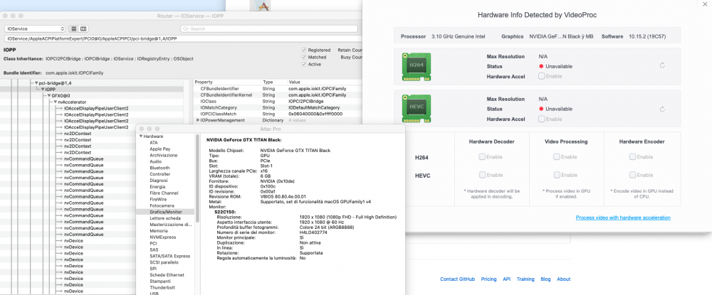

21 hours ago, cobhc said:
Anyone have any luck booting with a 5700xt? I get to about halfway on the Apple logo screen with 10.15.2 and that's it.
Hi, I don't have the 5700xt so I can't test it directly.
From what I read, it seems someone had luck with the 5700xt with opencore+lilu+whatevergreen (latest releases of course).
A bug has been opened on github by the same "someone" who was not able to make the 5700xt to work with clover+lilu+whatevergreen but was able to get it to work with opencore.
So your issue may depend on your clover configuration, or not, it may depend on clover itself.
Remember that as of 1st september 2019 Acidanthera group is not testing its releases with Clover, but only with Opencore bootloader.
So my advice is to switch to opencore and test your 5700xt.
I also suggest to read both the following threads, where you will also find a base qcow2 opencore image to download:
and the latest pages here:
PS: maybe you need at least 10.15.1 for the drivers.
Edited by ghost82

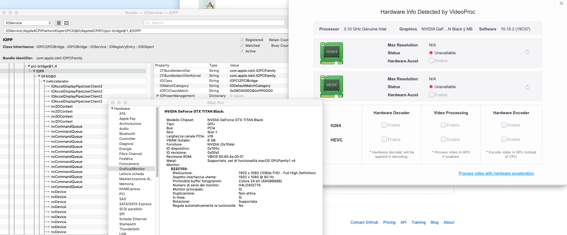

2 hours ago, cobhc said:
I'll need to read up on what to do to move from Clover to OpenCore. I must admit I'm not that experienced in anything to do with OSX.
It's not so different from Clover, both are based on a config.plist file for the settings. As I wrote start with the qcow2 image you can find in the thread I reported, make a backup of your clover qcow2 image, then replace that qcow2 image with that of opencore and try to boot. Finally you can use opencore configurator, an app with a gui to setup your settings, very similar to clover configurator. Start simple, maybe without passthrough, than add your components one at a time.
Edited by ghost82
That worked surprisingly. Though trying the multifunction trick to get HDMI audio to work seems to bork the VM template causing me to have to restore it. I'll keep playing with it.
Edit: HDMI Audio working fine now. Only issue I have is signing into iCloud which throws up an error about my account not being an iCloud account and the fact that the Navi reset bug still isn't working properly with Linux and OSX.
Edited by cobhc

1 hour ago, ledfortr said:
and display got very strange
Hi, Im having a problem, when I first start vm after restarting unraid server and clover boot screen.....I get apple logo but no progress bar.....am I missing something?
Would anyone be able to help me please?
I followed the video to the letter and was all working fine until I changed to 4 CPUs and 8GB RAM.
The VM starts and the splash screen before the OS boots is fine then the OS boots and the screen goes all funny and repeats itself like 5-6 times at top (screenshot attached).
things I have tried..
1. keeping the topology code as only using 4 cpus
2. removing topology code
3. changing e1000 back to virtio.
4. changed vnc graphics to cirrus. Note: although it displayed 3/4 of the screen, its was just line of white noise.
I did it all correctly.. updating the vm template then changing the xml to match but to no avail.

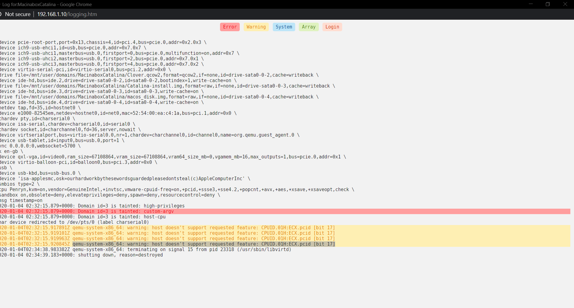

I also got 1 error and 1 warning from the VM log (screenshot attched).
So my xml here is back to just after changing to 4 cpus and 8gb ram and this is where im at...
Not sure if it helps.. my cpu is a Ryzen 1700.
Thanks.
You should read the thread, the issue and its solution have been reported several time!
Tip: start reading page 16.
As far as your other question about "errors", the red line is ok, it means that you are running your vm with custom args, nothing wrong.
About the yellow lines, it means that you are passing a custom arg for the cpu which is not supported by your cpu: more into details the unsupported feature is pcid, so you can remove it from your custom args, from:
To:
<qemu:arg value='Penryn,kvm=on,vendor=GenuineIntel,+invtsc,vmware-cpuid-freq=on,+ssse3,+sse4.2,+popcnt,+avx,+aes,+xsave,+xsaveopt,check'/>
Edited by ghost82
