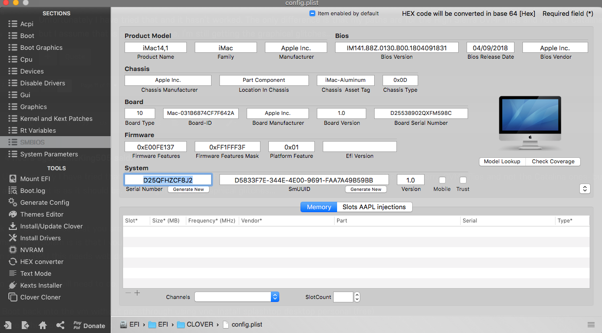

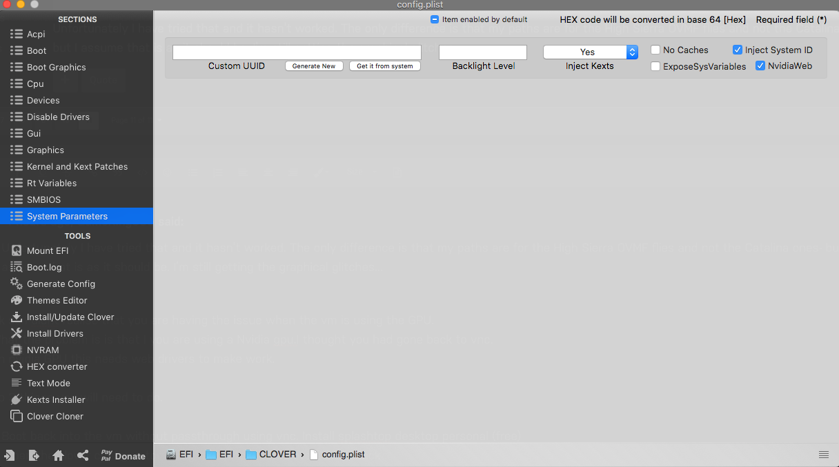

On 11/12/2019 at 11:36 AM, SpaceInvaderOne said:
Ok so I didnt realise that you are having the issue when the vm is using the GPU.
What the problem is is that I you are using a Nvidia gpu.I thought you had gone back to vnc.
An nvidia GPU this needs web drivers to make work.
So 3 things you will need to do.
1. Boot back into the vm without passthrough using vnc. Install splashtop desktop personal streamer (free) https://www.splashtop.com/streamer
on the vm. And the Spalashtop desktop on your computer.
2. Open the clover configurator and goto system parameters and check nvidia web
then on smbios make sure you have product imac 14,1 (see pics)
993133966_ScreenShot2019-11-12at16_27_09.thumb.png.08438dd6b18550df79b1ec128c177251.png
599833274_ScreenShot2019-11-12at16_27_40.thumb.png.0ba81226b8f9ffd91070147a01e1a96e.png
3. Stop then vm. passthrough the graphics card again, then boot. (you will still see the garbled screen)
Use splashtop to connect to the screen. It will be very small screen but don't worry.
Open terminal and run this
bash <(curl -s https://raw.githubusercontent.com/Benjamin-Dobell/nvidia-update/master/nvidia-update.sh)
That will install the webdrivers for the gpu easily.
After that reboot and you should have a workable vm !! ....hopefully 😃
