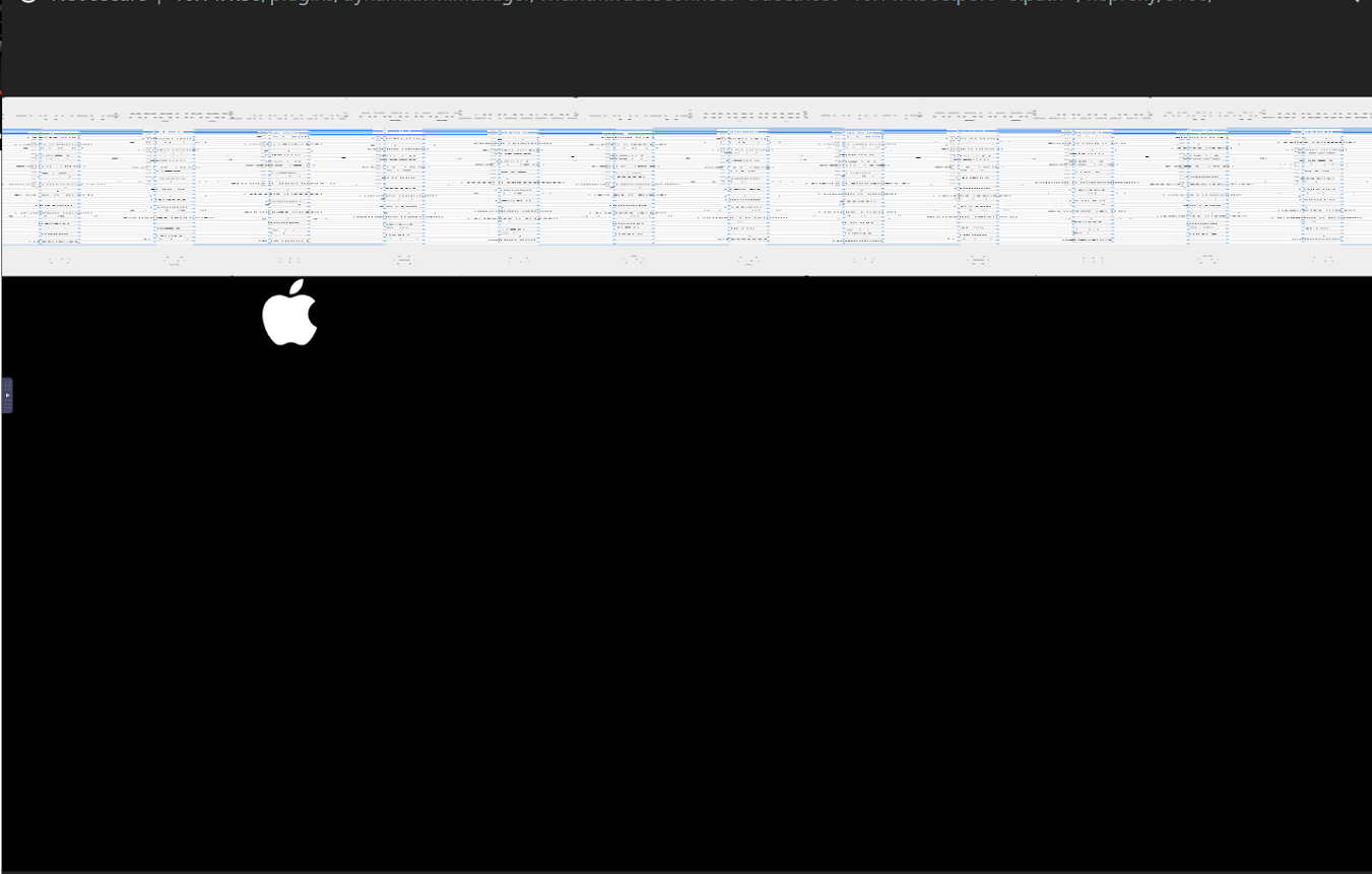

On 10/30/2019 at 3:14 AM, frodr said:
Great docker container and video. Everything worked fine until I changed cpu pinning and memory, then this black screen. Xml mods done.

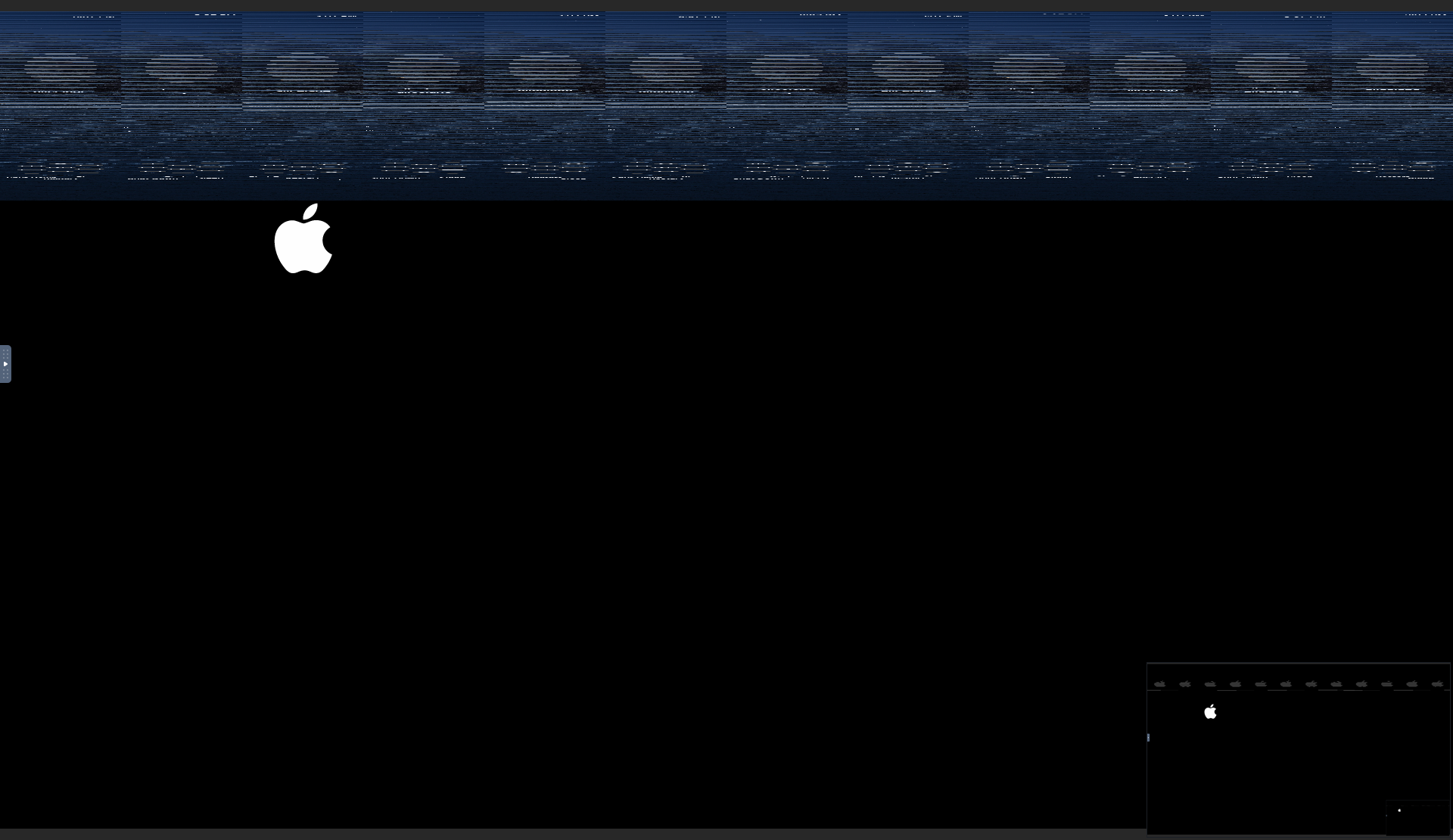

On 10/31/2019 at 12:03 PM, Young_Max said:
When I use default setting(2 cpu ,4096MB ) to install macos catalina,it's fine. But I change cpu number to 4
This post talks about another XML correction. Copying the <os> </os> section of your original xml back in after making edits.
Saved me from the exact same graphical issues you are having when changing cpu threads.

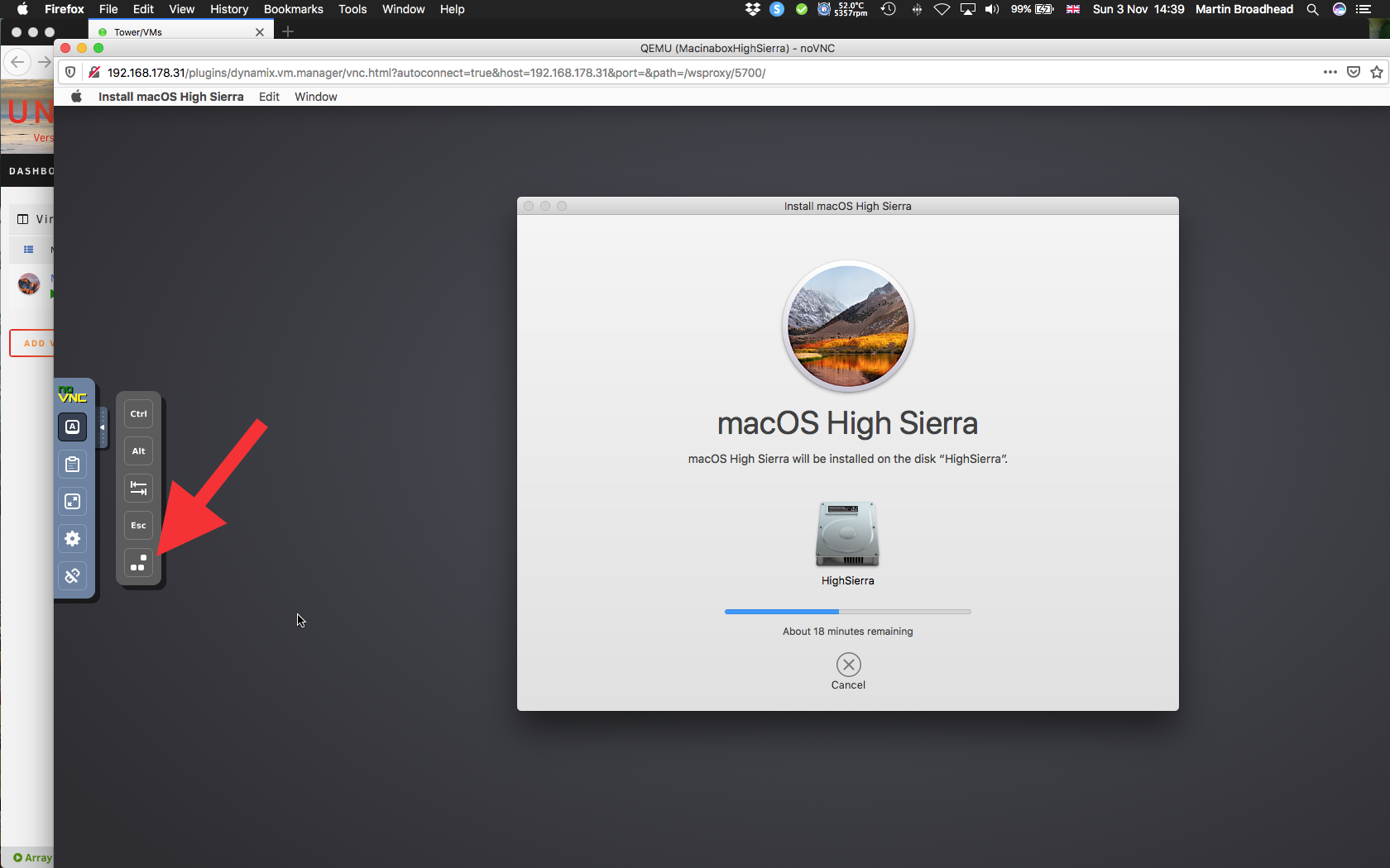

Another question, do things like AirPods, handoff, iMessage, and Apple Pay work via the VM in Catalina? And if so would I need to pass a WI-FI card to the vm?
Edited by ETHREAL1
@samtrois thank you! worked like a charm. I'd scanned through earlier pages but missed that.

Hi I cannot help you about the Catalina issue as I am still new at the whole Unraid / Docker Etc.. However I might be able to help with your mouse not showing up. I was able to sort my issue out by clicking on the VNC tab on the left of you screen.  Then Click on the button A and then the crt.alt.del button and your mouse should appear (see below) hope this helps
 1439349747_ScreenShot2019-11-03at14_39.09(2).thumb.png.0aebd4b004815e6dd93d6aa9695b2591.png
unfortunately - still no mouse - but i'm able to use arrow keys - space bar - f1 - enter etc, just cant get past the initial screen with space invader - just goes black.
Sorry I don’t know what else to suggest as I said I am fairly new to this as well. This worked for me.
Really appreciate trying - thanks!
On 11/6/2019 at 8:16 PM, dexxy said:
Hi all! @SpaceInvaderOne thanks a ton for this container. I've been thinking about getting a hackintosh up and running and your Catalina update tipped me over the edge.
Everything's running just fine as long as I don't touch the CPU pins. I applied the XML corrections, but maybe I've missed something? Screen shots and XML below.

The macinabox template uses  custom ovmf files. If you change
<os>
    <type arch='x86_64' machine='pc-q35-3.1'>hvm</type>
    <nvram>/etc/libvirt/qemu/nvram/e930dfa3-ce5f-4a14-a642-d140ed8035bd_VARS-pure-efi.fd</nvram>
  </os>
to be as below you will be back without the screen corruption.
  <os>
    <loader readonly='yes' type='pflash'>/mnt/user/domains/MacinaboxCatalina/ovmf/OVMF_CODE.fd</loader>
    <nvram>/mnt/user/domains/MacinaboxCatalina/ovmf/OVMF_VARS.fd</nvram>
  </os>
hope that helps 😀

Hi!
I get this problem too but my <os> tag is with the custom ovmf, where is the problem?

36 minutes ago, phyzical said:
Hey all,
on my first install i was able to get GPU passthrough via my GT 620 as a secondary card. but the next day i could not get video signal anymore. So i tried reinstalling the OS a few times infact.. (also tried high sierra and mojave) this had no effect.
I also think i was served with weird boot screen at one point which allowed me to skip the clover boot loader (i think this is the important part as the GT 620 suffers from the reboot bug)
Does anyone know how to adjust the Clover image to allow for me to try and skip the boot loader to rule this out as an issue or any tips for GPU passthrough and these macos images.
i know the 620 shouldn't work with catalina but i swear it was working, persisted vm sleep too. i dont know how i got lucky the first time haha..
thanks!

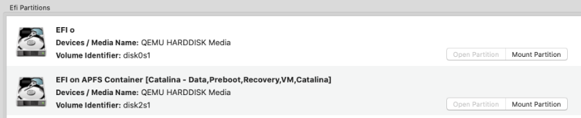

edit:
This vm has two EFI mountable partitions, the top one has the CLOVER directory in it, the bottom one looks similar to the partitions mentioned in every tutorial but only has an APPLE folder. I'm a little lost.
