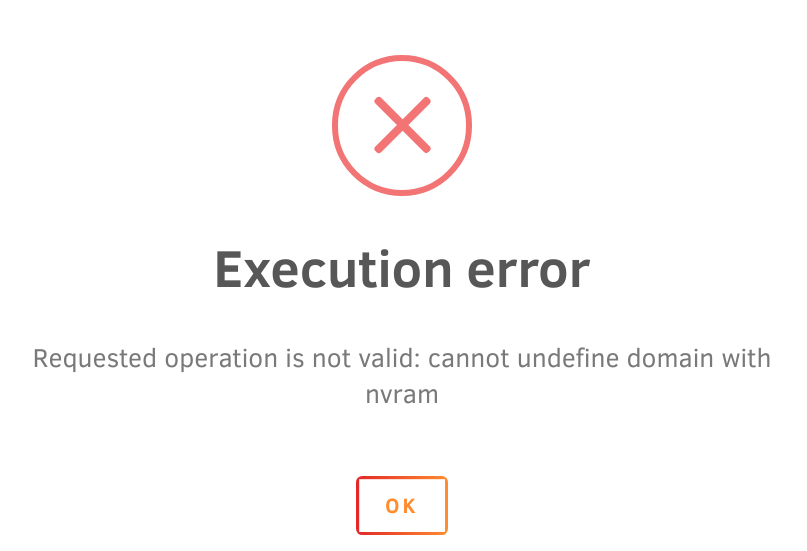

may a question what this error means when i want to remove the vm
as it was a nice test with macos but really doesnt fit here with no rdp solution i d like to remove the vm.
It's covered in the video, near the end. There's an nvram file defined and you have to undefine it before you can remove the VM.
