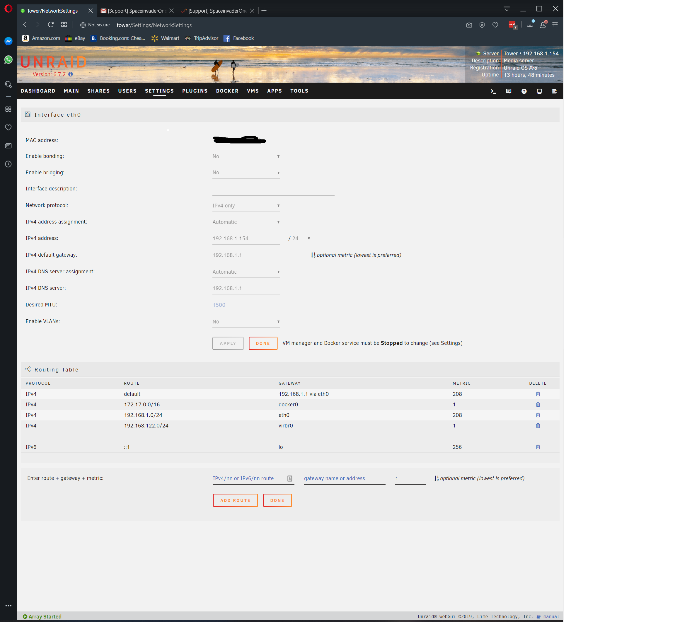

18 hours ago, FrozenGamer said:
I got it all working - works fine with the novnc, but im trying to setup splashtop - I can't see how to connect locally on the network from a windows 10 pc.  streamer installed on the vm and personal installed on the windows 10 machine - says unable to connect "to access a computer that's on a different wireless network you need the anywhere access pack) - the Mac's local IP is 192.168.122.xxx and my local network is 192.168.1.  Any tips on setting this up or a recommended alternative - i connected to the built in vnc with vnc viewer, but one time the keyboard didn't type and then after a reboot it did.
15 hours ago, Jagadguru said:
If you change the line
<source bridge='virbr0'/>
to
<source bridge='br0'/>
The Mac VM should pull an ip address in the range 192.168.1.0/24
This is giving me MTU error
Execution Error  Cannot get interface MTU on 'br0': No such device

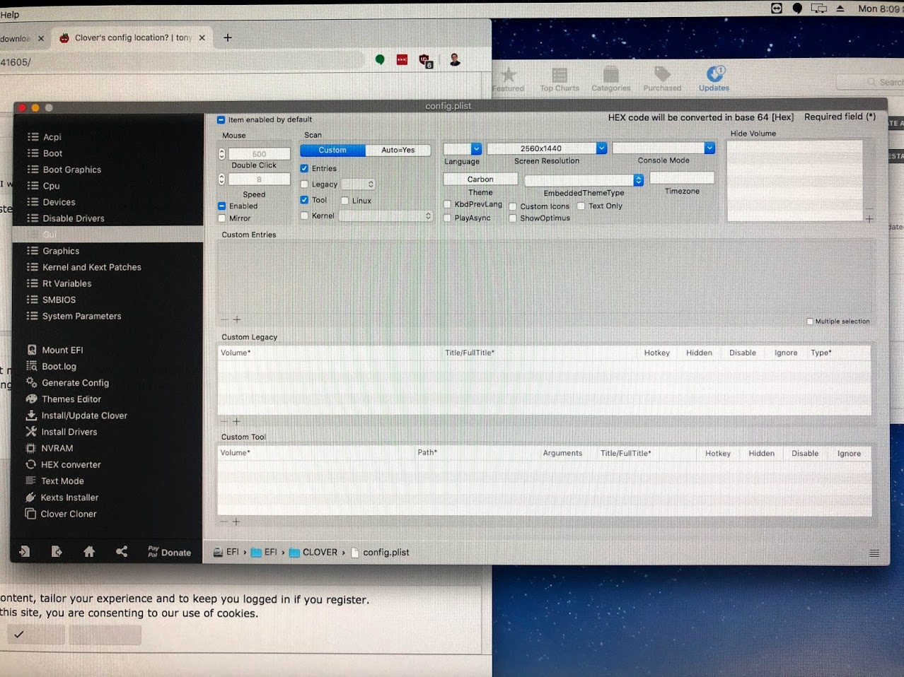

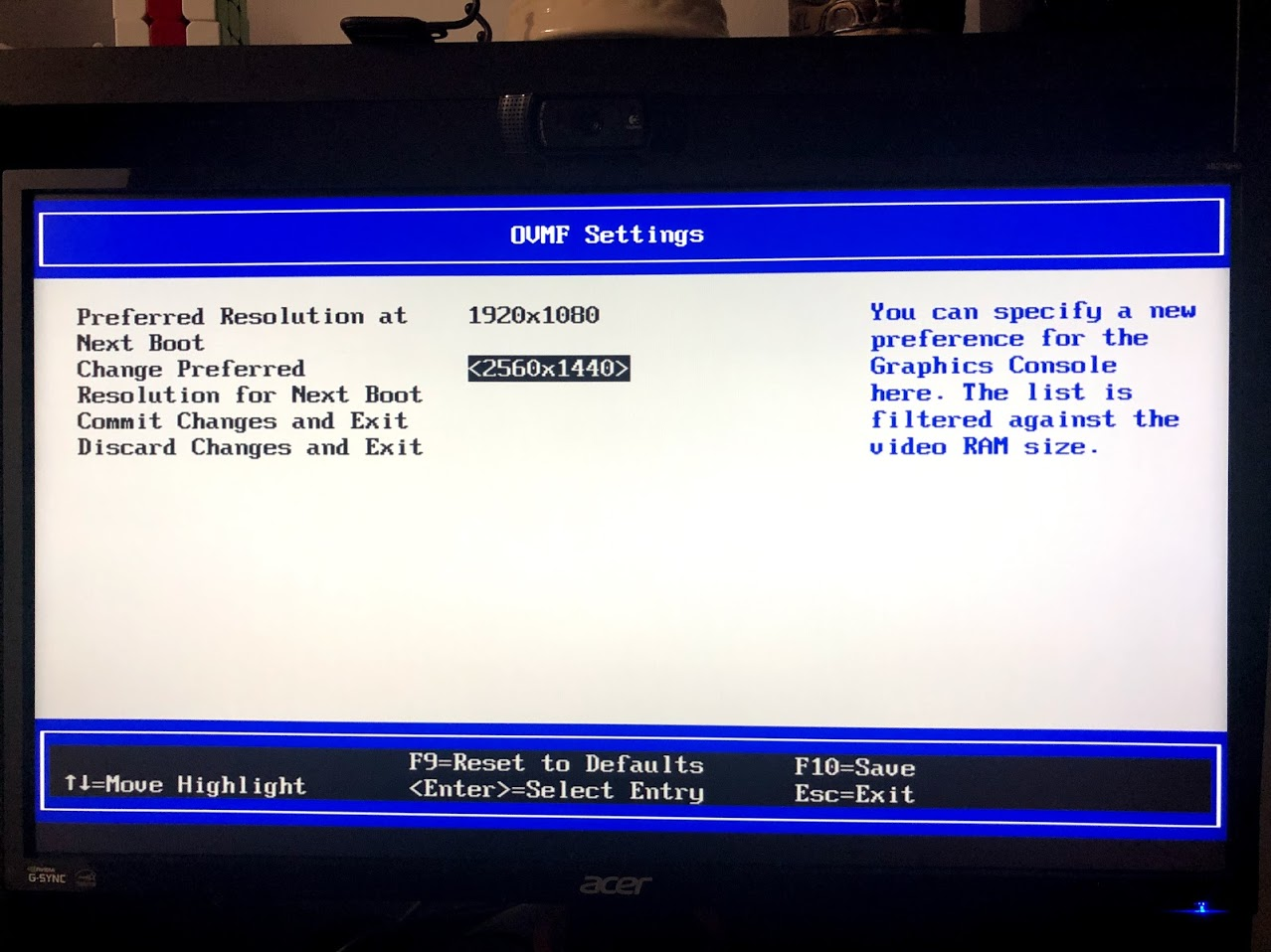

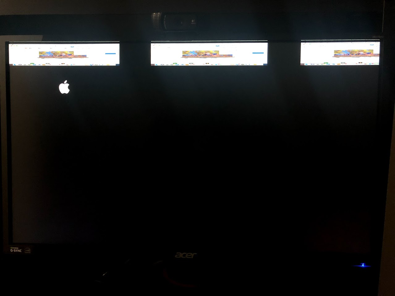

I created a High Sierra VM and I am able to edit the # of cores in the VM Manager UI and then re-add all the changes to the XML, and the VM performs just fine (via VNC).
However as soon as I add my GTX 1080 GPU for pass-through, I get a bizarre repeated and compressed image on the monitor. It's like the screen height is shrunk by 3x, and then the image repeats 3 times from left to right. Any thoughts on why this would be? I've seen others in this thread complain about the same issue, which they claimed was solved by adding the "<os>" section of the XML back in. I've done this but nothing has helped. Open to thoughts.
ALSO: is there any way to modify the boot order in the clover boot menu? It seems to default to the installation rather than booting the actual already-installed OSX. Kind of annoying - I'm sure it's an easy fix but I can't for the life of me find it in the options.
Edited by GameKing505
maybe this xml will help figure out what is wrong.

Check that in Settings > Network,   bridging is enabled and the bridge is named br0 and the bridge includes eth0 at least.
Note the native resolution of your monitor. First boot MacOS and change the clover GUI resolution to the native for your monitor (using clover configurator or whatever way you're comfortable configuring clover. Drop passthrough for now and set up VM to use VNC. Using VNC, press F2 or esc as VM is booting, then when you get the BIOS menu choose (I forget which) and set the resolution to the native for your monitor. Then hit continue. After it boots successfully into the desktop, shut it down.
Then passthrough your graphics card and see if it looks right.
Boot order can be modified in the boot section of clover configurator on your MacOS desktop, after mounting EFI partition (I think "o") with the configurator.
Thanks for the help! I am new to OSX VMs, clover, etc. so some of what you suggested may have gone over my head (my apologies).
What I did -
I mashed escape upon booting the VM to get to the VM BIOS. Then I poked around looking for resolution settings and found this screen:
It seems the "preferred resolution at next boot" is 1080p and I seemingly can't change that option in the bios, but the "change preferred resolution for next boot" is set to the correct 1440p resolution. Is this right?
Next I booted the VM and installed Clover Configurator (which I found via googling). Then I mounted the EFI partition and opened up the config.plist file (is that right?) on there within clover configurator. Then I changed the screen resolution setting to 2560x1440, like so:
After making these changes, I attempted to pass through the GPU but I got the same graphical error I described earlier. I can technically use the mouse and keyboard etc, but it's impossible to see what I'm doing, and the image is repeated 3x:
Any other thoughts?
Any other thoughts?
do you mean these settings -?

4 hours ago, GameKing505 said:
Unfortunately I have tried that and it hasn’t worked. The only difference is that my paths are for the High Sierra OVMF flies and not the Catalina ones- but I assume that is as it should be. I’m still getting the graphical glitches...
Ok so I didnt realise that you are having the issue when the vm is using the GPU.
What the problem is is that I you are using a Nvidia gpu.I thought you had gone back to vnc.
An nvidia GPU this needs web drivers to make work.
So 3 things you will need to do.
1. Boot back into the vm without passthrough using vnc. Install splashtop desktop personal streamer (free) https://www.splashtop.com/streamer
on the vm. And the Spalashtop desktop on your computer.
2. Open the clover configurator and goto system parameters and check nvidia web
then on smbios make sure you have product imac 14,1 (see pics)
993133966_ScreenShot2019-11-12at16_27_09.thumb.png.08438dd6b18550df79b1ec128c177251.png
599833274_ScreenShot2019-11-12at16_27_40.thumb.png.0ba81226b8f9ffd91070147a01e1a96e.png
3. Stop then vm. passthrough the graphics card again, then boot. (you will still see the garbled screen)
Use splashtop to connect to the screen. It will be very small screen but don't worry.
Open terminal and run this
bash <(curl -s https://raw.githubusercontent.com/Benjamin-Dobell/nvidia-update/master/nvidia-update.sh)
That will install the webdrivers for the gpu easily.
After that reboot and you should have a workable vm !! ....hopefully 😃
Yep enable bridging and you will have br0
