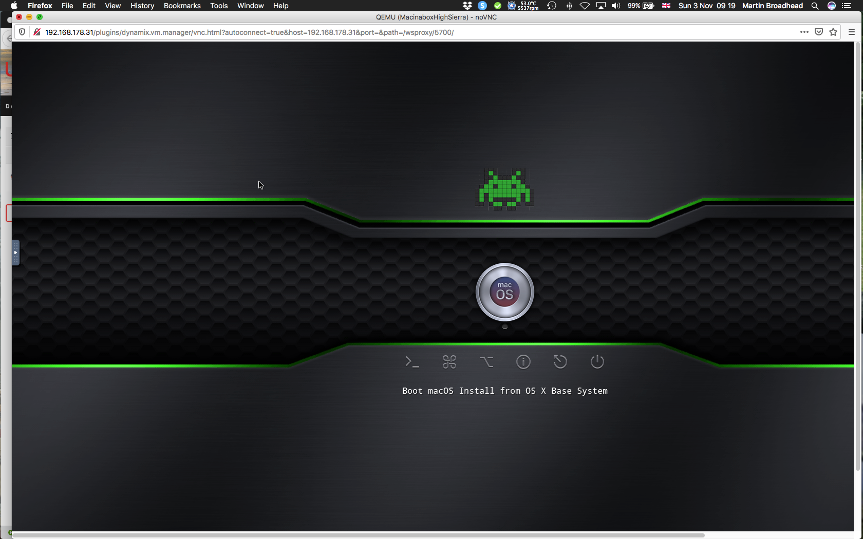

Hi Guys sorry to bother you however i am a bit of a newbie what am i doing wrong? i did the install restarted my server and allI get is this and when I drag the mouse over the vnc screen it disappears so i can not go any further. I have tried to open it with my windows laptop in Chrome and Firefox and also any my Macbook in both Chrome and Firefox the mouse just disappears from the screen.  after reading some of the post's about mouse lag I reinserted the line's about the xml lines to do with the mouse but that still did not work  that you took out of the code from a previous post on this. can any one suggest a solution? MY unraid server is running on a stock DEL Poweredge T320  i have attached screen shots if this helps
It seems nothing wrong, that is the Clover bootloader, no support for the mouse, just press enter on your keyboard to start installing mac os.

Hi Ghost82 thanks for this I will try this when i get back in and let you know.

Hi Sorry i thought i had done it now
Hi Ghost 82 thanks for your help got the High Sierra down loading. Although I had to click on the Crtl/AltDel button on the VNC viewer screen arrowed. The main thing is though its uploading. hopefully I will not run into any more snags.
One quick question after i have installed High Sierra can i then go back to the docker container and apart from changing the OS can i the ngo and down load Mojave OS and have then both available to use if i want?
I'm not using Macinabox, as I prefer to install with the "old method", so I'm not sure if you leave the default settings/paths in the container configuration if the vdisks will be overwritten or if there's some sort of folder structure depending on the chosen installed os, preventing the overwriting, or if the container will warn about that vdisks are already in place and it will not continue.
Looking at the screenshot it seems the container is smart enough to install things on different vdisks, named accordingly to the chosen os?
Maybe the clover image will be the same (but I repeat I'm not sure): this can be the same with no problems for basic booting, but if you need different clover images for different OSes you will need to change the xml of the vms to point to the right (and different) clover images.

Hi Ghost82 thanks for your help High Sierra downloaded and appears to be running really well. first ime i have attempted anything like this and very new to this as a whole so i think i will stick with this as my Macbook Runs on High Sierra so any programs I run will work fine on both systems.
Thanks again from a Newbie for al your help
