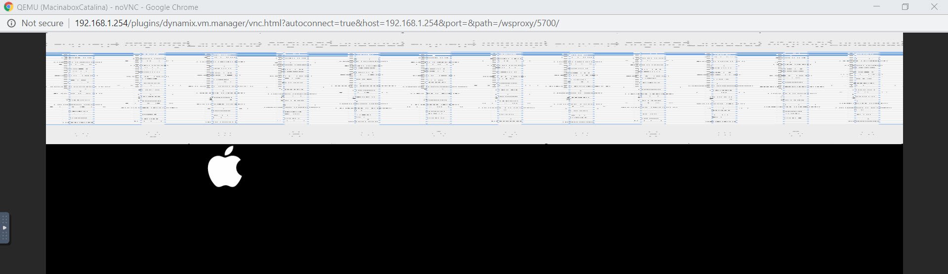

I cannot get any version of Macos to work on my unraid. I have used mostly Macinabox, but tried also with "old" style installing Mojave. Unraid server is Ryzen 3600, Asrock X570 Phantom Gaming 4, 2 nvme drives and 6 hdd:s and 1 sata ssd to cache. No matter are the folders default or in the nvme drive, vnc just spins on empty.
I have deleted all and tryet to install again with no luck.
Anyone have idea what to try next? I have windows 10 working like a charm, so this is macos thing I gues. :)
Unraid version is latest 6.8.1.
Here are my configs and VM log:
log.txt os.xml
Edited by iccb

I ran through this docker and it setup the MAC VM just fine. But when trying to make changes to add some more CPU and memory it just does not load correctly. I made sure to copy the last part of the XML file and then put it back after performing the update, removing the topology line, and removing the virtio with that Intel adapter card. When I try to load it the Apple logo is not centered and there is no progress line. It just sits there. I have snapped a screen shot and copied what I could of the log. It just doesn't run too well with 4gb of memory and 2 cores. Any help would be appreciated. The XML is first and the second is the LOG file.
UPDATE: I edited the post to reflect what the VNC session looks like after I wait a little bit. That is attached.

-blockdev '{"driver":"file","filename":"/mnt/user/domains/MacinaboxCatalina/Catalina-install.img","node-name":"libvirt-2-storage","cache":{"direct":false,"no-flush":false},"auto-read-only":true,"discard":"unmap"}' \
-blockdev '{"node-name":"libvirt-2-format","read-only":false,"cache":{"direct":false,"no-flush":false},"driver":"raw","file":"libvirt-2-storage"}' \
-device ide-hd,bus=ide.3,drive=libvirt-2-format,id=sata0-0-3,write-cache=on \
-blockdev '{"driver":"file","filename":"/mnt/user/domains/MacinaboxCatalina/macos_disk.img","node-name":"libvirt-1-storage","cache":{"direct":false,"no-flush":false},"auto-read-only":true,"discard":"unmap"}' \
-blockdev '{"node-name":"libvirt-1-format","read-only":false,"cache":{"direct":false,"no-flush":false},"driver":"raw","file":"libvirt-1-storage"}' \
-device ide-hd,bus=ide.4,drive=libvirt-1-format,id=sata0-0-4,write-cache=on \
-netdev tap,fd=35,id=hostnet0 \
-device vmxnet3,netdev=hostnet0,id=net0,mac=52:54:00:9c:06:bc,bus=pci.1,addr=0x0 \
-chardev pty,id=charserial0 \
-device isa-serial,chardev=charserial0,id=serial0 \
-chardev socket,id=charchannel0,fd=36,server,nowait \
-device virtserialport,bus=virtio-serial0.0,nr=1,chardev=charchannel0,id=channel0,name=org.qemu.guest_agent.0 \
-device usb-tablet,id=input0,bus=usb.0,port=1 \
-vnc 0.0.0.0:0,websocket=5700 \
-k en-us \
-device qxl-vga,id=video0,ram_size=67108864,vram_size=67108864,vram64_size_mb=0,vgamem_mb=16,max_outputs=1,bus=pcie.0,addr=0x1 \
-device virtio-balloon-pci,id=balloon0,bus=pci.3,addr=0x0 \
-usb \
-device usb-kbd,bus=usb-bus.0 \
-device '************************' \
-smbios type=2 \
-cpu Penryn,kvm=on,vendor=GenuineIntel,+invtsc,vmware-cpuid-freq=on,+pcid,+ssse3,+sse4.2,+popcnt,+avx,+aes,+xsave,+xsaveopt,check \
-sandbox on,obsolete=deny,elevateprivileges=deny,spawn=deny,resourcecontrol=deny \
-msg timestamp=on
2020-01-27 21:12:19.745+0000: Domain id=9 is tainted: high-privileges
2020-01-27 21:12:19.745+0000: Domain id=9 is tainted: custom-argv
2020-01-27 21:12:19.745+0000: Domain id=9 is tainted: host-cpu
char device redirected to /dev/pts/0 (label charserial0)
Edited by opentoe
Found out what the problem was. Whenever I would edit the VM and hit update it would just mess something up somewhere. So I took the original copy and pasted it into Notebook+ and used that as my good source XML. Then made the changes I wanted. Then I went back into the XML and copied just those changes to my source XML and updated it. Worked great.
