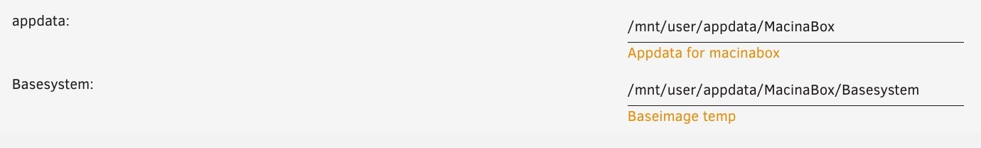

How to add a 2nd and 3rd MacOS kvm without destroy the first?
Change the folders used for appdata and Basesystem to something other than the default locations. I had a working Catalina VM alongside a High Sierra VM on my older system still listed in my signature. As mentioned in my post above, I just transplanted my entire unRAID setup to a used Supermicro CSE-847 system. Alas the dual Xeon x5650 CPUs don't support AVX2 so I can no longer use the Catalina VM.
