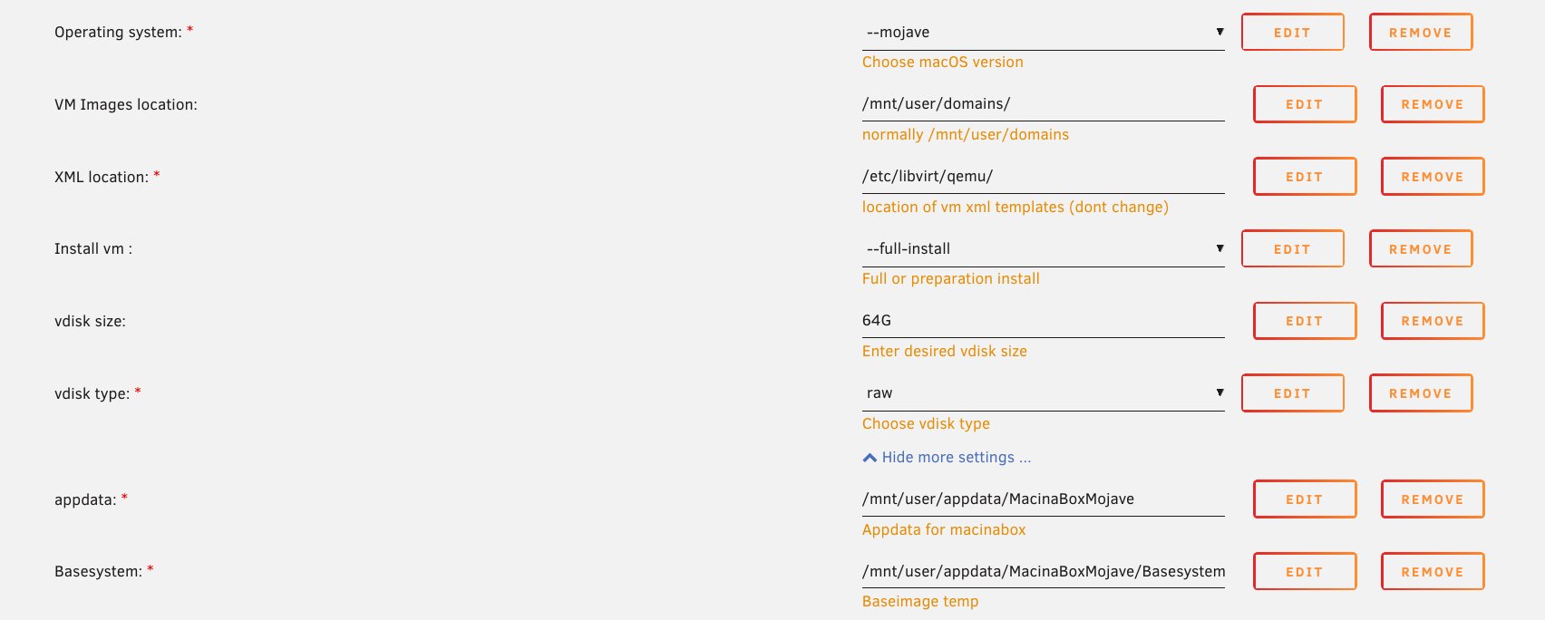

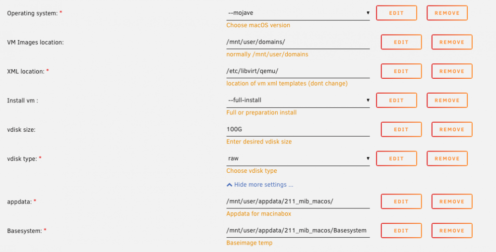

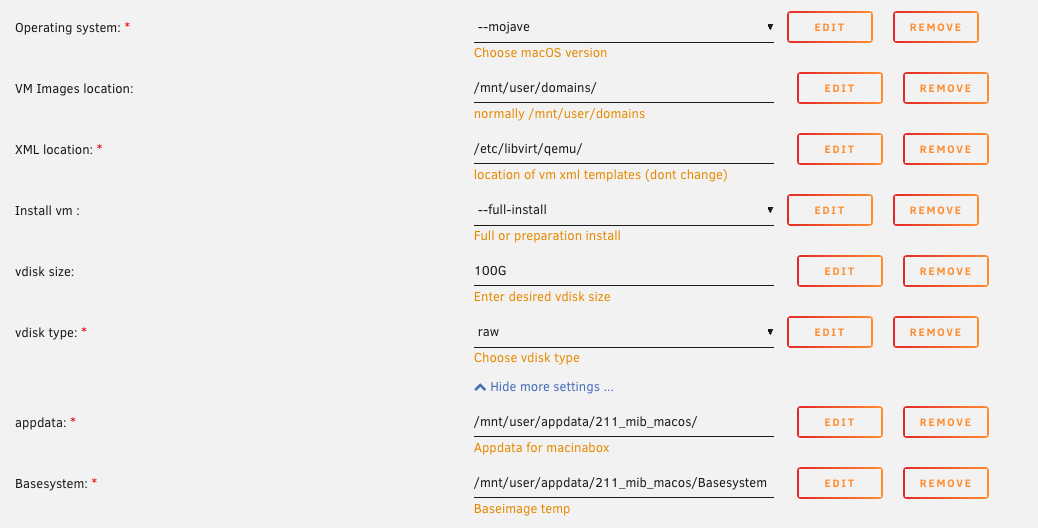

On 4/16/2020 at 7:30 PM, frodr said:
Is there a way to install another MacOS vm?
I tried this several times with changed appdata and basesystem folders on the second MacOS vm. It seems that it is not made a new vdisk for the second vm, but refers to the first vm vdisk.
What is the correct way for a second vm?
Happy for any help.
/frode
Anyone, please.
1 hour ago, frodr said:
Anyone, please.
I've used the MacinaBox docker container to create multiple MacOS VMs and currently have it working for High Sierra, Mojave and Catalina. The only changes made were to the paths required by the docker container and of course selecting the correct OS version. I used the full install method for all 3. Here's a screenshot of my Mojave setup (last one I created). All it required was the 3 changes.
Edited by AgentXXL
spelling

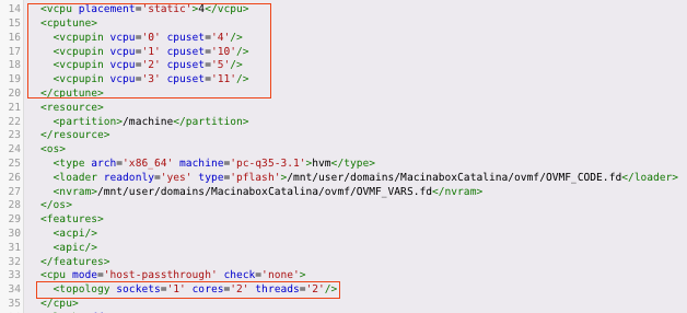

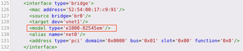

Alright I kept having problems after trying to change the XML once I had already installed.
So I removed everything and started again, this process (edit XML before install) worked for me:
  • Install via Docker
  • Restart Array, then go to VM
  • Before starting the VM, select edit, switch form view and copy out all of the XML to another text editor
  • Modify XML in the text editor with the desired CPU info, and changed the model type for the interface to e1000-82545em
580953833_ScreenShot2020-04-21at10_09_33am.png.11859e552900bba0efa117685b318292.png  41348684_ScreenShot2020-04-21at10_10_23am.png.505cc2ae333b6f4d150077022dd522dc.png
  • Copy XML back into UnRaid and Update
  • Boot the VM
It installed and is now running without issues, and I haven't had to change any XML after the fact.
Adding a second MacOS vm different from what`s already setup works fine. But if already running a MacOS vm, and a second vm in the same version, that`s not working for me. The log file on the second vm clearly refering to the first vm, and not making a new app folder. Also tried with "pre-making" the app folder specified in the xml-file.
Anybody out there that successfully added a second MacOS vm in the same version as the first vm?
Cheers,
1195949629_Screenshot2020-04-22at19_45_05.thumb.png.7b34206a7ae6745135c3bc14b87d8331.png
Second MAcOS-vm logfile:
Summary of what has been done
The reference /image below refers to where you mapped that folder in the docker template on your server
(normally to /mnt/user/doamins)
Install media was already present

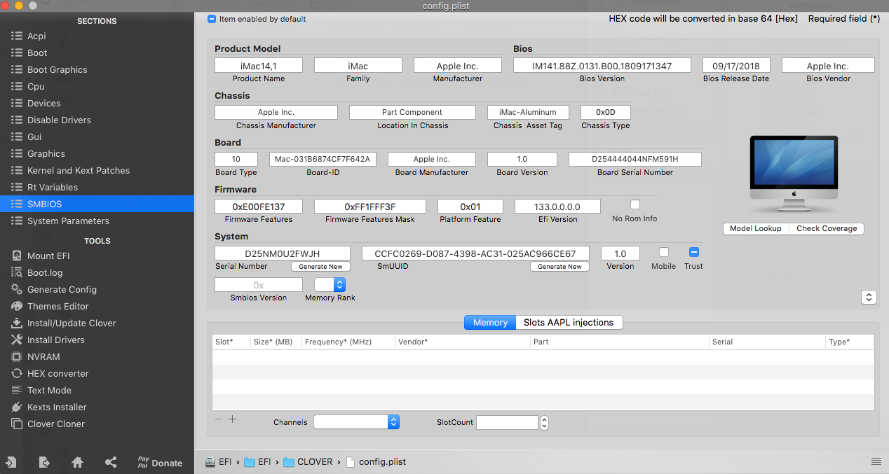

Hi. Well before i answer this question re the hdmi out I just want to point out that sadly Nvidia cards dont work in macOS Mojave or Catalina. You should still get a picture but no acceleration. There are no drivers since Apple no longer allow them to release them. So High Sierra would be the best OS for you to use with a gtx 970.
However this isnt why you are getting no output from the hdmi.
I would check in your clover configuration that you have under SMBIOS that product model is imac14,1. Some system definitions you will get a black screen otherwise.
Also sometimes the gpu outputs out of the 'wrong' port. You may have to try the dvi/display port out (you can use an adapter to convert it to hdmi)
hope this helps
Cheers,
Vdisk was already present
Uptodate clover image was put in /image/MacinaboxMojave
Compatible OVMF files vere put in /image/MacinaboxMojave/ovmf
An XML file was already present for MacinaboxMojave you will need to manually delete if you want me to replace this
OK process has finished at Wed Apr 22 04:28:57 Europe 2020
Based on what you've experienced and what's showing from the logs, it looks like you left the appdata and Basesystem paths pointing to the same folder named MacinaboxMojave.... one can be named that, but the second instance should be named something else like MacinaboxMojave2. EDIT: Sorry, thought the image in your reply was the one I posted - and your image shows that you definitely changed the path to something else: 211_mib_macos. But my findings were the same.
Assuming you have left the defaults as they stand, there should be a unique folder for each VM under /mnt/user/domains. The fact that it says the  install media and vdisk are present means it's definitely still pointed at the same paths as your other Mojave VM. So to verify I just tried changing the paths in my Macinabox Docker container to MacinaboxMojave2 and sure enough I got the same log response you did.
There's definitely an issue in the Docker container as it ignored the new paths and just referred to the existing MacinaboxMojave vdisk and install media. I note that the log says the files were put in the /image/MacinaboxMojave/* folder yet in the Docker, there doesn't seem to be a path or mountpoint called /image. I suspect part of the script that runs when the Macinabox Docker container is started is hard-coded to the /image path.
I haven't had a look at the Docker container or any of it's components yet, but I suspect it's a simple pathing issue that @SpaceInvaderOne will have to fix.
Edited by AgentXXL
Thanks for testing, and finding the same result as I did. It would be nice to have a confirmation from @SpaceInvaderOne, and maybe a fix.
Edited by frodr
