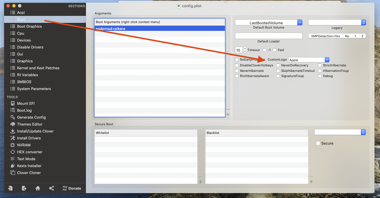

43 minutes ago, methanoid said:
Would love that setting that tidies up the screen immediately after Clover starts loading MacOS...
This is what I set up, but honestly, I reboot my MacOS VMs so infrequently, I forget how much this covers up!
Also, I neglected to mention I run an RX570, and it sounds like that works OK for you, so I might not be able to help much with the RX5700.

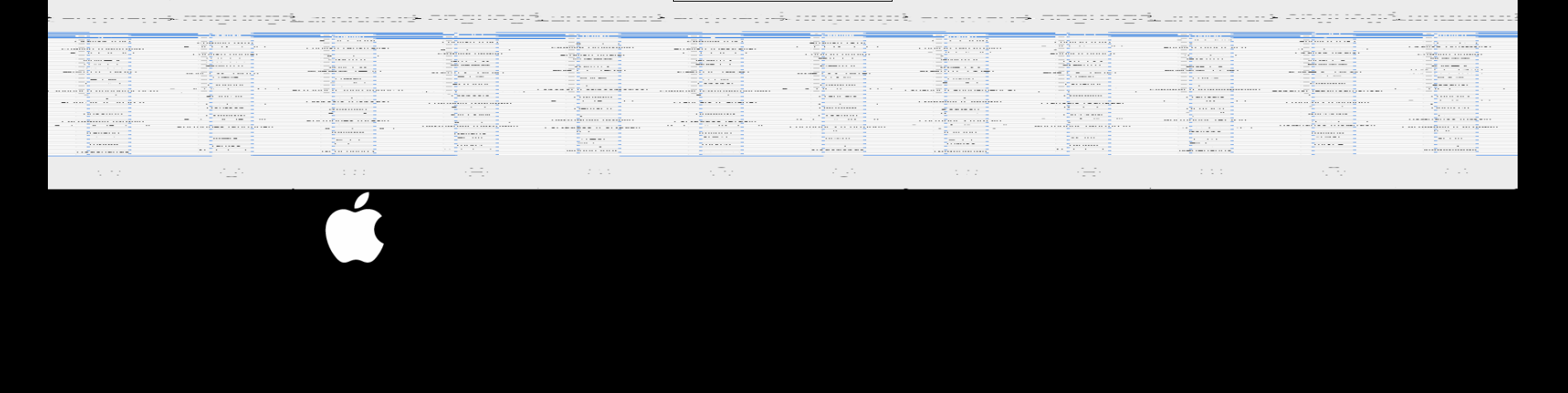

Hello all,
I'm having an issue with a Catalina VM where the image is repeated.
This is what it looks like.
On first boot it booted fine. I installed MacOS, I then shut it down, gave it more cores, more ram, changed the nic in the xml file, and of course changed the icon back.
Here is my xml file:
<domain type='kvm'>

After editing the xml file I go to boot the system and it gives me that screen. Any ideas on how to fix it? Thanks.
2 hours ago, Masterism said:
I'm not seeing the answer. What am I missing?
Very first line of the post I linked.
With a macOS vm it has custom things in the xml. If you look at the end of the first xml you posted and the second you will see. Because of this any changes that you need to do to the template cant be done in the Unraid template manager as it removes custom edits at present.
However annoyed I got with your answer, it got me to compare the original xml of my vm with my edited one and I found the differences.
Thank you.
