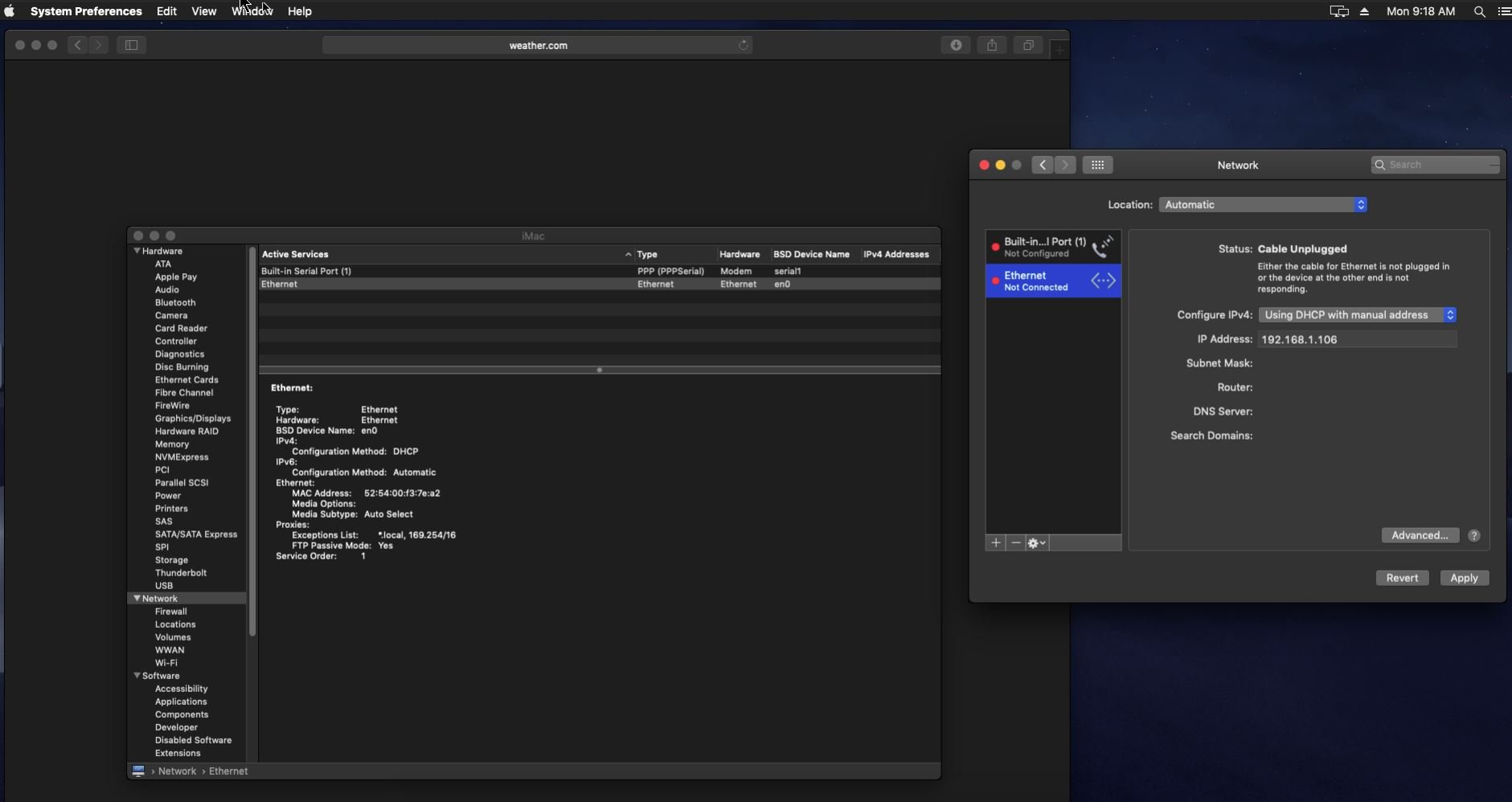

Hello Guys,
i have a graphical problem with the vm.
If i install the VM it works fine i can change the networkadapter type in the XML file without problems.

I've tried all tutorials and every thing I can find on this topic and nothing will work.  For most it seem just swap NIC to e1000-82545em works. I only have network access with the vmxnet3
I've read through all 29 pages here and other forum posts about icloud/imessage/appstore
Edited by in_trauma
13 minutes ago, in_trauma said:
This disables network on mine.
You are not the first reporting this..still I don't get how it is possible that for somebody is working and for somebody else it's not working...different qemu version? different unraid version? different mac os? different xml?
Edited by ghost82
Just now, ghost82 said:
You are not the first reporting this..still I don't get how is it possible that for somebody is working and for somebody else it's not working...different qemu version? different unraid version? different mac os? different xml?
  • unraid 6.8.2
  • Mojave install 10.14.6
  • Don't know how/where to check qemu
I installed the macinabox docker yesterday. Should be the most up to date for everything.
I have network access with vmxnet3. Set static IP with my router and manually configure DHCP and still says ethernet not connect/unplugged.
XML mods, all I've done is change the network setting.
My Current xml:
Does it work if you disable and enable again that ethernet in the mac os prefpane?
If this works try to increase the slot value, for example from slot='0x00' to slot='0x08'
Well I don't know what happened I restarted a couple more times but now it works and i've signed into imessage successfully I think the restart with auto DHCP might have been the ticket.🤷‍♂️
If you mean "make inactive" and reactivate the connection the Network panel of my screenshot, then yes I've tried this and nothing happens. Tried auto and manual DHCP. I've remove the ethernet connection and made a new one.
In Terminal when I listall hardwareports I have the following
Hardware Port: Ethernet
Device : en0
Ethernet Address : (my MAC address)
Changing slot value: I assume you mean in the xml?
Yes, sometimes there can be the issue of virtual network down after booting mac os, which seems solved if you use a higher slot number.
