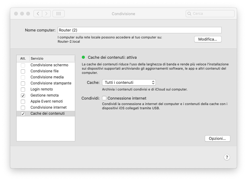

Does anybody have any idea to fix this? I've read that it struggles to work in a VM environment but surely if iMessage and iCloud work there must be a work around for caching?

See here:
Content caching is disabled if mac os finds that you are running the os in a vm.
You could try to disable the hypervisor bit, but I would not recommend it (I tried but it doesn seem to work..), or you can patch the kernel (at your risk), read here:
https://github.com/kholia/OSX-KVM/blob/master/reversing-notes.md
I just tried the kernel patching method and it works for me with catalina 10.15.5 19F101 (latest).
Easy way (DO IT AT YOUR RISK):
0- disable SIP
1- copy file from /System/Library/Kernels/kernel to your desktop
2- open kernel file on your desktop with an hex editor: find the string (there's only one string): E8 E8 D4 AA FF replace with 90 90 90 90 90 and save the file
3- backup the original file:
sudo mount -uw /
sudo mv /System/Library/Kernels/kernel /System/Library/Kernels/kernel.bak
4- move the patched kernel to its position:
sudo cp ~/desktop/kernel /System/Library/Kernels/
5- restart mac os
Edited by ghost82
