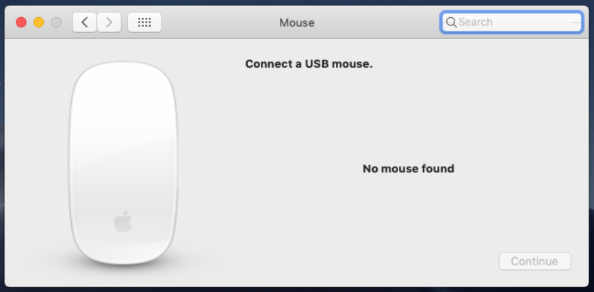

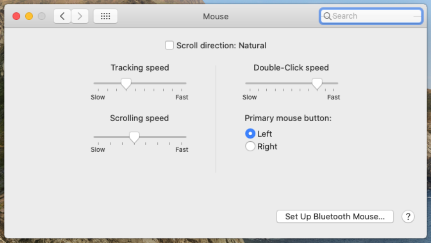

I'm having a strange issue that I have truly tried to search for a fix prior to posting.  I have both a Catalina and a Mojave VM on my system and both are working great but they are exhibiting a strange difference that I cannot explain.  On Catalina, I can change the mouse settings, reverse the scroll direction, etc...  On the Mojave VM, there is "no mouse found" however the mouse works just fine but I don't have an option to change the scroll direction.  I've compared the xml and they seem to be identical.  The only XML changes I've made to these VMs was CPU cores and Ram.  Both start and run perfectly.
Any guidance would be appreciated.
John
Hi, not an issue with the vm but with mojave itself (you can read about similar problems for real macs too).
If you want to set the scroll type try with a terminal command:
Read the current type of scrolling:
defaults read -g com.apple.swipescrolldirection
It returns 1 or 0.
1=Natural scroll direction
0=Not natural scroll direction
Then change the setting with:
defaults write -g com.apple.swipescrolldirection -bool false
true=Natural scroll direction
false=Not natural scroll direction
NB: after changing the setting via terminal you must reboot your vm.
Thank you so much, I never would have guessed it was a Mojave issue!

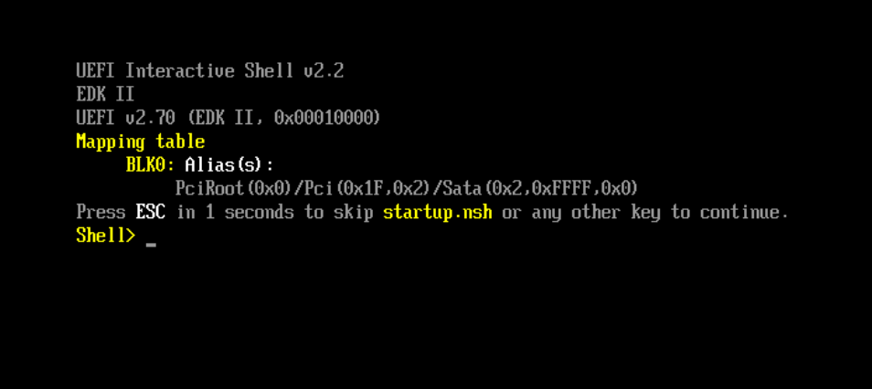

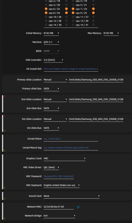

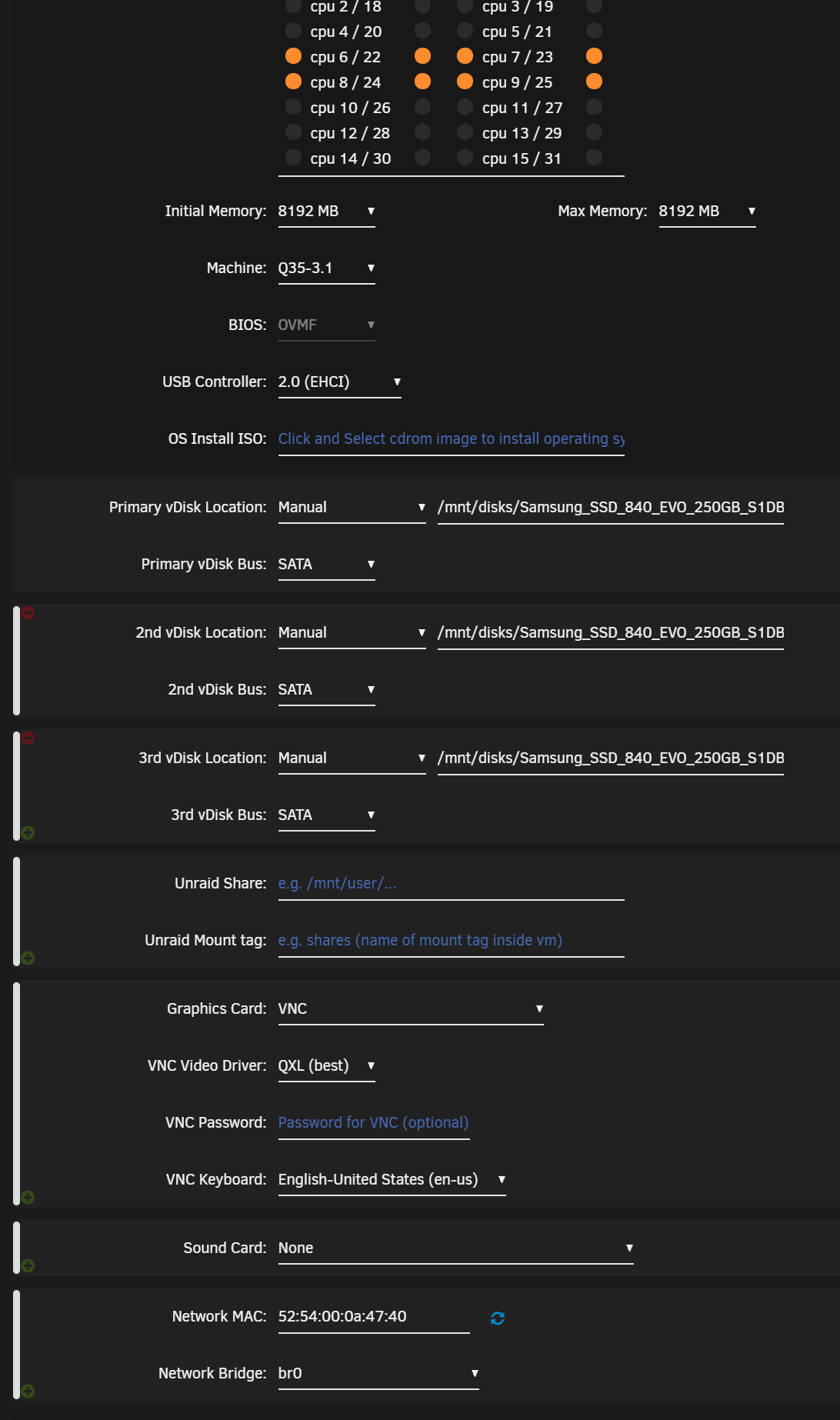

Hi, having an issue with my install. Installed everything and when loading VNC it doesn't connect (has the 3 dots moving across trying to connect)
I am using a separate SSD to install the MacOS on, I think Ive done that correctly.
Any help would be appreciated.
Check your xml, you don't have any custom qemu:args required to boot mac os.
I also suggest to delete the cpu topology from the xml for the first boot and to switch network to vmxnet3 or better e1000-82545em.
Edited by ghost82
Thanks, done that now and still not getting any further on vnc.
Log file
2020-05-18 14:03:58.951+0000: starting up libvirt version: 5.10.0, qemu version: 4.2.0, kernel: 4.19.107-Unraid, hostname: Loki

Now got an issue where it stays on the boot screen with the following
That is the uefi shell, check again all, because it's still not able to boot into mac os.

This is what I've set up
Primary vDisk Location: /mnt/disks/Samsung_SSD_840_EVO_250GB_S1DBNSBDC39645R/MacinaboxCatalina/Clover.qcow2
2nd vDisk Location: /mnt/disks/Samsung_SSD_840_EVO_250GB_S1DBNSBDC39645R/MacinaboxCatalina/Catalina-install.img
3rd vDisk Location: /mnt/disks/Samsung_SSD_840_EVO_250GB_S1DBNSBDC39645R/MacinaboxCatalina/macos_disk.img
Is that what you meant by clover image set to qcow2?
