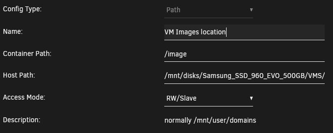

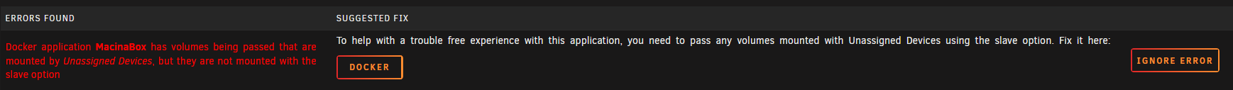

@SpaceInvaderOne After updating to the latest release, FCP gives me the following error:
The path on the unassigned device where the vdisks are on is mounted as "RW-Slave"

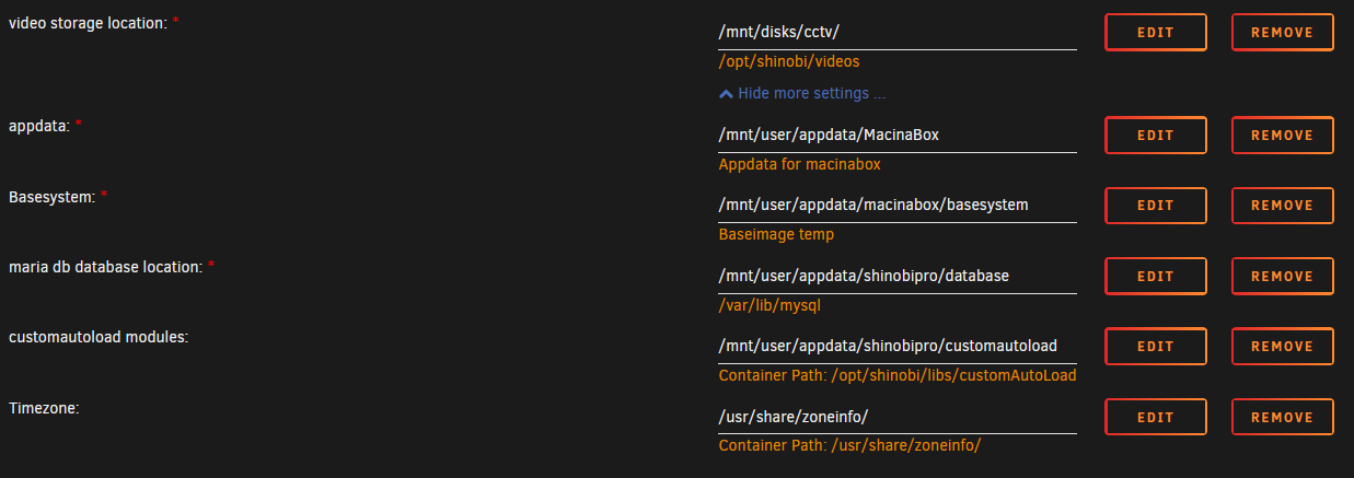

Also worth to mention, there are a couple shinobi paths in the template now which i never added myself. Also I never used shinobi before.

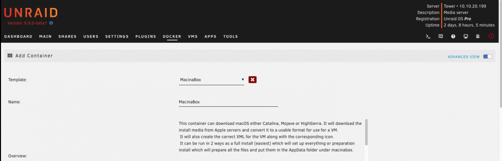

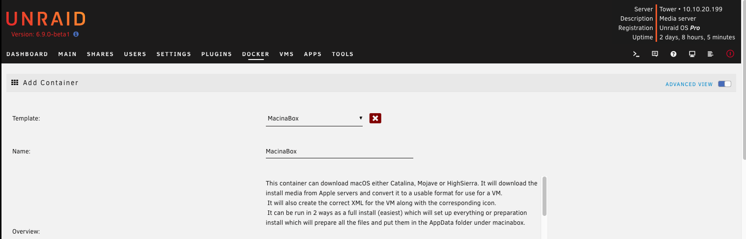

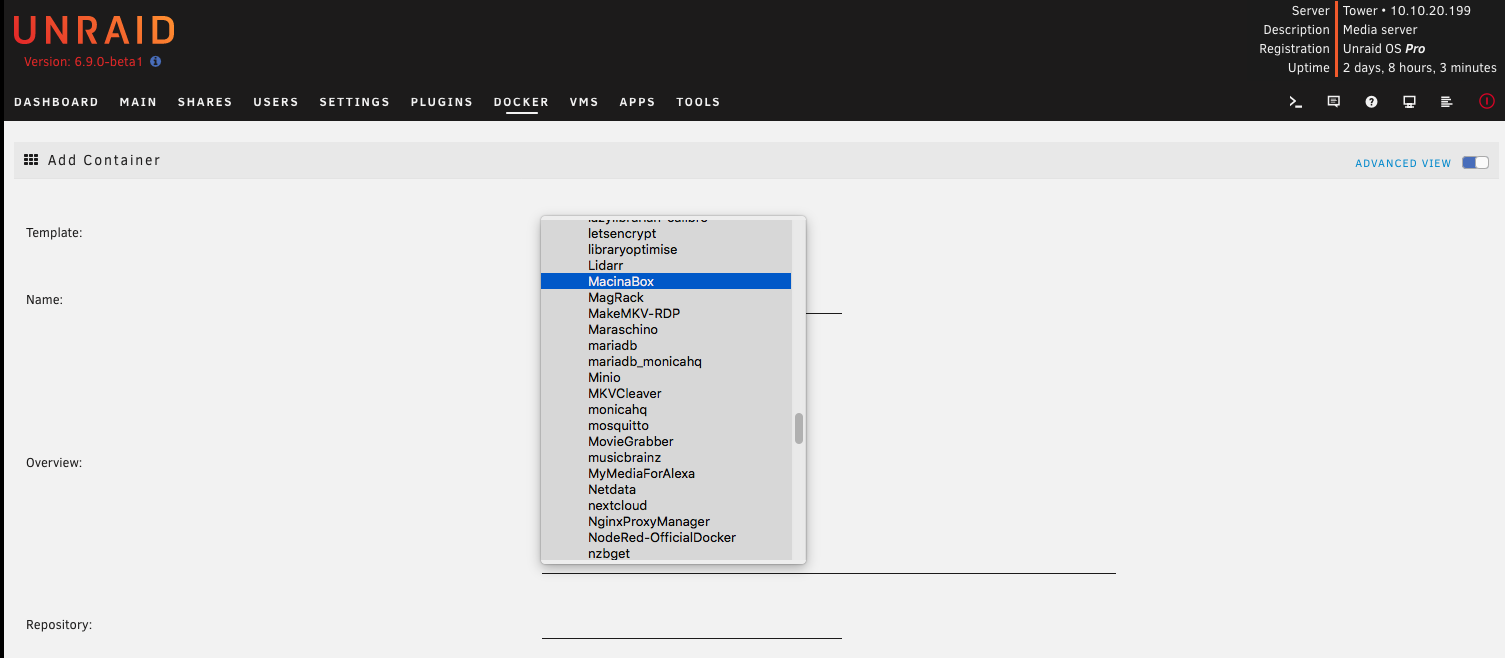

Please goto docker tab and scroll to the bottom. Then click add container.
At the top of the page now click add template and choose macinabox
1633544441_ScreenShot2020-04-09at20_34_11.thumb.png.5d241a9b61c0774cbe4bf7a7b5a3a215.png
Then when the template is open click on the red x  (this will delete the stored template)
959438689_ScreenShot2020-04-09at20_36_07.thumb.png.e6c90b1524a88795c689addb12a1b1ba.png
Now just goto the apps tab and redownload the container. It will now redownload the template too as it has been deleted from above steps.
Should be fine.
13 hours ago, SpaceInvaderOne said:
Should be fine.
Indeed it is. Thanks for the help 👍

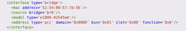

Great tool - worked like a charm, I have changed the cpu count and menory allocation, and it boots as it should.
I have one problem, the netcard is giving me full download speed (500MB/sek) but the upload is all broken at like 0.5 - I have tried what I could think of.  My network looks like below. I have tried with both names vmxnet and the other in the guide. Same result.
  <interface type='bridge'>
      <mac address='xx:xx:00:d2:xx:25'/>
      <source bridge='br0'/>
      <target dev='vnet1'/>
      <model type='vmxnet3'/>
      <alias name='net0'/>
      <address type='pci' domain='0x0000' bus='0x01' slot='0x00' function='0x0'/>
    </interface>

Try changing your NIC to e1000-82545em.
~Spritz
~Spritz
Hi thanx - I did that allready, I just maybe did not explain that right, but I started with the e1000 - and changed it due to the strange performance, but no change. I have other Windows VM's running and they have no problems.
Just talked to another user, same problem on his macinabox machine, out of the box without any changes, speed down is ok, speed up is below 1Mb/sek

Try to address this device like it is internal to MacOS.
<address type='pci' domain='0x0000' bus='0x00' slot='0xPUTSOMEFREESLOTHERE' function='0x0'/>

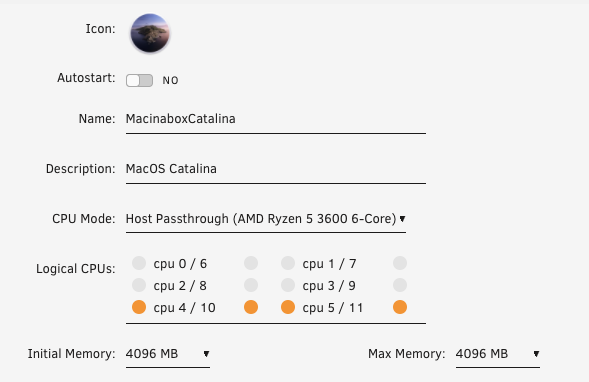

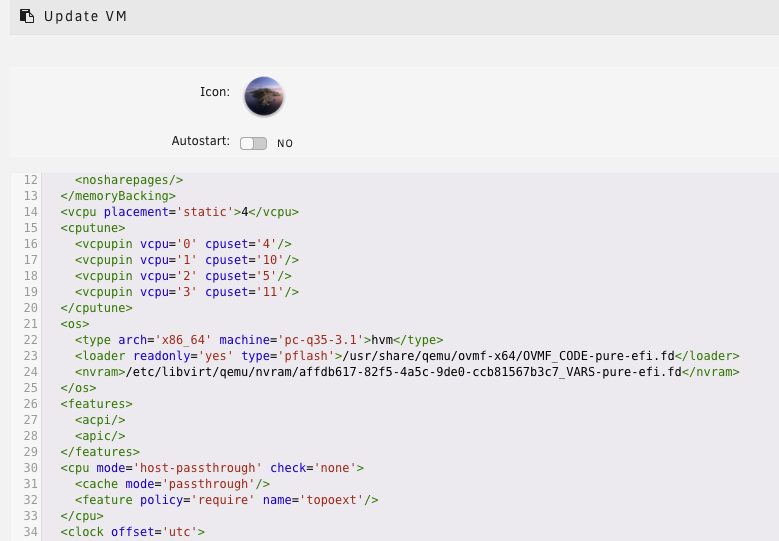

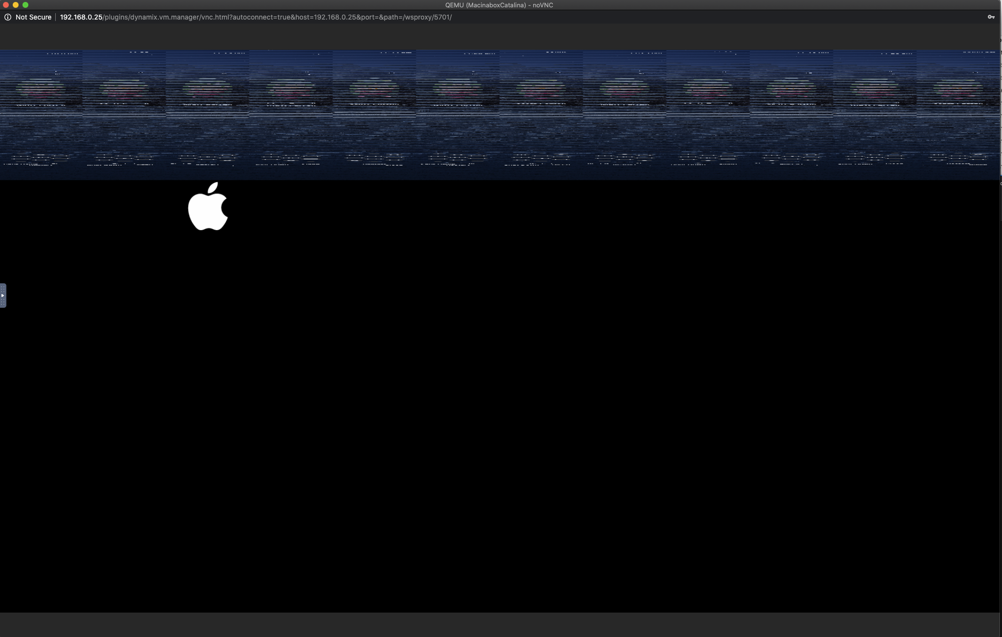

I managed to get the initial install all working fine, logged in, had internet etc.
Wanted to change the CPU to use a different 2 cores (4 threads).

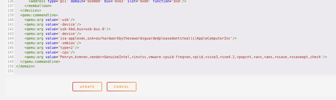

Stopped the VM, copied the required XML section so I don't lose it. Then changed the CPU's like so:
Updated network interface, and pasted the XML section at the bottom:
1209699772_ScreenShot2020-04-20at4_30_32pm.thumb.png.d620082422ae61323aba370fe32e1c48.png
Now it appears to boot, and I can open VNC. However it looks like this on every browser:
112003032_ScreenShot2020-04-20at4_23_59pm.thumb.png.de6c797378df2e639c46055244f6ea67.png
Any ideas what I could've done wrong? It's sort of working as I can see the small mouse moving on all those little screens.
Any tips would be much appreciated!
