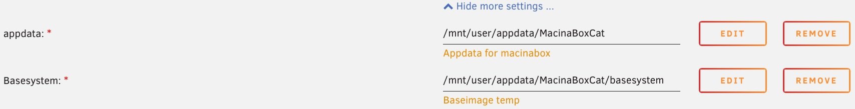

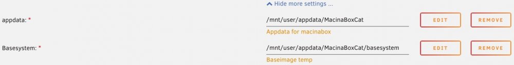

On 3/8/2020 at 9:06 PM, AgentXXL said:
Change the folders used for appdata and Basesystem to something other than the default locations. I had a working Catalina VM alongside a High Sierra VM on my older system still listed in my signature. As mentioned in my post above, I just transplanted my entire unRAID setup to a used Supermicro CSE-847 system. Alas the dual Xeon x5650 CPUs don't support AVX2 so I can no longer use the Catalina VM.
I tried that, but no vm appear.

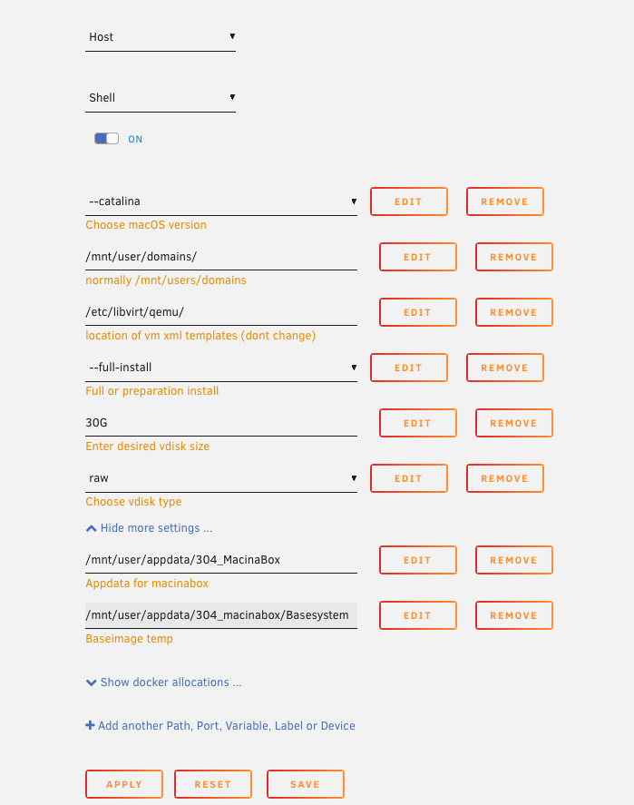

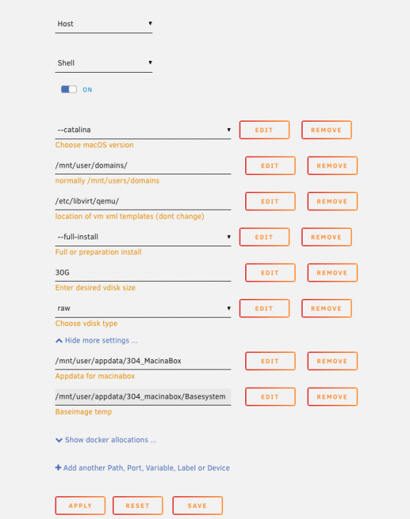

Did you stop and restart the array after using the docker container to create the VM? The stop/restart is required for unRAID to see the VM.
Jups!
1 minute ago, frodr said:
Jups!
Did you verify that MacinaBox created the full VM or was it set to just do the pre-install? By default the Docker container is set to pre-install so you have to change that parameter to 'full install'. Check your log for the 'MacinaBox' container on the Docker tab - it should end looking something like this if you have it set to 'full install'. If your log verifies that the vdisk was created, once you stop and then restart the array it should appear in the VM tab and in the VM section on the Dashboard tab.

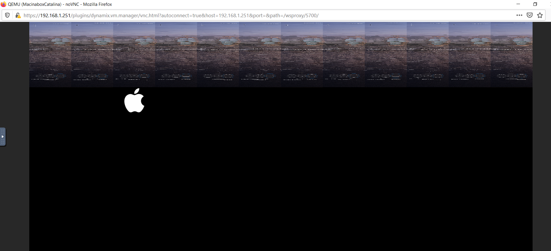

I updated the network card to vmxnet3 and when I reboot I see this issue with the vnc video.
Thoughts?
Thanks
Thoughts?
Thanks
Just coming into this thread...is your bios resolution the same as clover? that's required.
vnc back into macOS, edit clover resolution to match your monitors NATIVE resolution (under gui section).
Hit esc rapidly while booting back up so you get into the OVMF menu and change target resolution to match.

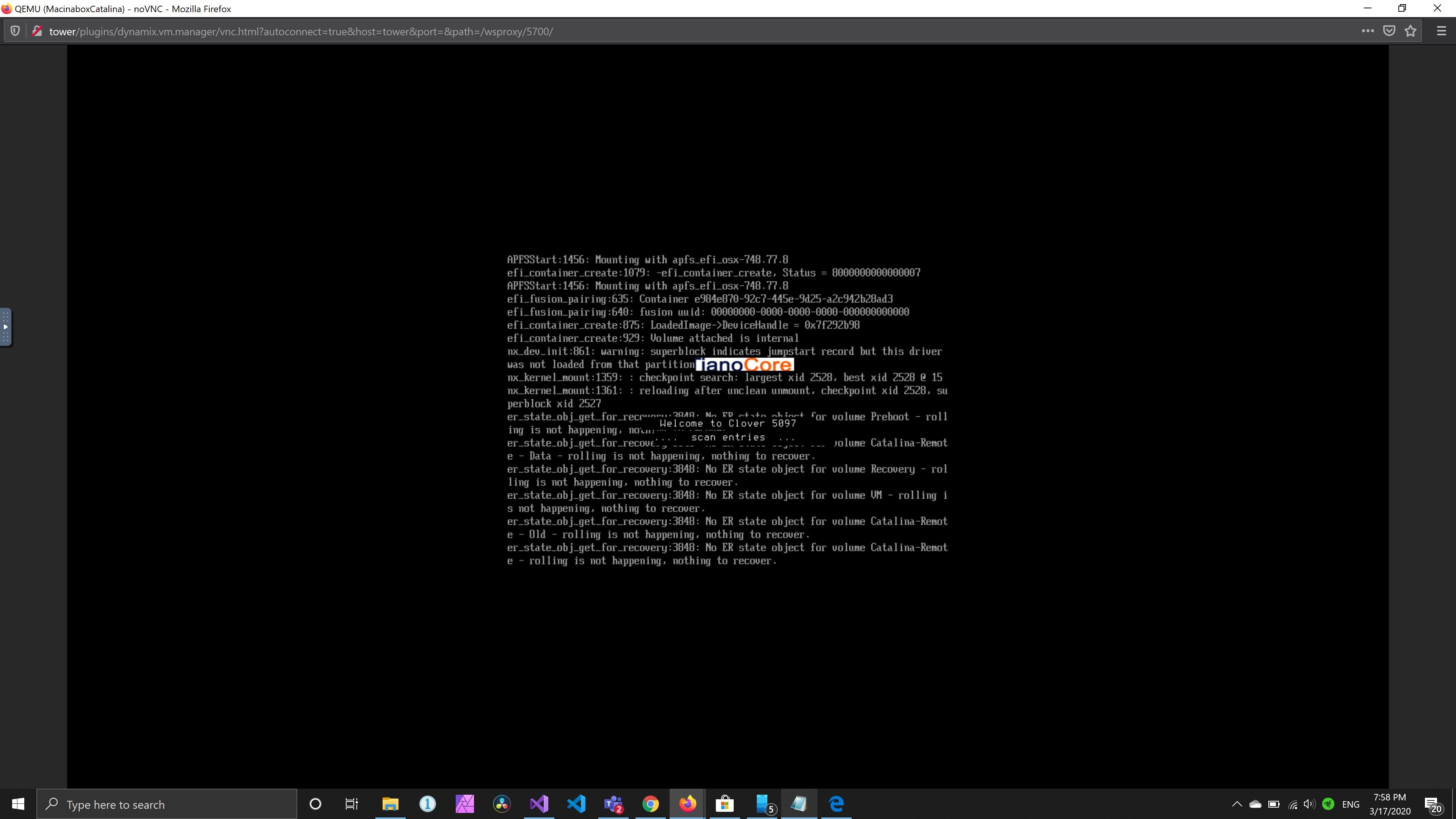

So, I'm stuck in a Catalina boot loop. There are a couple older mentions of similar symptoms, but one of them never got answered, and the other seemed to be during install. The install finished and I got to the OS, set up remote login. I shut it down to edit config, and it won't boot back up. I get it even if I restore everything back to the default settings before I made any changes. I get the Apple logo, the progress bar gets a few ticks along, then it loops back to a terminal window (I've attached a screenshot of that) then it goes to the Clover screen, then it tries to boot again until I force a stop.
I can mess with settings and force the graphical issues if I want, and in that case, it seems to actually boot, but I need to get in to some system settings.
I am going to try a High Sierra install, I need to access this remotely for emulating iOS for Xamarin, so I don't care if it's headless, but I need to get at some settings. I can't spin down my array at the moment, as it's rebuilding and has 20 hours to go, so all I can do is poke at the XML and I'm just learning what these things all do.
Here is my XML as it currently stands (mostly OOB standard, but I did add a couple cores just to see if the problem was not enough resources when it just got a couple old-ass cores). But I think 8GB and 4 cores (even if these are 10 year old Xeons) should be enough to at least boot.

I got two questions regarding my Catalina-VM:
1. I accidentally changed the resolution from 1920x1080 to 2536x1536 (or sth. like this) in the clover.plist (via Clover Configurator). I forgot, that Mac OS needs Hardware Acceleration (or at least mor VRam) to support higher resolutions. This is not the case as I do not passthrough a graphics card. Instead I am using VNC/Fluid desktop via JumpDesktop from my IPad.
My intention was to optimize/align the resolution for my IPad, otherwise I can only use a small potion of the screen when using VNC.
However, I am getting glitches, which do not allow me to boot up properly / sign in into my user account. Is there a way to override the setting with a boot arg or within Clover at boot time?
2. As graphic performance is really bad via VNC (some programs do not render properly, e.g. OpenVPN just displays a black background which renders it unusable), I thought of buying another dedicated graphics card. At the moment I am running a Nvidia 1060 GTX which I passthrough to my Windows VM (would not be compatible with Mac OS anyway, as there is no WebDriver / support for the Nvidia 1000 series at the moment).
What would be a cheap graphics card, which allow me to do 4k for Office / Desktop usage (no gaming)?
Thanks for your input.
I changed name to xxx_MacinaBox, Appdata and Basesystem folders, but no VM was created. Anything I am missing?

I deleted the Macinabox docker and reinstalled it, set appfolder and basefolder different from current VM and full install. The same log file. No additional folders in /domains was created. The Docker seems to be referencing the current VM.
Thoughts?
Thoughts?
I was having issues with my High Sierra VM so I decided to try a full de-install/cleanup and then start from scratch. I removed the MacinaBox docker and deleted all folders related to it on both the flash drive and in /appdata and /domains. So neither the MacinaBox docker nor any VMs were on my unRAID build.
When I re-installed the docker and ran it, I initially installed a new High Sierra VM that's been working well. But I also noticed that there were still two folders created under /appdata - 'MacinaBox' for the main appdata folder and 'macinabox' for Basesystem. This was corrected again by changing the case of the letters so both paths used the /appdata/MacinaBox folder.
I then decided to try another Catalina VM after reading up on AVX2. While my older x5650 Xeons don't support AVX2, it's really only needed to improve overall performance. The older AVX support still functions. All I changed in the MacinaBox docker were the OS choice (--catalina) and edit of the paths under 'Show more settings' as the attached image shows - change the 'MacinaBox' to 'MacinaBoxCat'.
The docker ran, created the VM (as I chose --full install) and after stopping and restarting the array, both it and the High Sierra VM were available. I've run them both since the install and they both continue to function. Note that I did not pin any cores to the VMs at this time... just wanted to see how they perform 1st and so far everything is running pretty well.
So for those that want to do dual (or more) Mac VMs, it looks like the key is to make sure you set your appdata and Basesystem paths correctly. I'm not sure if them both using the same case for the spelling of 'MacinaBox' had an effect, but since it's working I'm going to say that mixed case spellings between the two paths may be part of the issues others are seeing.

No VNC Remote after vm restart:
After MacOS VM restart, VNC Remote is not working. The VM starts fine I think, but VNC Remote is this blurred screen with Apple logo. Adding a remote software before starting is possible. This connection, (RealVNC. Apple Remote Desktop and Splashtop), all connects after VM restart, all of them in 800 x 600 resolution. Can it be that the MacOS VM setting resolution to 800x600 is causing the problem.
Thoughts.....

I think I have to call upon Linuxserver guys or SpaceinvaderOne:
Is it a known issue that the macOS Catalina VM VNC Remote is not working after first restart of the VM?
Cheers,
Frode
