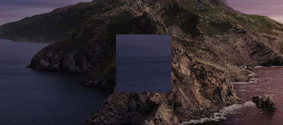

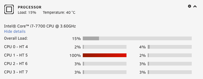

I'm having some issues with my VM and I'm hoping someone can help me :) I've been happily running the VM for a while now but it doesn't seem to like upgrades
First I tried going from UnRaid 6.8.2 to 6.8.3, once it was back up I couldn't get the VM to load properly anymore. It would open up but instantly it would peg it's first assigned core to 100%, it would slowly make it to the login screen with a graphical issue. If you type the password it would start loading and then just reboot. To fix this I rolled back to 6.8.2 and restored the instance from TimeMachine. Everything was ok...
Until I tried to update Catalina to 10.15.4 (I was on the previous version 10.15.1?), after a restart it lets me know the update failed to apply and exhibits exactly the same behaviour.
If I boot the VM into recovery mode it doesn't peg the CPU and works normally.
edit: forgot to mention I'm not doing any GPU passthrough.
Edited by Lee.B
What version of clover are you running?
It seems related to graphic acceleration, in recovery mode mac os doesn't use acceleration, this is why you don't have slow performance.
Edited by ghost82
2.5k rev 5097
7 minutes ago, Lee.B said:
2.5k rev 5097
I would update clover first (latest release now is v5 r5114) and check if there is any difference (from r5098 there are improvements in Catalina compatibility).
Mount your efi, download from github the iso image, mount the iso, overwrite files from iso to EFI, check config.plist and eventually adpt to the new clover revision (compare config.plist files to see if there are new options added/removed).
Try to inject also lilu+whatevergreen kexts.
Edited by ghost82
Thanks, I'm guessing I can use the pre-macinabox spaceinvaderone videos guide how to go about this?
I'll give this a crack tomorrow as it's night here :)
I'm not sure but I don't think that he explains how to update the bootloader, there's a pre-made qcow2 clover image, the one you have (r5097), that during the setup the macinabox downloads.
Edited by ghost82
Try the attached clover qcow2, backup yours first if this doesn't work.
I modified the original Clover.qcow2 from the macinabox github repository, so if you changed SMBIOS data you need to change them again.
Config.plist is also the same as the original macinabox, sligtly modified, it should be compatible with the latest revision.
It's the latest release, revision 5114 but I cannot test, so not sure if it will boot or not.
Just try..
Clover.qcow2.zip
Edited by ghost82
