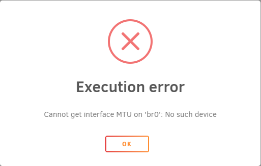

Hi, installed successfully however when I come to start the VM I get the following message:
Changing `/boot/config/network.cfg` to `/boot/config/network.cfg.bak` on the flash drive worked for me.

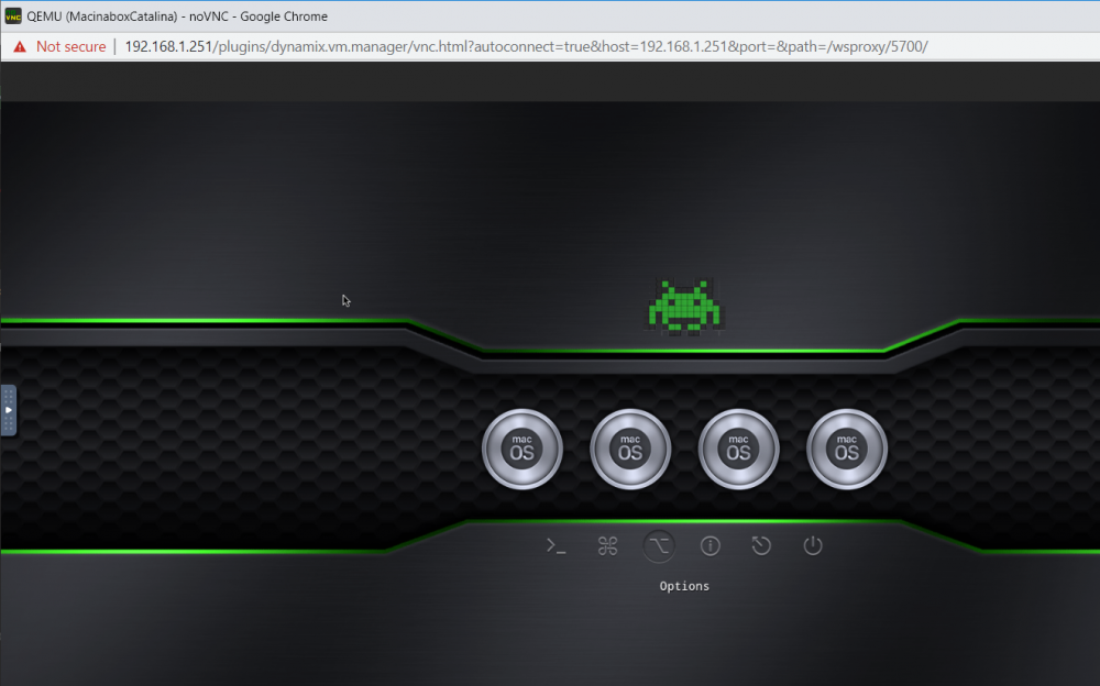

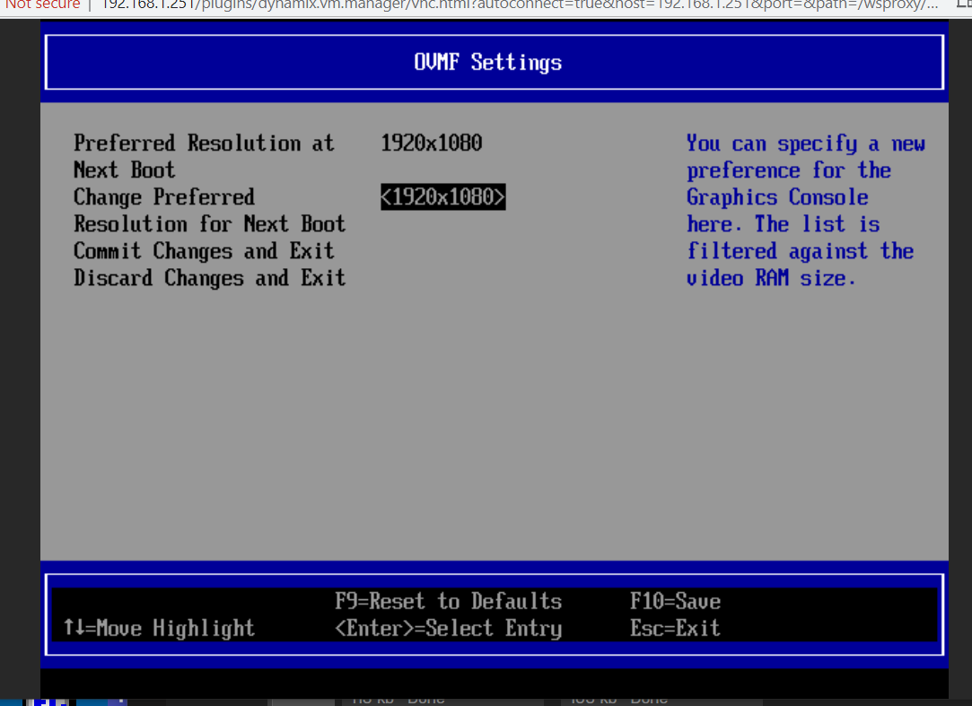

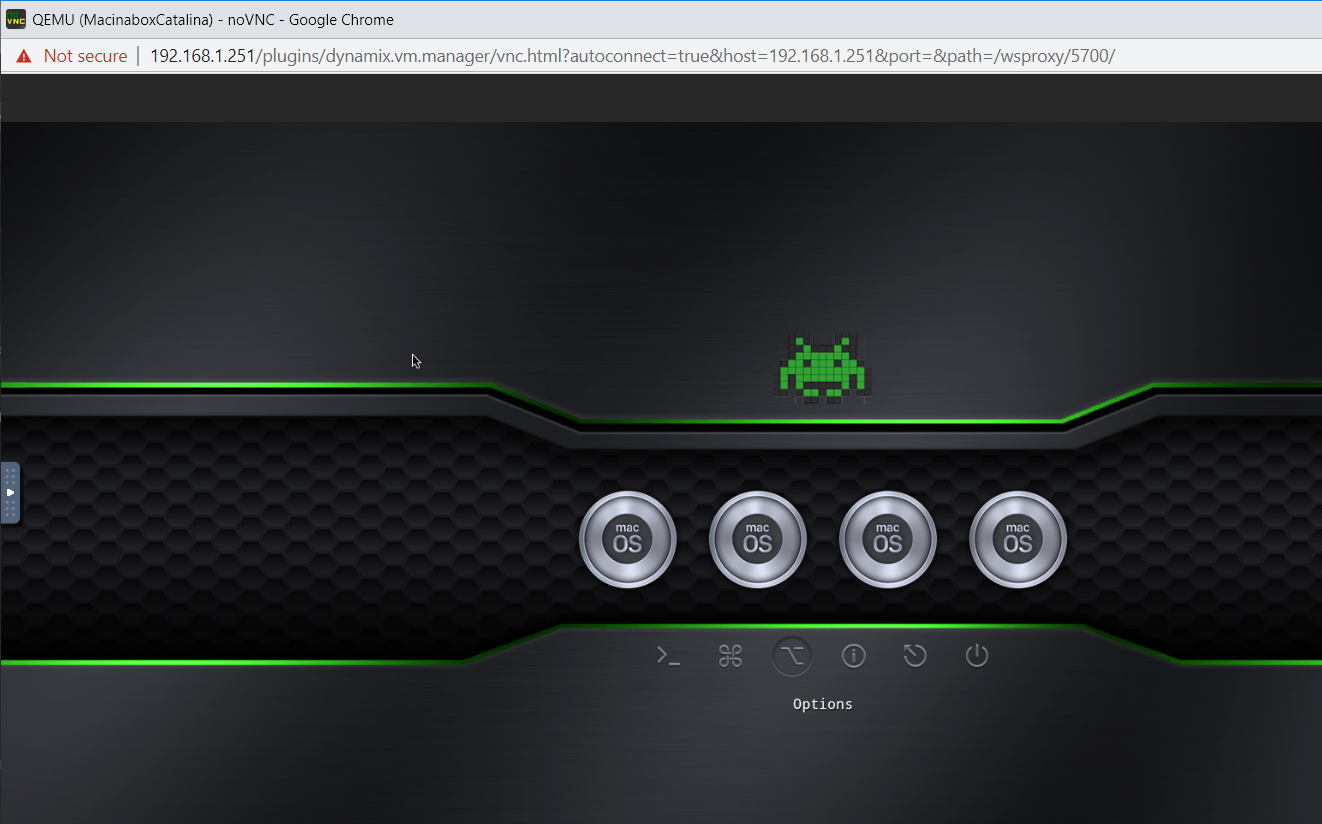

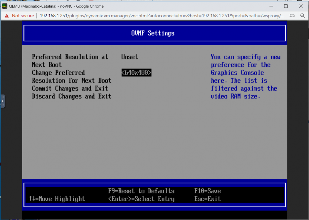

On 3/15/2020 at 3:00 AM, wbsmolen said:
Just coming into this thread...is your bios resolution the same as clover? that's required.
vnc back into macOS, edit clover resolution to match your monitors NATIVE resolution (under gui section).
Hit esc rapidly while booting back up so you get into the OVMF menu and change target resolution to match.
Thanks for the feedback.
Am I in the right place to set the resolution in Clover?
Edited by newmember
No. Force stop and then start the vm. hit esc rapidly on the bios boot logo screen to open bios settings. from there, go to device manager and change ovmf's resolution to match clover (1920x1080 default)

All of a sudden my mouse don't work anymore through in the VNC/browser. I can use the keyboard, but mouse don't work (I can see the curser) It works perfect in my Windows VM.
Any ideas?

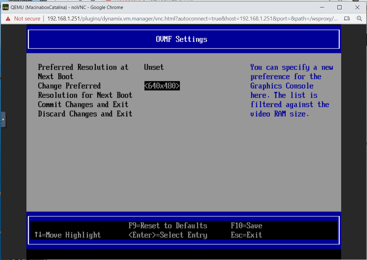

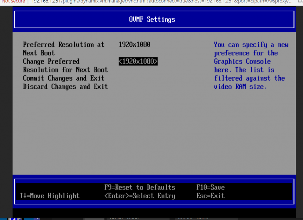

Thank you
I found it easier to start the boot up to the
Then I found the OVMF setting as you has described.
It was set to 1920X1080  before I updated the CPU from 2 to 4
It was now set to 640X480.
Then I updated it to 1920X1080,
Then 'commit changes and exit.
When I go back to the OVMF screen the 'preferred resolution' is updated
ESC to exit
Restart
The first restart and I had he same 640X480 resolution.
I stopped the VM
Started the VM and good to go.

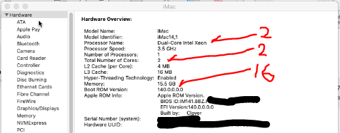

Checking back:
  <memory unit='KiB'>16252928</memory>
  <currentMemory unit='KiB'>16252928</currentMemory>
  <cpu mode='host-passthrough' check='none'>
    <topology sockets='1' cores='2' threads='2'/>
This shows up as Dual Core and 2 Cores = 4 Cores total
Thanks for the assistance.
