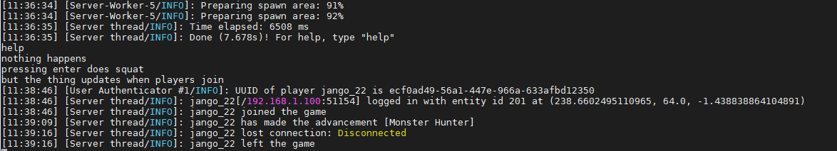

This is likely a silly question but I'm new to Minecraft and obviously this container. Is there anyway to upgrade to the latest snapshot, 20w10a in this docker container?
I am able to connect to the console with the command you have provided however keyboard inputs do not make it to the terminal properly. typing any command is not received by the minecraft server and not even ctrl+a+d is letting me escape the session.
here is a screen shot showing what I mean
Same is happening to me
what is the command you are issuing in order to get to the minecraft console?

I'm new to the server business and was wondering how to add spigot to the server. It seems to have worked but when I go to use the commands its like the plugin isn't installed.
Hello, not the same person, but the same problem. I am using
docker exec -u nobody -t binhex-minecraftserver /usr/bin/minecraftd console
on Unraid 6.8.2
on Unraid 6.8.2
Your are missing the interactive flag, so change -t to -it
Sent from my CLT-L09 using Tapatalk
Thank you, this worked for me. I found the command on I believe your FAQ page, so maybe change that over to be -it as well
The FAQ is correct and defines both interactive and terminal, i.e. -it
