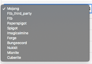

A little bit of cross advertisement here :-), if you are looking to run multiple Minecraft Servers (Java only) and/or you want to run non Mojang versions such as Paperspigot, Spigot, Forge or Nukkit then you may want to look at switching to MineOS-node (install via CA), link to support below:-
https://forums.unraid.net/topic/92533-support-binhex-mineos-node/
Screenshot of available server types:-
Edited by binhex
