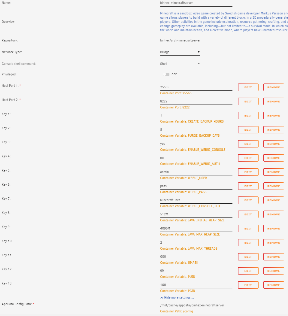

Sure thing, here's the docker container settings:

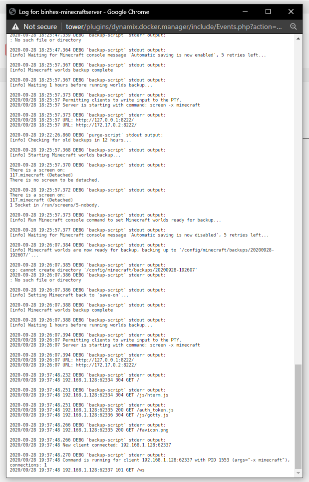

The thing that pops up when I click the 'Log' to the right of the container:
I've also attached the supervisor. Last updated a few minutes ago.
EDIT: Pretty clear to me there's something preventing the backup script from running, but I'm not sure what gives.
Thanks
i believe the script is running but for some reason its having a hard time creating the destination folder to store the backups in. i have made a modification to the script and a new image is now available, please pull down and give it a try and see if this fixes the issue, let me know.
