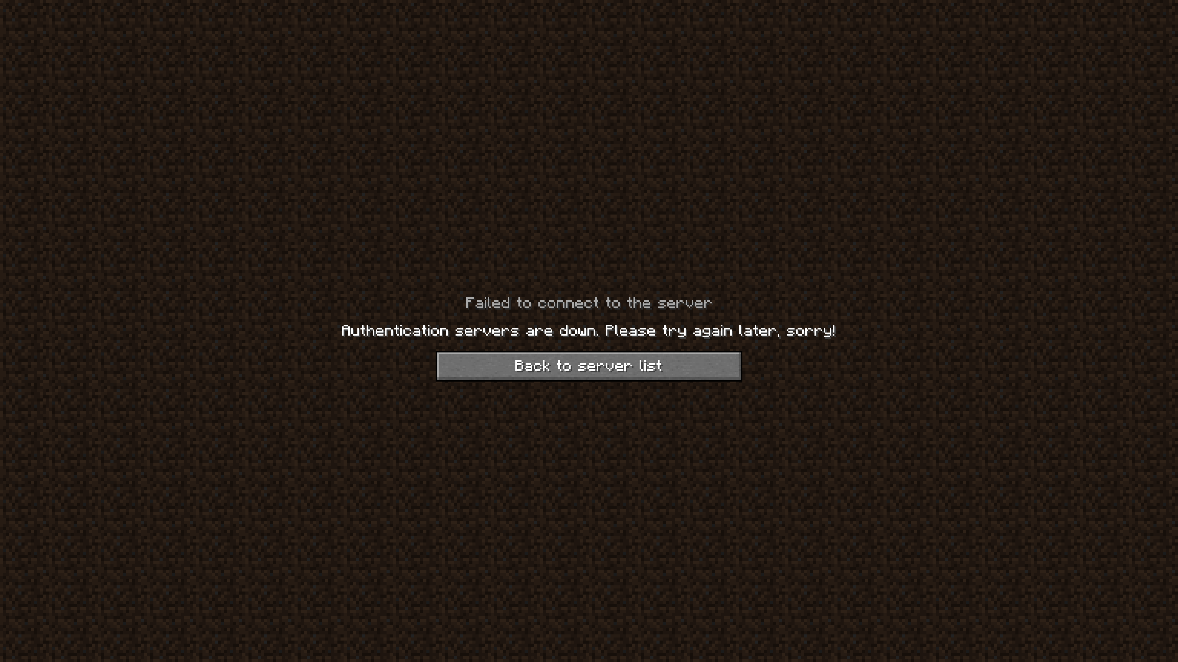

Hey, whenever I want to join my Minecraft server, I get this message. Does anyone know a solution for this?

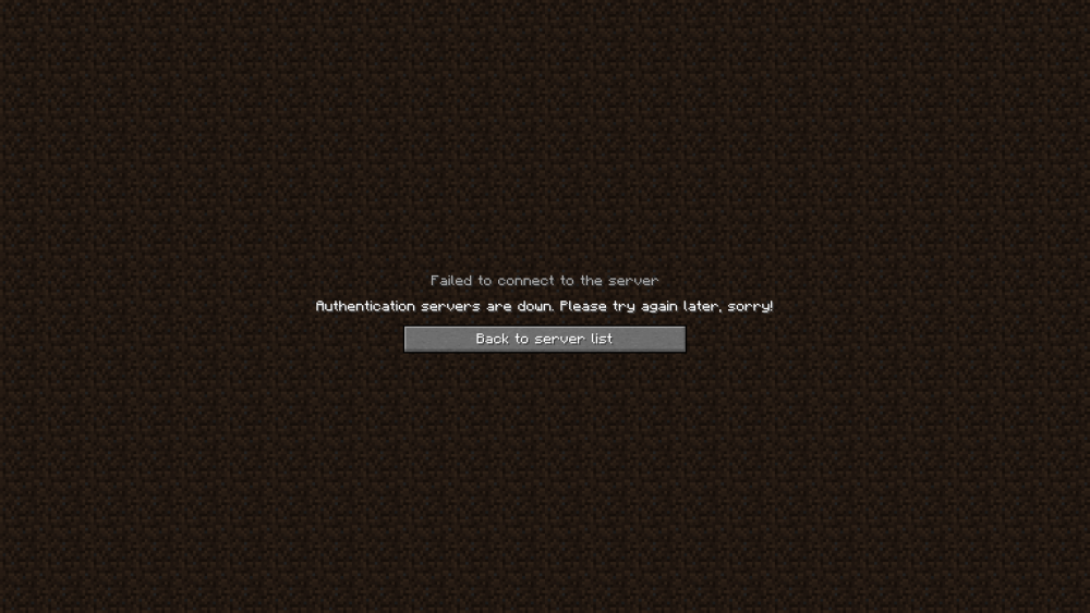

So i've started getting this error about 48 hours ago and can't find a work around.  I'm using cloudflare-ddns and using my own domain name instead of just the IP address (found how to do it in a spaceinvader one youtube tutorial)  It's been working fine for weeks but now I'm getting this error.  If I put in the ip address of my host machine I can connect fine but for people outside of my network that want to connect I can't give them my public IP besides it being an unsafe practice dynamic and not always constant.  Any advice on how to fix this would be greatly appreciated.image.thumb.png.fa15baea8f5c2b8ac4493895972408d6.png

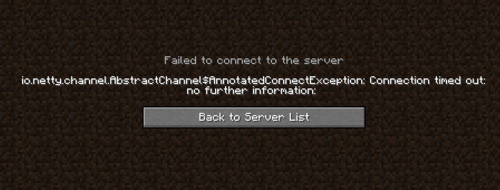

so that's good, but still Minecraft just won't connect to anything. When connecting, I should go to Multiplayer > Direct Connection > "192.168.11.53:25348"
I've forwarded the port 25348 on my router from external to my internal unRaid box port, just like I do other services that do work, and head to my duckdns subdomain, and no luck there either.
Error in Minecraft is "Failed to connect ot the server.
io.netty.channel.AbstractChannel$AnnotatedConnectException: Connection refused: no further information.

I am sure I forwarded the port correctly through the router - but using ismyportopen.com, I get a negative.
How did you fix this?  The EULA is already set to true for me and I'm getting the io.netty. . . error
