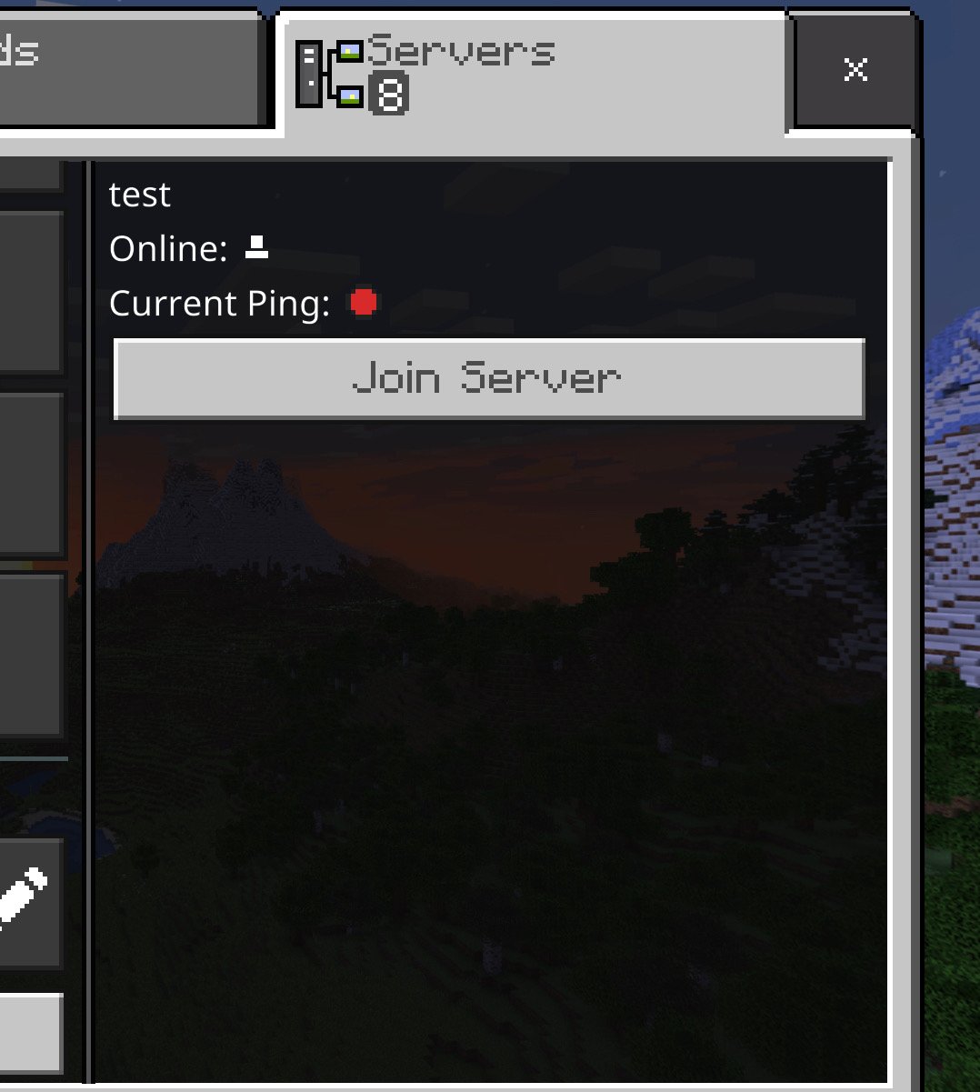

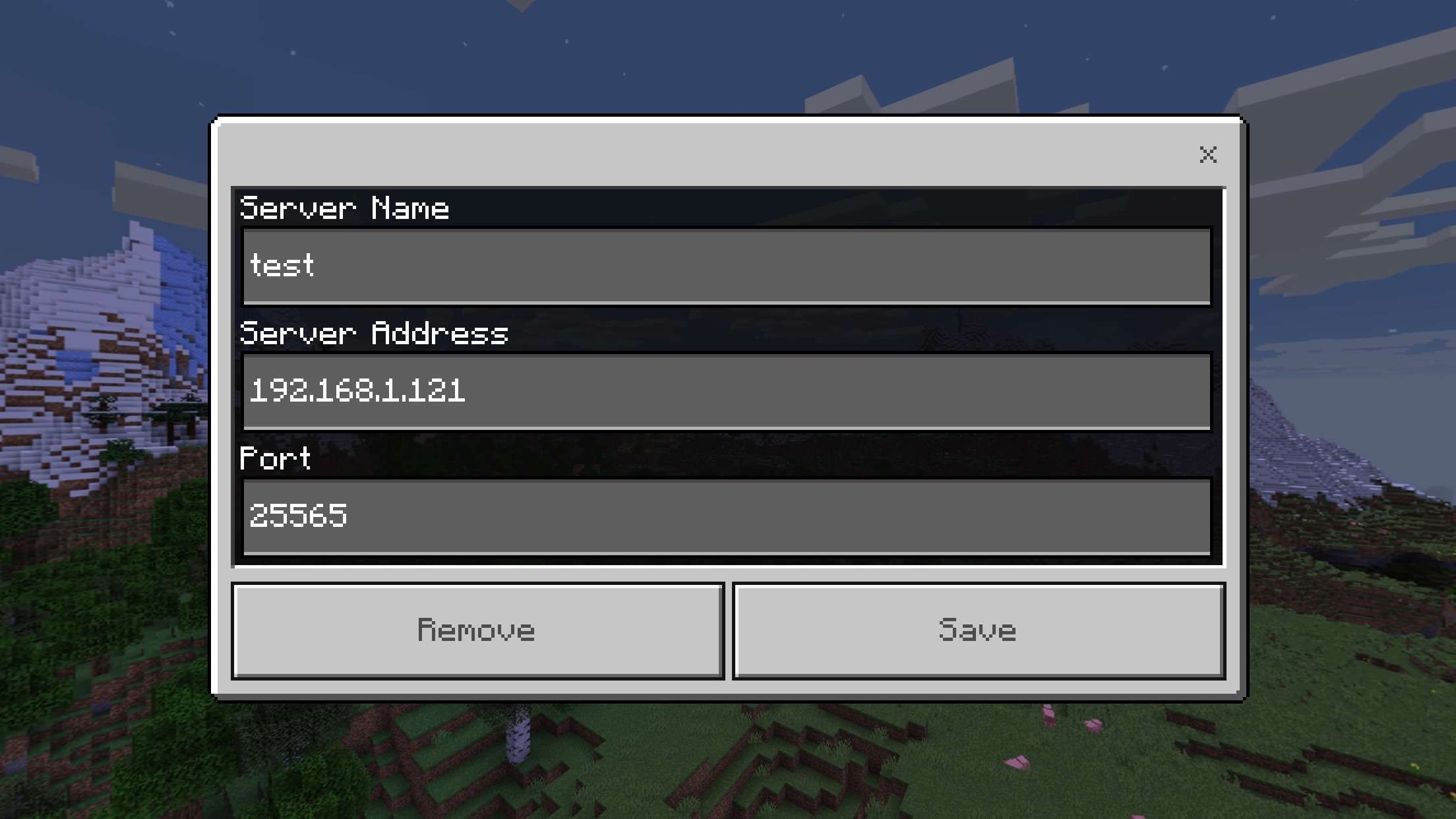

hi everyone. minecraft noob here, wanted to set this server up for my boys, and i think i must be missing something (hopefully simple). just installed, pretty straightforward, but even on my LAN, i'm not able to connect to the server from an ipad on the same lan.
local ip is 192.168.1.121, port is 25565, confirmed here in screenshots.
801396455_2021-12-0511_30_18pm.png.a5a43020c79271738ecf6ccf6ffecb4d.pngIMG_3672.thumb.jpeg.a5d656080e4f6c78eb5095e361c18df7.jpegIMG_3674.thumb.jpeg.7b9705a5327f7cbf43bfea3068e3cf64.jpeg
it's not showing any ping at all, and won't connect when i click on it. aside from setting a web ui password, i left the container settings as default. i can connect to the web ui just fine, and the container log shows the ip of the machine connected to the webui just fine - i don't see any errors anywhere either. i'm trying to connect to the server from ios devices if that makes an difference. any help appreciated, happy to provide any info. thanks!
you are running the wrong version of the server, you need bedrock edition, quote from mojang:-
Bedrock, or Bedrock Edition, is the version of Minecraft that brings together consoles, iOS/Android, and Windows 10. Bedrock originated as "Pocket Edition" (MCPE/PE), as it was originally only available on mobile devices.
go take a look in CA for the minecraftbedrockserver
