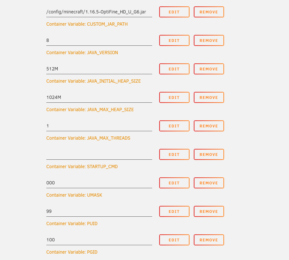

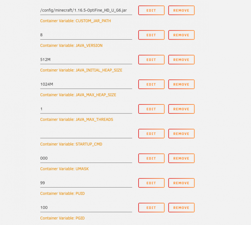

I know you didnt want people using custom variations for this very reason but my kids love their optifine world and I had to use it to get it to work on unraid.  It appears that this update has killed the MAIN_EXECUTABLE variable, or i am not doing something right. I can get it to start but only as 17.1 which wont work.  Is there another way to get their custom 1.16.5 optfine to work now?
what is JAVA_VERSION set to?, it should be 8 for minecraft version 1.16.x or earlier
It is set to 8 and the custom jar is selected but it still runs 1.17.1

actually after deleting log entries i think it just doesnt like my jar file or know where it is at
"Error: Could not find or load main class net.minecraft.client.Main"
if anyone can get this jar to run in minecraftserver without it being 1.17.1 please let me know how. it worked until cave update using MAIN_EXECUTABLE variable. Now i cannot get it to start to save my life.
1.16.5-OptiFine_HD_U_G6.zip
nevermind, i just gave up and ran the profile forge 1.16.5 in mineos then put that in the resourcepacks  folder as a mod. Kids are happy again
