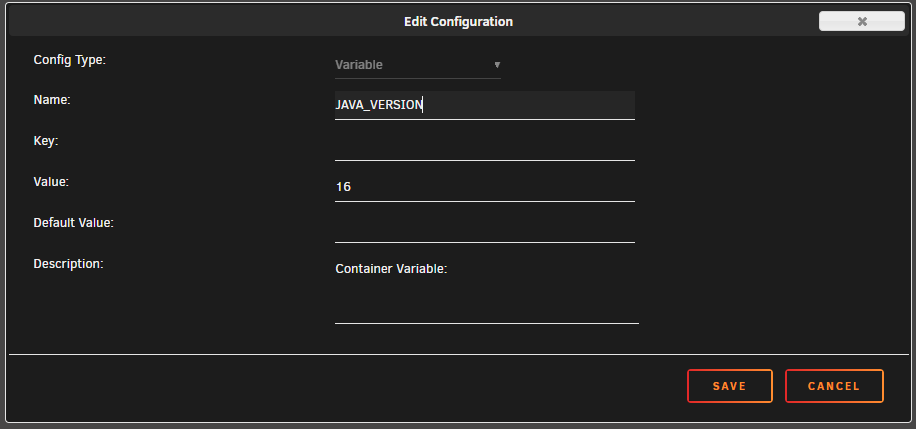

I have the JAVA_VERSION: variable set to 16
However, when I start up the docker after the most recent update, I notice this in supervisord.log
JAVA_VERSION not defined,(via -e JAVA_VERSION), defaulting to '8'
I'm currently getting a connection refused message in the minecraft app. I wonder if this is why.

i would suspect you havent created the variable correctly, please edit container and then click on edit for the variable and screenshot it and post it here.
Thank you, sir.
Thank you, sir.

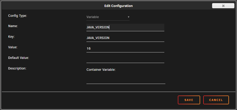

Yeah I thought so, you have the name set not the key, set the key instead

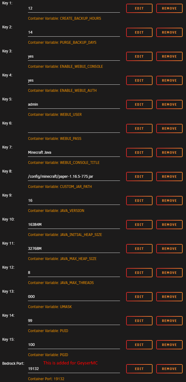

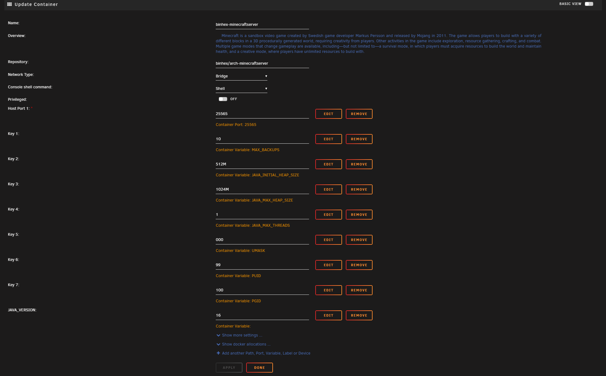

Your template has only a portion of keys comparing to mine. (also have Host Port 1 & 2 above these, couldn't fit in a single screenshot)
Maybe you should remove (but keep the appdata) this docker image and reinstall it, just a thought.
Also like @binhex mentioned the important part of a variable is the "Key" name, you can set "Name" the same thing if you like, it is only for labeling (left part of the screenshot).
Edited by UNOPARATOR
That worked.  Thank you, sir.  For reference if others are looking, here is the successful log line.
2021-06-12 11:42:02.635421 [info] JAVA_VERSION defined as '16'
