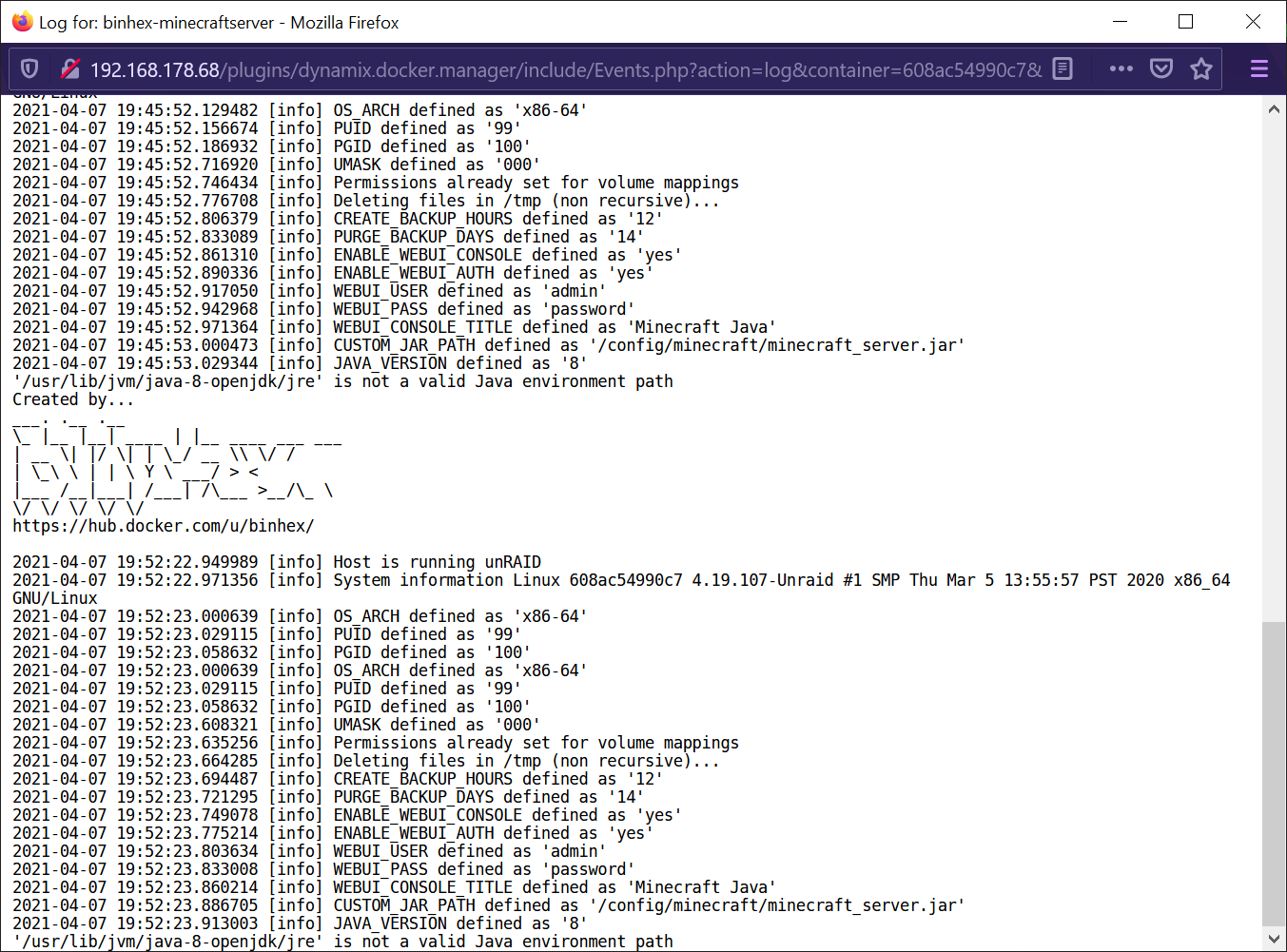

Hey guys,
I've tried to install the Docker with default settings. The Docker wont start and the log shows following errors:
2021-04-01 09:22:17.234741 [info] Host is running unRAID
2021-04-01 09:22:17.254309 [info] System information Linux b21aac0e4fe1 5.10.21-Unraid #1 SMP Sun Mar 7 13:39:02 PST 2021 x86_64 GNU/Linux
2021-04-01 09:22:17.275761 [info] OS_ARCH defined as 'x86-64'
2021-04-01 09:22:17.296742 [info] PUID defined as '99'
2021-04-01 09:22:17.319586 [info] PGID defined as '100'
2021-04-01 09:22:17.353932 [info] UMASK defined as '000'
2021-04-01 09:22:17.374131 [info] Permissions already set for volume mappings
2021-04-01 09:22:17.395496 [info] Deleting files in /tmp (non recursive)...
2021-04-01 09:22:17.417533 [info] CREATE_BACKUP_HOURS defined as '12'
2021-04-01 09:22:17.438475 [info] PURGE_BACKUP_DAYS defined as '14'
2021-04-01 09:22:17.458886 [info] ENABLE_WEBUI_CONSOLE defined as 'yes'
2021-04-01 09:22:17.479835 [info] ENABLE_WEBUI_AUTH defined as 'yes'
2021-04-01 09:22:17.501167 [info] WEBUI_USER defined as 'admin'
2021-04-01 09:22:17.522364 [info] WEBUI_PASS defined as 'test'
2021-04-01 09:22:17.543231 [info] WEBUI_CONSOLE_TITLE defined as 'Minecraft Java'
2021-04-01 09:22:17.564069 [info] CUSTOM_JAR_PATH defined as '/config/minecraft/minecraft_server.jar'
2021-04-01 09:22:17.584927 [info] JAVA_VERSION defined as '8'
'/usr/lib/jvm/java-8-openjdk/jre' is not a valid Java environment path
Where am I going wrong?

see the pinned post at the top. it runs you through the fix.

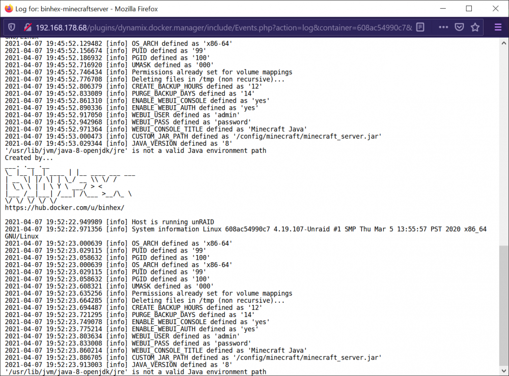

I can't start my Docker container. I left all settings as they were during installation, but when I press "Start" nothing happens.
This is what the logs say:
Anyone know what I can do?
top of the screen, recommended post 'glibc causing random errors'
