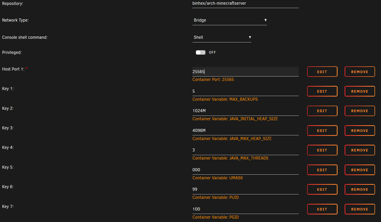

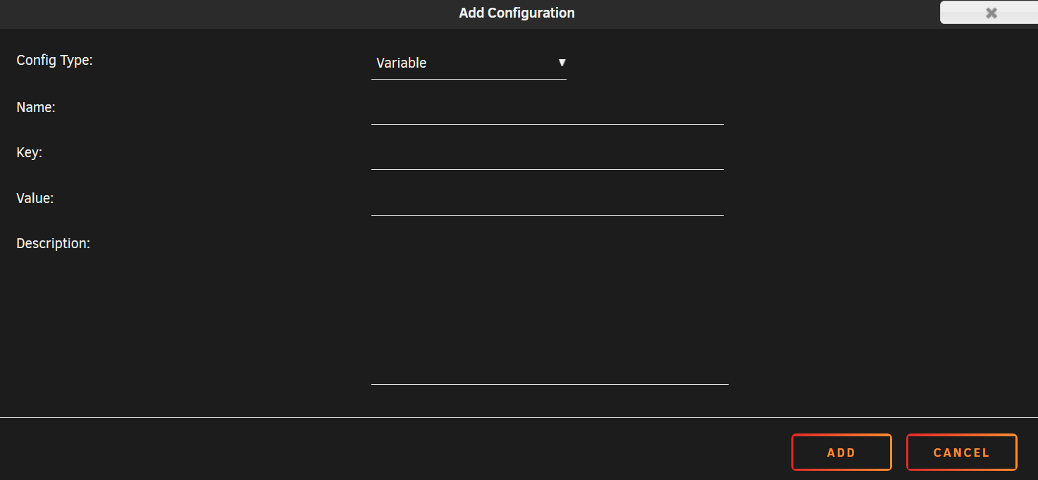

Hi Binhex, thx a lot for this enhancements! I just updated to the latest version. When I try to enter the new variables, I only have this options (but the last 34 are missing: display, required, passwork mask):
If I remove the template and re-add it from CA do I need to make a manual backup before? I guess this will solve the previous issue I mentioned.
This is my actual setup:
You don't need to do a backup per say all you really need to do is to make a note of each value for any variable defined in the existing container and then replicate that setting to the new container e.g port numbers, puid and pgid, etc, and most importantly the path defined for /config
