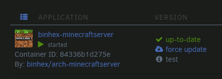

are you clicking on 'force update' link? screenshot:-
Yes, I am indeed. I also tried removing it completely and reinstalling but that also did not change anything. Is there a tag you need to move or something in order for the latest change to get pulled? (I'm just guessing here, although I do work with software development I have never done any work with github or creating dockers).

'/usr/lib/jvm/java-8-openjdk/jre' is not a valid Java environment path
Q. What does it mean and how can i fix it?
A. See Q10 from the following link for the solution:- https://github.com/binhex/documentation/blob/master/docker/faq/general.md

Thanks, that is working for me. The force update was not.
