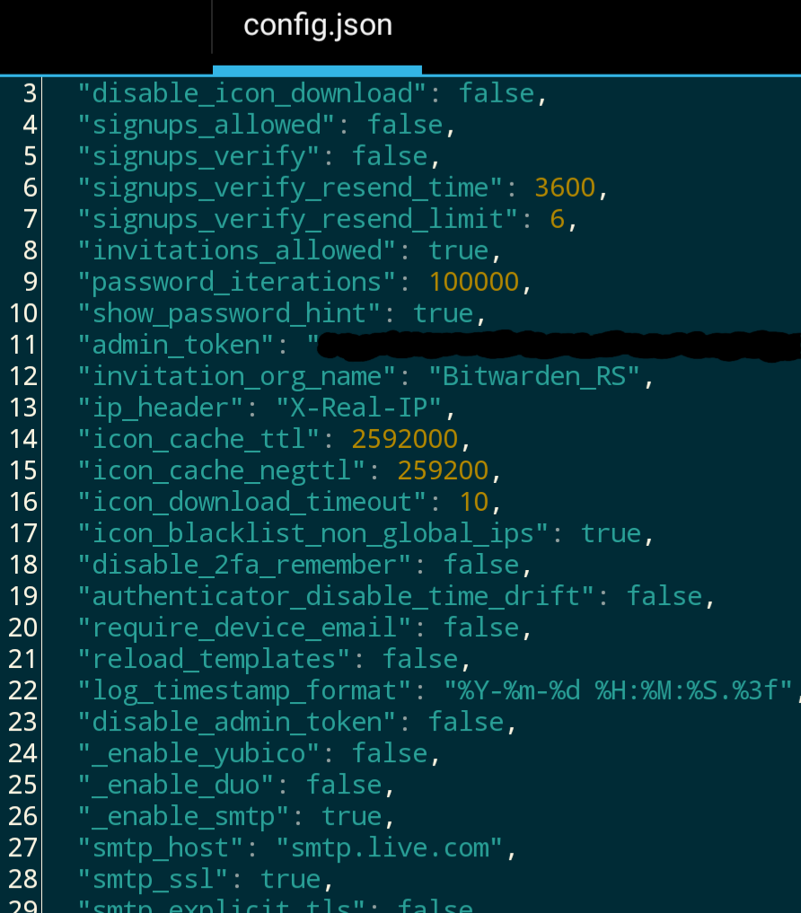

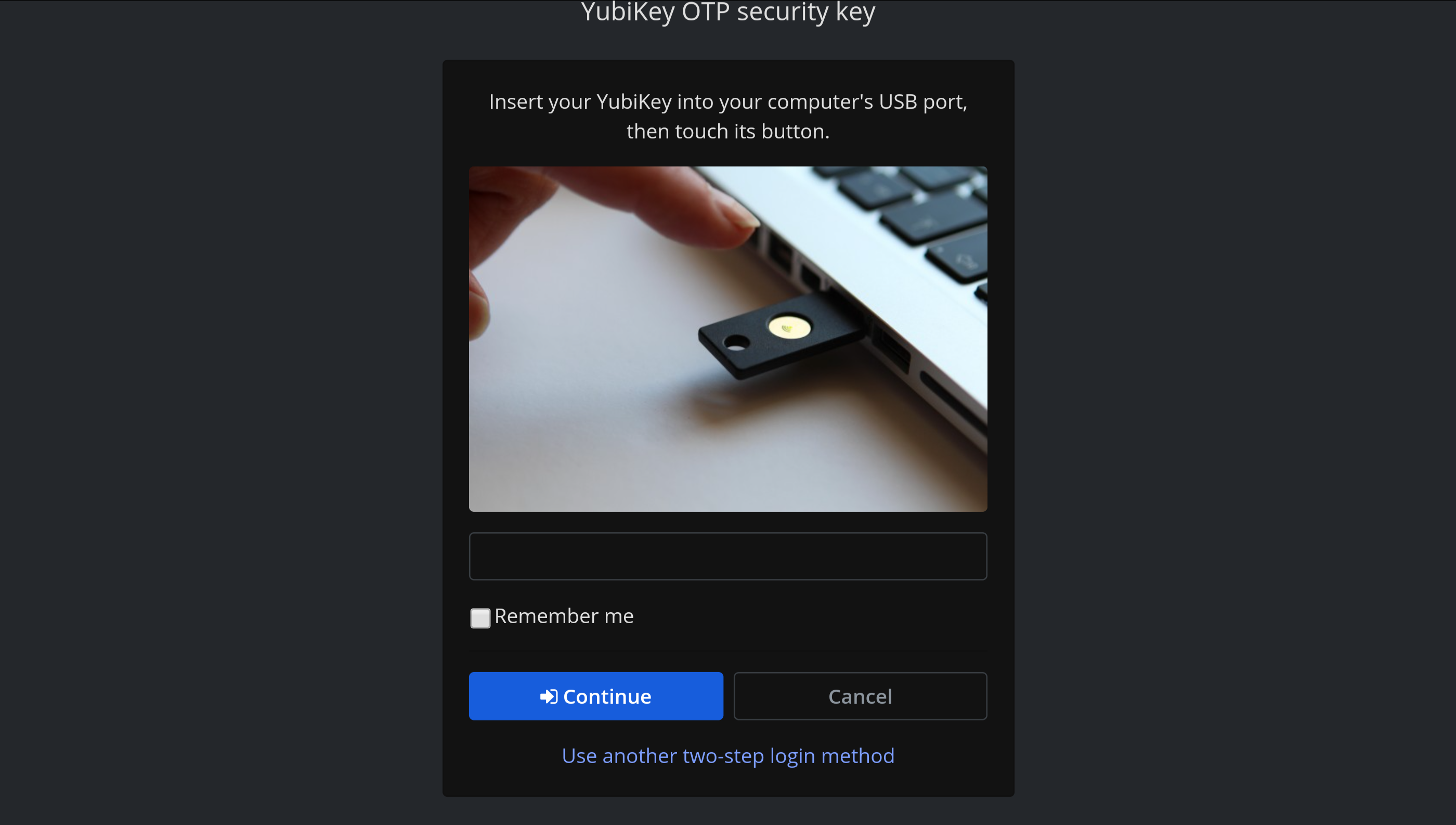

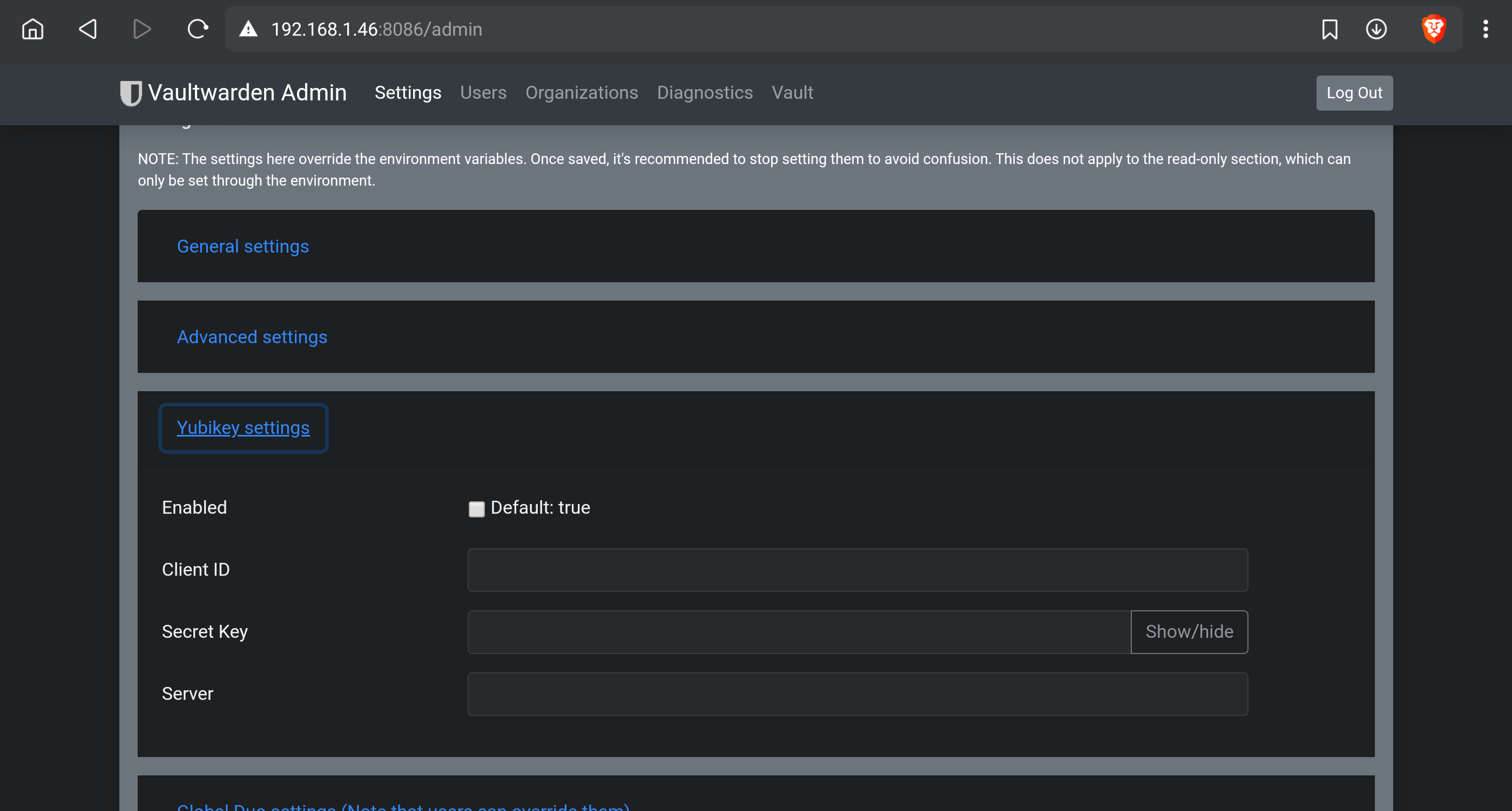

I've decided to remove the requirement for my YubiKey when I access my instance. I have removed the YUBICO_CLIENT_ID: & YUBICO_SECRET_KEY: lines from the template and also disabled the option on the admin page. I have cleared the browser cache and even tried another browser however I keep being asked for the key. The option is also disabled in the config file.
1494230576_Screenshot_20210515-093311_DroidEditFree.thumb.png.9675296e9f8cd33f0e54f35e395e9a7d.png
Edited by LoneTraveler
Hmm, the only option I can think of that's left is to restart the container and go through the config file again.

Restarted the container and system however no luck, I've even gone back over my config file but it still keeps asking for my YubiKey.
  "domain": "https://REDACTED",
  "disable_icon_download": false,
  "signups_allowed": false,
  "signups_verify": false,
  "signups_verify_resend_time": 3600,
  "signups_verify_resend_limit": 6,
  "invitations_allowed": true,
  "password_iterations": 100000,
  "show_password_hint": true,
  "admin_token": "REDACTED",
  "invitation_org_name": "Bitwarden_RS",
  "ip_header": "X-Real-IP",
  "icon_cache_ttl": 2592000,
  "icon_cache_negttl": 259200,
  "icon_download_timeout": 10,
  "icon_blacklist_non_global_ips": true,
  "disable_2fa_remember": false,
  "authenticator_disable_time_drift": false,
  "require_device_email": false,
  "reload_templates": false,
  "log_timestamp_format": "%Y-%m-%d %H:%M:%S.%3f",
  "disable_admin_token": false,
  "_enable_yubico": false,
  "_enable_duo": false,
  "_enable_smtp": true,
  "smtp_host": "smtp.live.com",
  "smtp_ssl": true,
  "smtp_explicit_tls": false,
  "smtp_port": 587,
  "smtp_from": "REDACTED",
  "smtp_from_name": "Bitwarden_RS",
  "smtp_username": "REDACTED",
  "smtp_password": "REDACTED",
  "smtp_timeout": 15,
  "smtp_debug": false,
  "smtp_accept_invalid_certs": false,
  "smtp_accept_invalid_hostnames": false,
  "_enable_email_2fa": false,
  "email_token_size": 6,
  "email_expiration_time": 600,
  "email_attempts_limit": 3
Sorry, I'm afraid I'm out of ideas what could be wrong here. It's strange thought, maybe someone with similar issues might provide further assistance. I'm using simple 2FA by Google Authenticator on my mobile phone.
