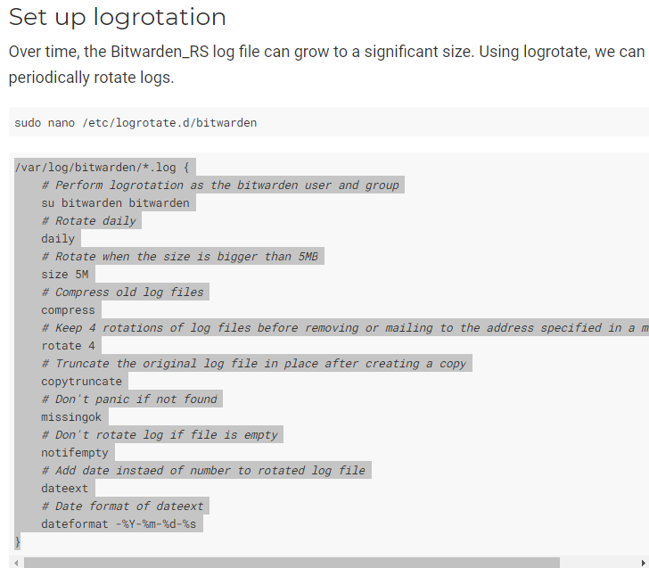

Another question....  I am wondering how I would go about creating a Docker Log rotation for the bitwarden.log used in the fail2ban setup
I have found this attached at the pieter hollander site  but am not sure where I would use such a thing within unraid.... or if it is even needed.
