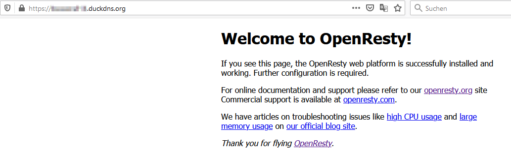

Hello, i had Bitwardenrs installed and worked fine.
Now I switched to Vaultwarden as described and now have a problem after restarting the server.
Accessing Vaultwarden via duckdns.org, this page comes up:
The /admin page works.
I've tried everything possible all day, including reinstalling Nginx Proxy and Vaultwarden. Unfortunately nothing works. Other Dockers can be reached via the Nginx proxy. I can't find anything where Vaultwarden pulls this page from. Maybe you can give me a tip.
Best regards
Averall
Best regards
Averall
This has something to do with Nginx Proxy. You should take a look at your Nginx settings and config files. Not many people are using Nginx Proxy, usually Swag or Nginx Proxy Manager. I use the latter and didn't have to change or add anything to my proxy configuration. Maybe someone could provide you with some assistance who is actually using Nginx Proxy.

sorry i wrote that wrong.
i am using the Nginx Proxy Manager.
Nginx Proxy Manager works with the other Dockers.
When I click the Vaultwarden WebGUI:
nothing happens.
Edited by Averall
That's strange. Check the network type in docker settings. Did you follow the procedure with all the steps. Did you change anything? WebUI should take you to the internal (LAN) Bitwarden login page. Since your picture above shows access to Bitwarden through the internet I still think there is an issue in Nginx Proxy Manager (check *.conf file and ip range)
Hello again,
After trying everything possible, I opened Vaultwarden with a different browser. Great, it works with that.
I have now emptied the browser cache of my Firefox and now it works again.
Small cause, big effect.
Thank you for your support.
