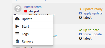

Okay, so I was checking out my docker containers and saw there was an update for my bitwarden_rs container. Tried to update it and got the message that basically told me something was wrong/usually a repository change.
Here's where I am now stuck. The instructions to upgrade said to stop the container, edit the repository, fix common problems, etc. Except I can't edit the container to update the repo. My guess is I need to basically start fresh. How can I do that without losing all my passwords?
OK, try to left click on the name of the container, not the icon. That should show you the template and try to change the repository there.
The name isn't clickable. Like if I go to the container above it, it will underline it showing it's a link and I can do that. Can't do that with the bitwarden one for some reason.
Hmm, can you access the log files. Post them here if you can.
I'm at work right now so unfortunately I won't be able to get to that till tonight. Do you want a screenshot of the left-click Show Logs or is there a particular log file you want me to upload? I can do either tonight.
No worries, upload logs (left clink on bitwardenrs icon>>logs>>copy and paste here), maybe something is there that could help us solve this. In worst case scenario, you'll make a backup of your passwords, delete current container and make a new one and then just import your passwords.
