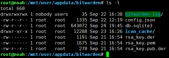

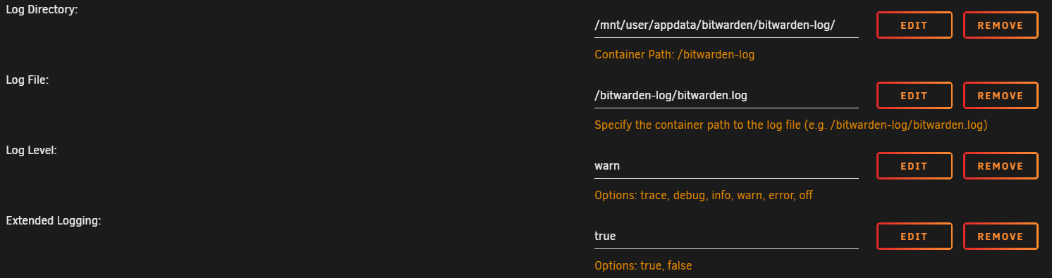

10 hours ago, poeterdebier said:
He, Guys,
was wondering if somebody could help me getting Fail2Ban working.
Don't forget you need to map that same directory where your bitwarden log file is into your swag container. Then also make sure the path in the bitwarden_rs.conf file for fail2ban has the same "container" path.
This is mine for example:
Bitwarden (I manually created the dir and made it nobody:users 777 since bitwarden seems to be running/setting root for all 🙂 )
Swag:
Swag fail2ban / filter.d / bitwarden_rs.conf file:
# https://github.com/dani-garcia/bitwarden_rs/wiki/Fail2Ban-Setup
#   - Set up logging to file > https://github.com/dani-garcia/bitwarden_rs/wiki/Logging
#   - Set logging level to warn or error
# Logged in /bitwarden-log/bitwarden.log
[Definition]
failregex = Username or password is incorrect\. Try again\. IP: <HOST>\. Username: .*\.$
ignoreregex =
Swag / fail2ban / jail.local file entry:
[bitwarden_rs]
enabled  = true
port     = http,https
filter   = bitwarden_rs
logpath  = /bitwarden-log/bitwarden.log
bantime  = 3600
findtime = 3600
maxretry = 3
Edited by cybrnook

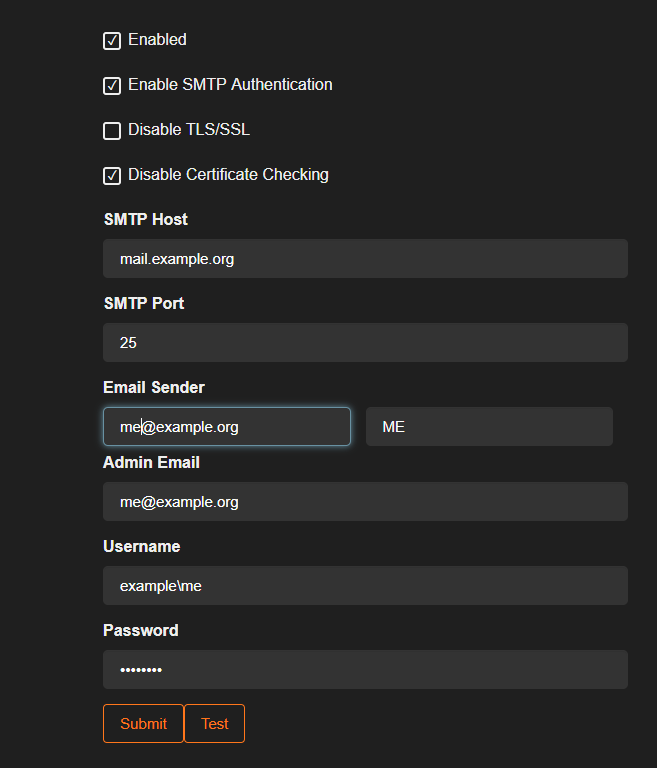

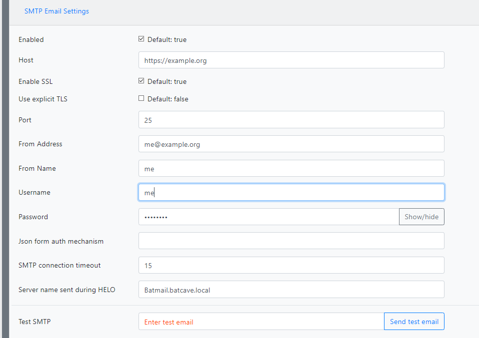

Hey, I know this is a pretty niche problem, but I have my own local exchange server for mail and I can't for the life of me figure out why SMTP isn't working....
I have the receive connector relay setup up, and works totally fine with Ombi, whenever I try to send a test in the Admin panel I just get SMTP error, which isn't hugely helpful...
Here's an example of the settings, I've obviously modified for privacy, but the address/usernames are all actually correct. There's really not a lot to go on, so I'm just wondering if anyone has managed to get this working and has any tips?
image.png.e0252ab38746a6317196d4f0eea573be.pngimage.thumb.png.71d9a2f216876e03b71b0abf6cbda5c1.png
