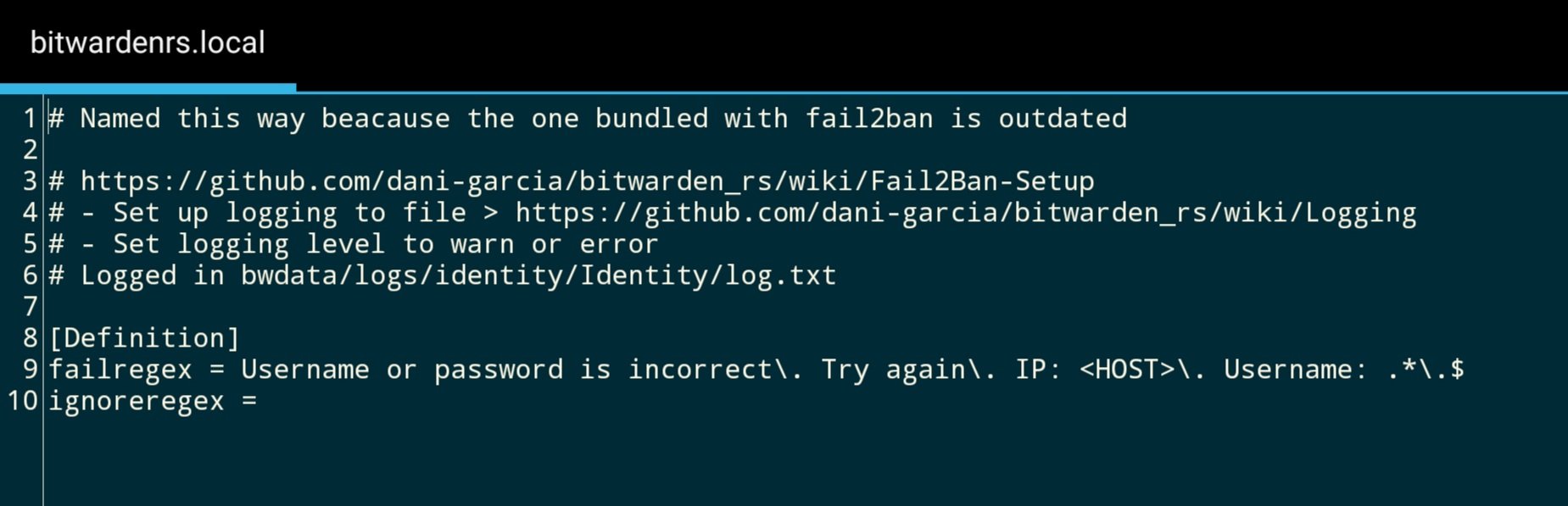

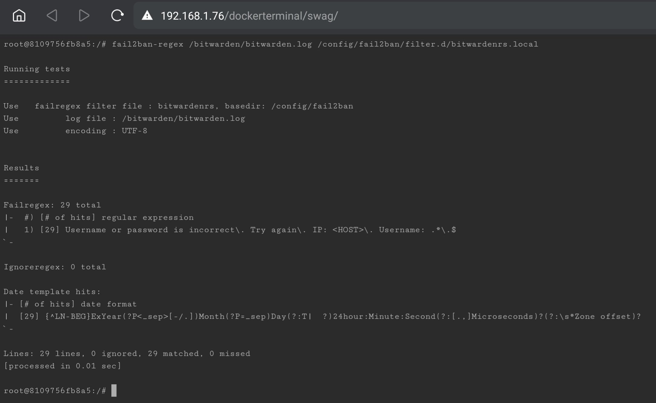

I'm hoping someone could give me some specific advice regarding Bitwarden and Fail2ban?
I've spent over a week getting SWAG & Fail2ban setup, and the nice folks over on the SWAG thread have helped me out a great deal. My problem now however is bitwarden specific.
I have added the extra parameters; "-e LOG_FILE=/data/bitwarden.log -e LOG_LEVEL=warn -e EXTENDED_LOGGING=true" to the bitwarden container and mapped SWAG to the newly created bitwarden log file. I have updated both "bitwarden.subdomain.conf" and "jail.local" however if I access my bitwarden page remotely and make several invalid login attempts, nothing happens, I'm allowed to keep continuing.
Looking in the bitwarden log, it correctly lists all the login attempts. Looking in the fail2ban log however and there does not appear to be any mention of the login attempts.
Since setting up SWAG and Fail2ban, this is the first program I've tried linking and so I've got no other to compare with.
I have included below cut and pastes of the two mentioned files above along with my bitwarden.subdomain.conf in the hopes that someone can help.
Many thanks.

1 minute ago, LoneTraveler said:
Fail2ban setup
The bitwarden filter that comes with fail2ban is not for bitwarden_rs. You need to create a new file, and use the correct failregex. This is the filter I use. As noted you have to call it something else than bitwarden.conf, i called it bitwarden_rs.conf
Wow, that was a quick reply, thanks.
I've updated my bitwardenrs.local file as imaged below, using the template you provided, however after restarting Fail2ban I am unfortunately still able to make repeated login attempts.
1 minute ago, Roxedus said:
What does your jail look like?
jail.local

filter = bitwardenrs
action = iptables-allports[name=bitwardenrs]
logpath = /bitwarden/bitwarden.log
maxretry = 3
bantime = 14400
findtime = 14400

Test the failregex on the command line
fail2ban-regex /bitwarden/bitwarden.log /config/fail2ban/filter.d/bitwardenrs.local
That command returns;
So the regex is working, the only thing is that f2b doesn't start
