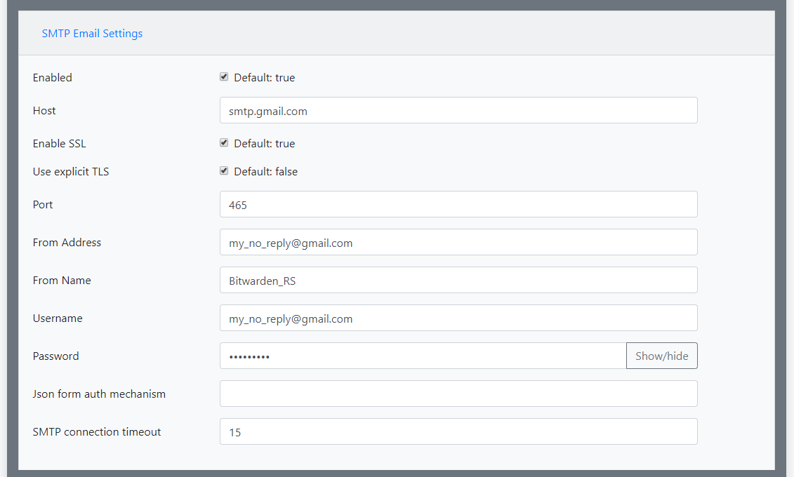

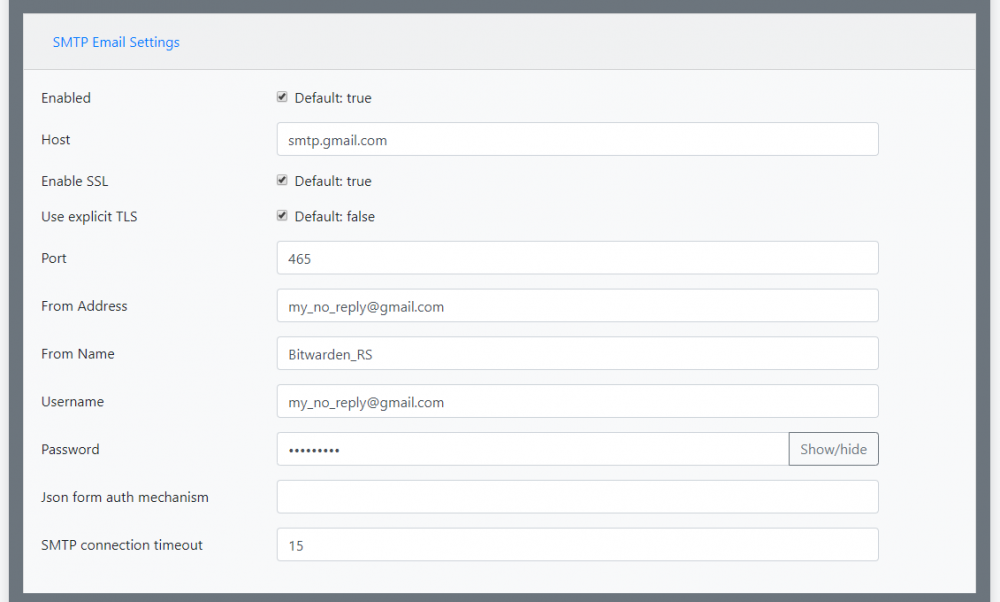

@Gabriel_B I just managed to setup smtp with a gmail account.
This account is set to allow insecure connections
I used the settings showed in the screenshot, but with my emailimage.thumb.png.90645418593e57b26d3106b1f9206a64.png
Thanks for your help.
It keeps saying "Username and Password not accepted. Learn more at..." While I copy paste everything. Enable less secure apps is on...
When I try to login (gmail web) it says account not found. But when I do it on firefox it lets me right in ?!
Have the gmail address working in Thunderbird, send and recieve.
EDIT: Using my main gmail account now and it sends. Why the new gmail account I just set up yesterday won't do this is a mystery.

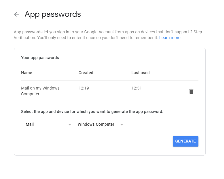

Did you go to your google account and created a new App password? If you you 2-step verification then this is the way to get bitwarden to log in to your gmail account.
https://myaccount.google.com/apppasswords
Edited by bulletjie
No did not set-up 2 factor auth. Done and over with now, tired of trying. It's working now. Thanks again for your help, eventually it all worked out :)

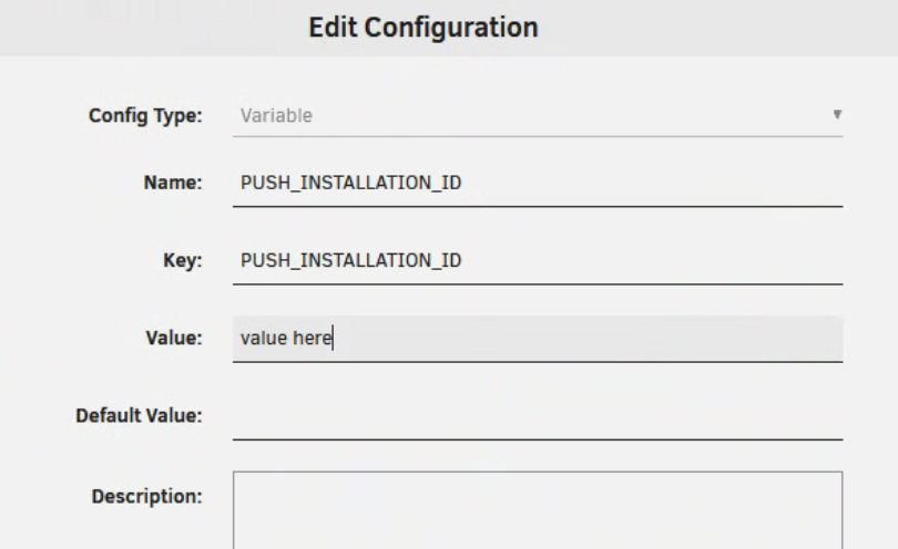

it comes back when a user deletes a variable.
Ah.  Feature of unRaid itself.  Any update to the container will also bring in any missing ports / variables etc under the assumption that the update brings new features that might require that.
I'd recommend that the container is set up to ignore variables that aren't actually filled out.
Alternatively, you can disable that feature completely by editing the template within /config/plugins/dockerMan/templates-user and removing the <TemplateURL> entry.  (Although at that point FCP will complain, but that can be ignored)
Over the years, the updating of the template has proved to be useful as the apps themselves evolve, (ie: webUI entry changes), but it's never going to be a perfect system.
Because of the maintainers who did fill out that entry in the first place did it wrong (fully 50% of them), CA's appfeed now handles it and there is no more access to that entry in the webUI anymore.
Interesting. Would be nice to be able to specify if a variable would be synced like that.
I agree, and this one doesn't. I have made a request for allowing it to be empty, but i don't see it going into fruition.
So you think it would be useful to have something like a "noUpdate" attribute on the applicable <Config> entry so that the system when it updates will ignore that element and not add it in again... @binhex?
Exactly. There is multiple scenarios i can see where it would be handy. Like linuxservers mariadb which only uses some variables at first run.
OK.  So how would this scenario work:
  • User installs template X
  • Sets it up and deletes the applicable config
  • Updates happen and that entry never gets repopulated into the user template
  • Buddy decides for whatever reason to start over again from scratch with their appdata.
  • Deletes the applicable appdata folder, uninstalls the app, then reinstalls from previous apps.
Now that particular variable is missing from the template, and the container won't install properly
It's basically nothing (1 line of code) to have docker updates ignore a config update if an attribute is present.  But I can foresee situations like the above happening.  I think what I'll do instead is allow on the template instead a flag to have the appFeed skip populating the TemplateURL which will also fix the problem (but has other caveats), but is probably easier to deal with in the long term.
