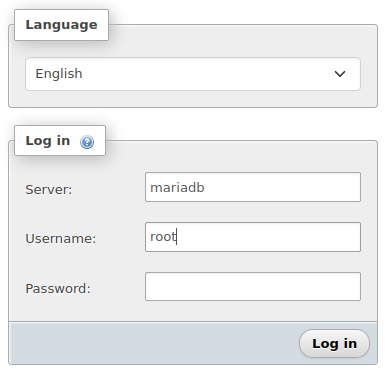

* created a new docker network (docker network create web) - could be docker create network web (can't remember)
* installed phpmyadmin from linuxserver (networktype: web) -> make sure PMA_ARBITRARY is set to 1
* installed mariadb from linuxserver (networktype: web)
* with phpmyadmin 1) create the wordpress database with user/password and 2) then import your wordpress sql backup. Name of the server is the name of the mariadb container - default is "mariadb" - because both are in "web" they should see each other by hostname - if you go to phpmyadmin console you should be able to ping mariadb
* install wordpress container (networktype: web) if the import of you wordpress backup went well you can just fill in the server, database, user and password.
* if you have an existing wordpress install scp the wp-content of the site to the new site (and do a chown sshd:sshd -R ./wp-content after because after the scp action it like owned by root (my actions at least did that)
* when that is done - all urls in your post are probably wrong. You can fix them with
* when you are done stop the phpmyadmin container - Only start it when you actually need it. It's a very powerful but also very destructive tool.

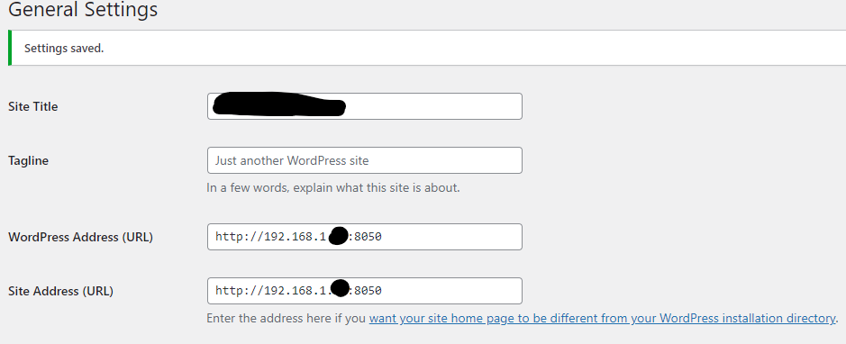

Edit:
I can confirm that "hard-coding" the web-address works (as expected):
It might be a bit out of scope to explain how to set this up, but is wordpress is suppose to be accessible from the outside. Couple of steps are necessary:

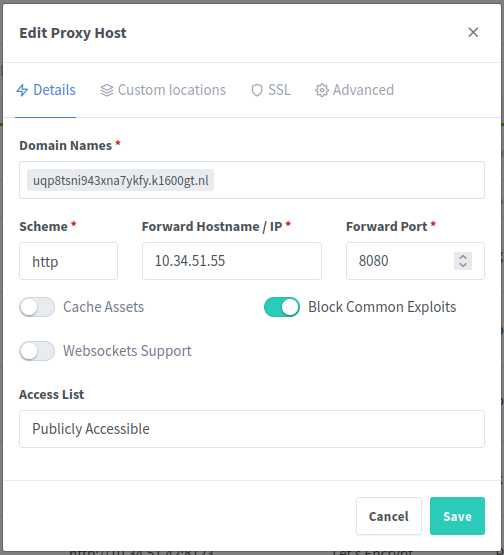

  • Add a new CNAME to your domain. This might take a while for it to work - depending where the domain is registered.

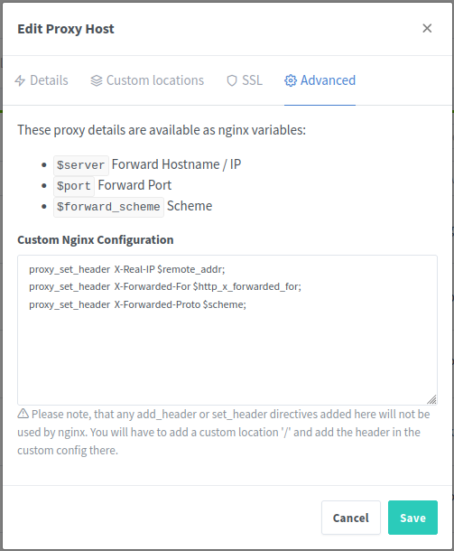

  • Setup the nginx reverse proxy manager (add a proxy-host) to point to the external side of the docker. In my case that's 10.34.51.55:8080. This address:port directs to the wordpress container. Also add the following lines to the nginx custom configuration for the proxy
    proxy_set_header  X-Real-IP $remote_addr;
    proxy_set_header  X-Forwarded-For $http_x_forwarded_for;
    proxy_set_header  X-Forwarded-Proto $scheme;
  • Replace the WordPress- and Site Address to the new address (http since https is not configured yet)
  • At this point you could replace the WebUI url with the new http address so you can check if it works

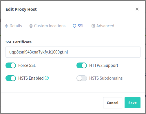

  • When you can reach the http address just fine, you can configure nginx to add a let's encrypt certificate. Quite easy: Go to the proxy-host in nginx, selected the SSL tab and request a new one for the url. Check "Force SSL", "HTTP/2 support" and "HSTS enabled". You also might want the check "Block common exploits" on the first tab. The request takes a couple of seconds. Important is that let's encrypt can reach the site from the outside though port 80.
  • When this is done you need to update the WebUI url and the two url's in WordPress to https.
  • When you can reach the site though https, you need to replacement the url's that are everywhere in your posts, links etc. I used blue velvet url replacement plugin. I might be possible to you have added (or the theme editor) urls into sections the plugin does not or can not look - to make sure everything is coming from the url you can use the network inspector of the browser (usual F12 brings up developer stuff)

Pictures say more than 1000 words so here they are:

Did you configure something in wordpress in the interface or a configuration file somewhere?
for example in this screen ?

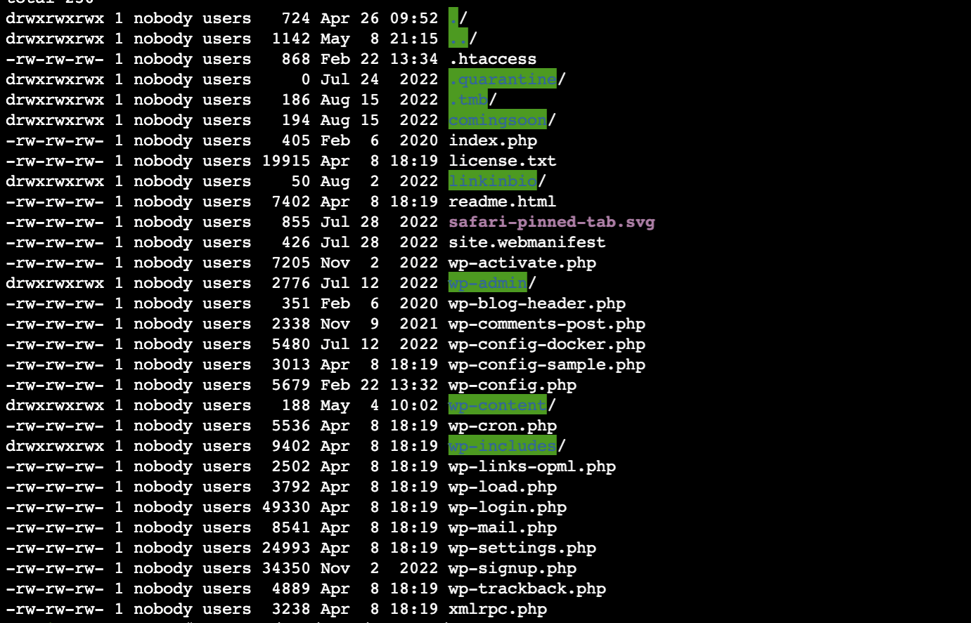

WordPress recently wants an FTP access to update plugins and themes, I'm thinking somehow it lost permissions to write to the necessary directories.
ls -la /path/to/wordpress
986142108_Screenshot2023-05-08at9_26_47PM.thumb.png.64e2eb3a420692e7069c504f0175dea7.png
any advise on restoring permission to default? i'm thinking something like;
sudo chown -R nobody:nobody /mnt/user/appdata/wordpress
sudo find /mnt/user/appdata/wordpress -type d -exec chmod 755 {} \;
sudo find /mnt/user/appdata/wordpress -type f -exec chmod 644 {} \;
send help @Kru-x
send help @Kru-x

never that simple, site shows directories are writable?
POSSIBLE FIX:
changing/correct the ownership and permissions, this did not fix my issue. BUT if you have jacked up your permissions this will get you back to 'stock'. Running, and testing permissions fix did not solve my issues.
THE FIX:
Adding the following lines to the "wp-config.php" file in the WordPress installation directory:
define('FS_METHOD', 'direct');
define('FS_CHMOD_DIR', 0777);
define('FS_CHMOD_FILE', 0777);
This will force WordPress to use the "direct" method for updating plugins and themes, and set the directory and file permissions to 0777, which allows all users to read, write, and execute the files and directories.
After adding code to my wp-config.php and re-testing solved my issue.
Edited by Tolete
THE FIX:
had a similar issue with my wordpress setup and I have followed the steps and it was still "not-writable"
turns out I had to go to the container's console window and reassign the "www-data" user back, because for some reason it has changed to root and 99.
afterwards I added your wp-config lines and Voila! everything is back to work as intended.
thanks!
