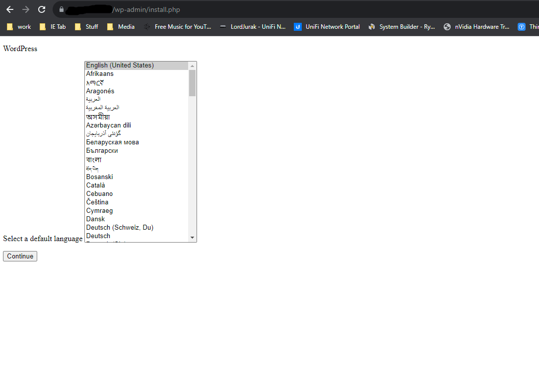

Need some help. Setting up wordpress. I have cloudflare tunnel set up and have set up my public hostname and have it pointed to the IP:port of wordpress. Install Wordpress then go to my domain.com and get this below.
The page is not loading correctly. The next page is also not loading correctly. I does let me continue but once im done and click install it shows the same incorrectly loaded page but says success! Then I click login the url in the browser changes to my internal IP address and then says this site cant provide a secure connection. When I go to my URL it does show the initial hello world welcome to wordpress page. But am unable to access the dashboard.
Hi Jurak,
Im not familiar with cloudflare but it seems to me that you have a redirect problem. Have you emtied the cache or tried in a incognito tab? What proxy are u using?
Kru-x
3 hours ago, Kru-x said:
Hi Jurak,
Kru-x
The current set up I have was working till my cache drive failed and found out my backups were corrupted so was not able to restore everything I already had set up. Resetting up everything and getting the issue I have now.
This issue of the URL changing to my internal IP for the docker is happening on all browsers incognito or not. Also for the Proxy Cloudflare is handling all of that.
https://developers.cloudflare.com/cloudflare-one/connections/connect-networks/get-started/
The above URL goes over Cloudflare tunnels. Once set up it will give you a secure connection from Cloudflare to your server. Through the tunnel and the docker container you install on your server, you can set up public host names with the domain I own and it will direct traffic to the program/docker i have set up for each sub.domain.com/ domain.com.
I have used this set up before but don't know what is wrong this time to give me the issues I'm getting now.

Ok figured out my issue. I have been on a business trip the past few weeks and got home and decided to work on this. Well internet had gone down while I was gone and my wife delt with the ISP to get it fixed. I just found out that they had replaced the modem/gateway with a new one. The new one was set up as a gateway and not in bridged mode. Once I set the modem to bridged mode everything started working correctly.
If you are using a Cloudflare tunnel, it shouldn't matter if the modem was in bridge mode. Cloudflare tunnels are initiated from within your internal network. But, if you are forwarding ports, then bridge mode does matter.
The only change I made was putting the modem into bridged mode and everything for wordpress started working correctly. I do have ports forwarded for plex and my game servers, so needed to fix that anyway.
