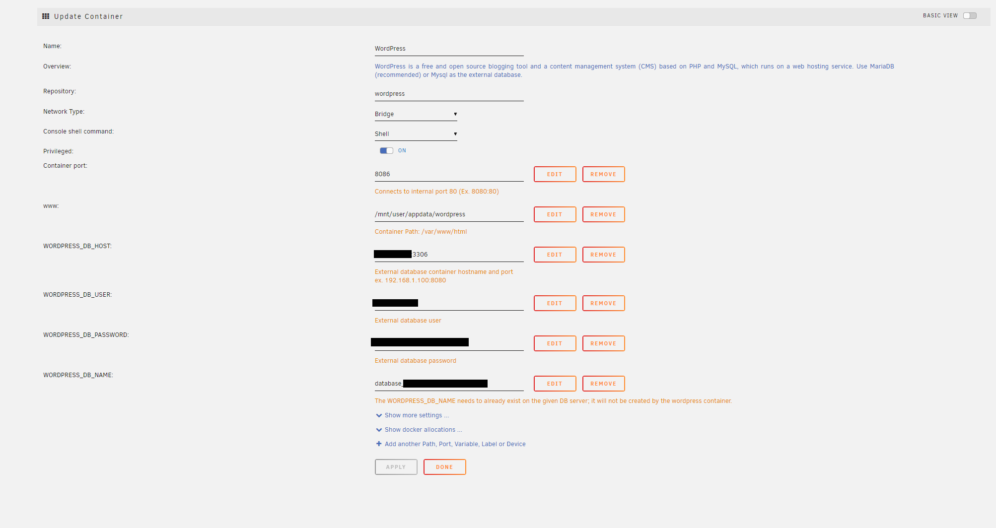

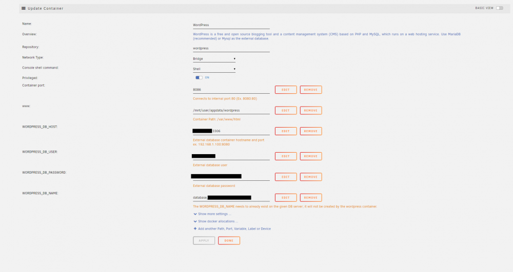

Hello, Im trying to use this for a private web server for my own uses within my LAN network. No outside www. needed. will be accessed by IP and Port when needed.
I installed MariaDB, and went through the steps in the french walkthrough posted earlier.
I also have a Unifi docker running (relevance next)
After installing the wordpress docker, the webGUI takes me to the Unifi webGUI, easy enough, Unifi uses port 8080, change the port for wordpress.......
I changed the Wordpress port to 8085, and when i manually navigate a web broswer to ip:8085, it cannot connect. I tried a few different ports from 8081-8090.
Any tips?
My setup is here:

Reinstall from the beginning on the new port and/or change the site adress to ip:port-number

Hello, tried reinstalling, Still no luck.
Trying to install and use on vlan network. Installation completes but all i get is "refused to connect".
I CAN ping the address however.
Is there anything special about the network that needs to be set up to use on a vlan? How would i change the site address to IP:Port-number? Do you mean in the network field? OR in the configuration somehow?
