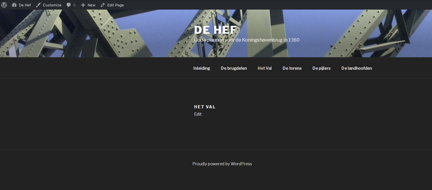

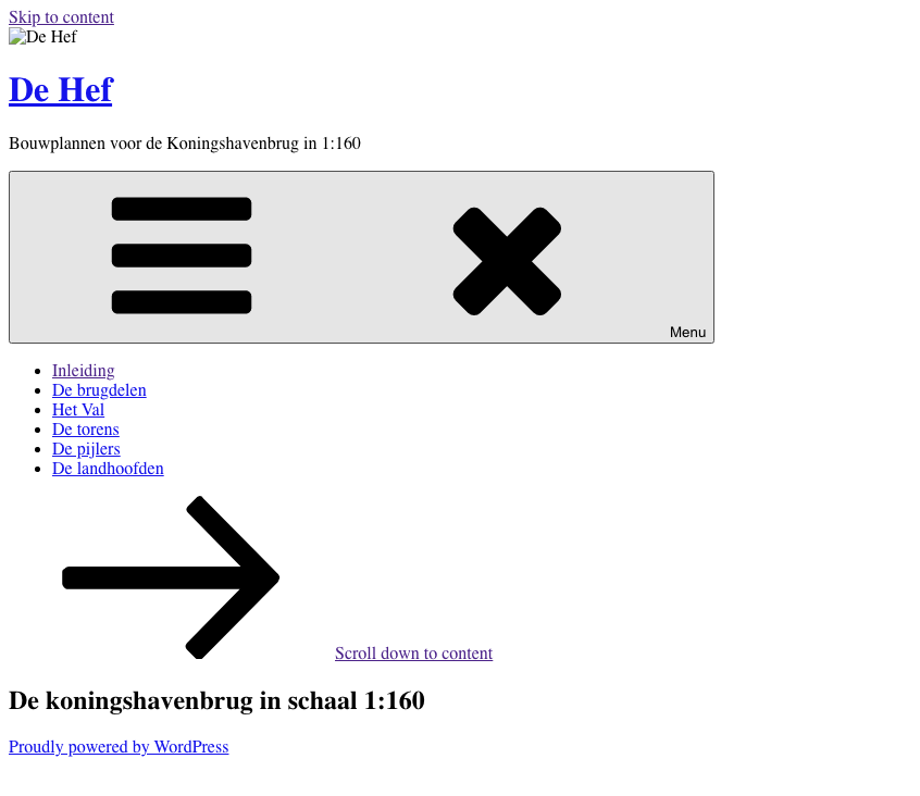

Another issue. I'm using nginx proxy manager to redirect my domain to the unraid internal ip, works on some mobile devices, but on my mac i get this website rendered... no pictures, no styles, just large icons. The site works fine on my ipad. Have cleared cache, did not help. Any ideas?
It should look like this: (also works ok directly from unraid's webui button)
Did you install WP on your domain name, or local IP?
On my local ip, and used nginx proxy manager to redirect my domain name to it.
That’s probably your issues, its the redirects I’ve been talking about. WP stores most in the db, so if you installed it on your ip, it is trying to redirect to 198.168.1.1/yourpage. Easiest is to sort out you domain first and the start the installation from there. Read previous post in this thread, it explains it well.
kru-x
Thanks, will read the thread from the start and try again :)
