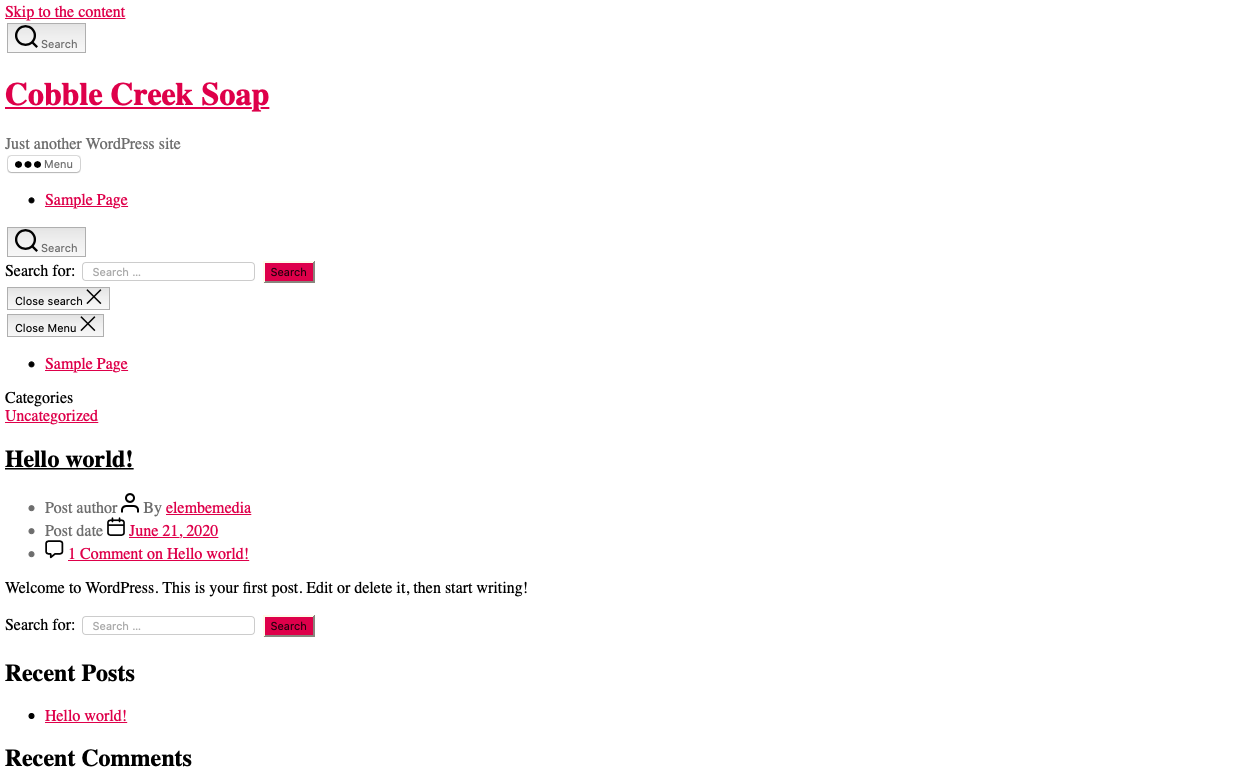

Hey guys,
I've got MariaDB, Wordpress, and NPM all setup and working except when I load the page it looks like this. What am I doing wrong?
829738167_ScreenShot2020-06-20at6_01_52PM.thumb.png.d5d7b7d675c81ef56b0aa620a4d1b315.png
7 hours ago, Elembemedia said:
Hey guys,
Did you do a fresh install from your home local address or from you domain address? it’s your permalink that is wrong I guess. If you can, login to wp-admin.php go to settings and permalinks and update them.
Edited: if you have not done anything before you read this, it’s your cookies in your browser. I can see your page properly,
