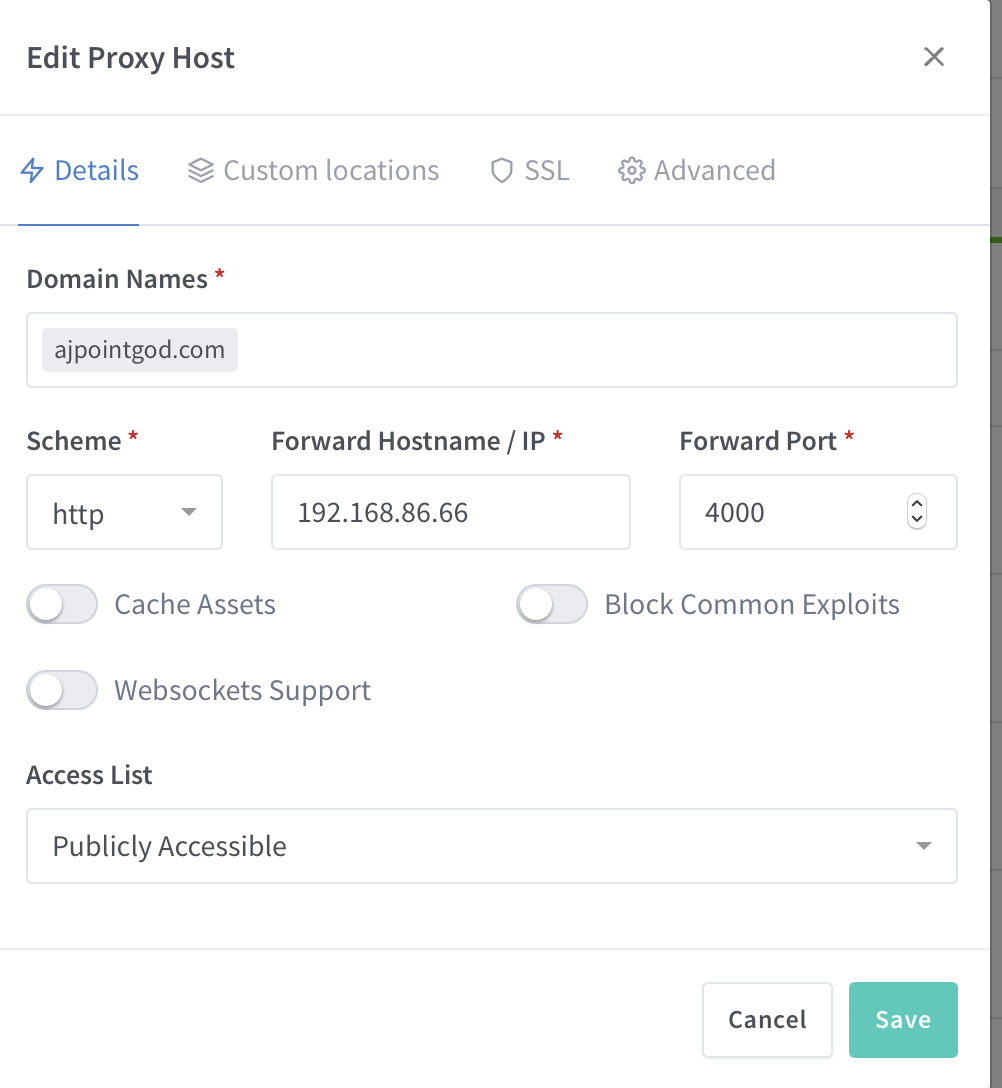

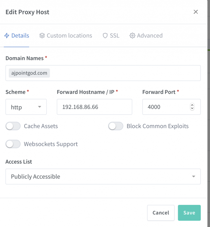

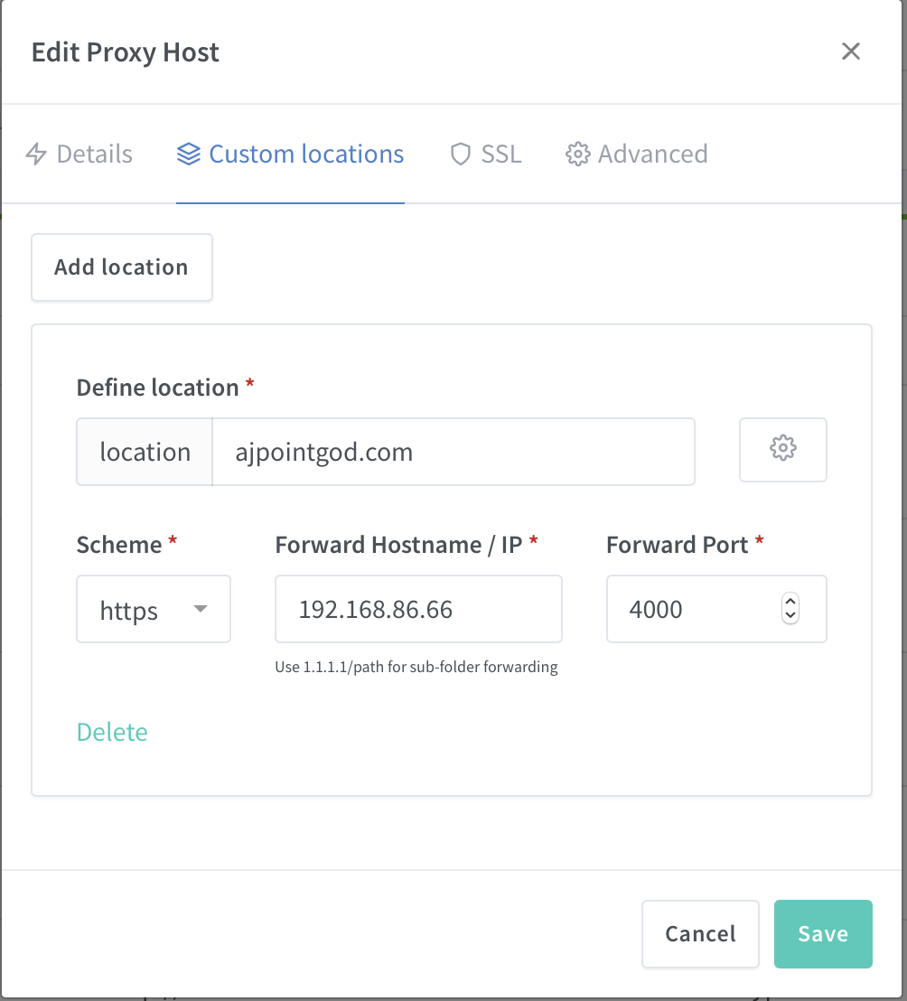

Hey all. I'm pretty pumped about being able to run my own websites off of my Unraid server. What started off as a Plex server has blossomed. :)
So I've tried several things to be able to host my own sites. Everything seemed so complicated until I stumbled on this thread and NginxProxyManager was suggested.  Very easy to use, except I'm not able to access my website. I'm just curious if someone could help me answer some questions where guides/videos were not able to.
Should Wordpress docker be run in host, bridge or custom? I created a custom 'proxynet' while following a spaceinvader guide for LetsEncrypt before going the NPM route.
Here is what the docker page shows for port mappings (app to host)
172.18.0.3:80/TCP<>192.168.86.66:4000
Here is what I have set up on NPM
765010974_ScreenShot2020-09-21at1_20_59PM.thumb.png.f07bbdb7864597cc72571e3f8860fec5.png
394466682_ScreenShot2020-09-21at1_20_50PM.thumb.png.0560b612c64b93a525e73ebff2b22309.png
If I type in http://192.168.86.66:4000 into the browser I can get in. If I type ajpointgod.com it does not. It gives me the Congratulations screen for NPM. What am I missing?
Edited by dancue

HI dancue,
Personally I run all my containers in Bridged mode, but I know many is using Spaceinvaders guide and are using a "proxynet" that creates a separate "internal" network. Many swear by it and I have read that it might be better for a proxy routing traffic.
Having said that, only ones I have had the need to use a specific separate network and even then later on I switched back to bridge mode again and got it working. For me it is just easier to use one network as I know exactly what the different IPaddresses are on each box (i got two servers).
You don't need to add a "custom location" as per your screen shots otherwise it looks right and as for your setup, I guess you installed WordPress from your internal ip address and not on your Domain name, eg remove both the WP and MariaDB's folders and add the two containers again, then check if you can see WP's installation page on your local address but without starting the install, then try to connect to it from your domain name and do the install from there.
Hope it helps,
Kru-x
