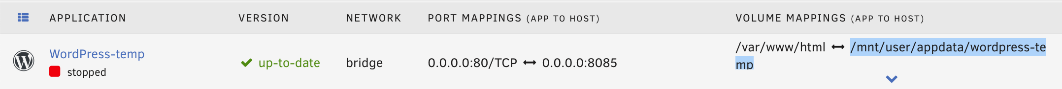

Each container and the folder for that container in app data, depending on how you named them, marked in blue! Eg. both WordPress and the WordPress mariaDB.
Edited by Kru-x
Ok so i deleted both MariaDB and Wordpress. I also deleted the SSL in Proxymanager and did a new one. However, when i go to my domain in Proxymanager, it takes me to port 8080 and not 8085.
