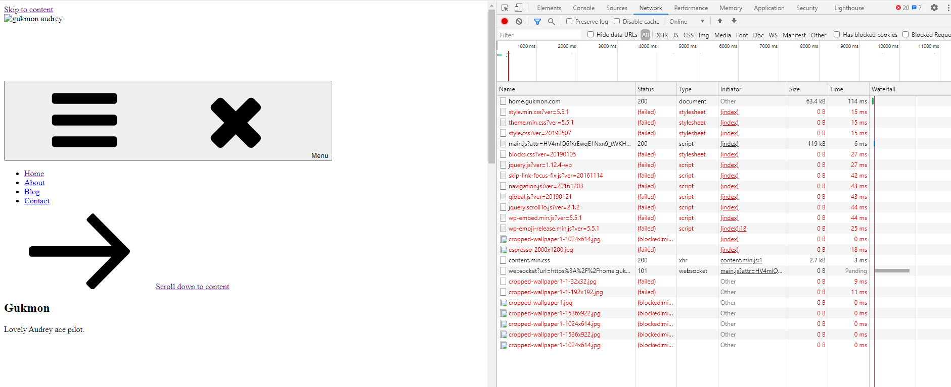

I worked for a several days to try to get wordpress work with letsencrypt(with nginx)..
the letsencrypt have already for my nextcloud docker(I can access my nextcloud with external network)
For wordpress I made progress today by using the wordpress.subdomain.conf suggested in this post
 https://forums.unraid.net/topic/89657-guidehow-to-make-your-own-streamingplatform-like-twitch-and-co-using-wordpress-mariadb-letsencryptnginx-rmtp-by-alfg/?tab=comments#comment-831787&searchlight=1
I thank god that finally its not giving me something like bad request in the browser.
however, I only got the text working in the browser, but all the theme and css seems not working. Please help.. (This is fine if I access through internal ip:port)
The behaviour is very strange
1)desktop browser(domain)
I)outside local network: above result
2)inside local network: above result
2) desktop browser(ip)
no problem at all
3) mobile device browser
i) local network: can load picture, but still some css error
ii) outside local network: cannot load at all
no problem at all
Try to empty your browsers cache. But having said that (and read your message properly :-()) wonder. I never got the hang of letsencrypt/nginx settings , and it seems to be ask in that forum or to make life easy for you use the nginx manager as per previous posts. Then you don't have to worry about settings.
Kru-x
Edited by Kru-x
Added answer
Kru-x
thx bro
but i am not so sure, as I am already running letsencrypt and its version of nginx
If I install this nginx manager, am I required to remove the letsencrypt version of nginx?
or they coexist with each other? THen I have no idea how to set them up..
switched to nginx proxy manager, made nextcloud work again, but not wordpress...omg
